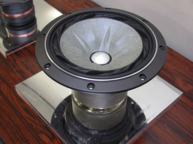

I've been doing that very thing for about 15 months now and would never, ever go back to using just a single "full-range" driver again. This path started for me almost 3 years ago now, when I had Jeff Carder of Cardersound build me custom pair of Sachiko double-back-loaded horns, which came with Fostex FE206E drivers installed originally. I was immediately struck by their dynamics, transient response, transparency, clarity, detail, inner resolution and correctness of harmonics, timbre & pitch! This is the sound I had been looking for all these many years.
However I soon became troubled by their problems, which all whizzered full-range drivers have and is usually summed up & refered to as the "Lowther Shout". I thought perhaps using a better quality full-range driver would ameliorate or eliminate these problems. So I tried a pair of Lowther DX3 drivers, but I didn't like their presentation and removed them within 30 mins. Next came Fostex FE206ES-R drivers. This was more like it, better treble & bass extention, plus improved clarity, detail & inner resolution compared to the FE206E drivers. However the "Lowther Shout" was still an issue, that I had addressed to great sucess by a wonderful cone/whizzer treatment. Still if I turned the speakers up to play a song loud like I do when listening to prog-rock, there was a very noticable, strain, distortion and break-up.
So eventually the FE206ES-R drivers where removed and replaced with Fostex's FE208ES-R whizzerless drivers. What an improvement. Everything I loved about the FE206E & FE206ES-R drivers was present, except now there was no "Lowther Shout"! There was however another problem. The freq response that was truely usable was limited to 80Hz to 10Khz max. These weren't full-range, these were extremely wide-range drivers. So I tried a couple of different tweeters, using 6dB, 12dB & 18dB slopes until a discovered using the incredible 16 ohm, alnico magnet, Pioneer HW-7 horn tweeters with 12dB slope @ 8KHz and above was the ticket for me. The combination of Sachiko/FE208ES-R/HW-7 is incredible. I can cleanly hit 110dB peaks without the slightest hint of strain or distortion. Playing music with 110dB peaks isn't something I do very often being a mainly smooth jazz/jazzy new age kind of guy, but it's nice to know that when I get the urge to listen to some prog-rock, I can do so and as loudly as I want or would ever care to!
Thanks to a couple a friends who have loaned me the following components, I've also began biamping the Sachiko/FE208ES-R/HW-7 by adding a pro-solid state amp powering a pair of Hawthorne Audio 15", OB, "Augies" that kick in at 100Hz and cover from 100Hz and below. After 44 years of being in this hobby, I can honestly say there's no commercial or DIY speaker I've heard, that I'd prefer over what I own now. IMHO using full range, whizzerless drivers with "helper sub woofers and tweeters" is the ONLY path to take when using dynamic drivers...

There has to be more to it than that, hasn't it? The shouting happens because the cone moves into breakup mode. I read in one of JBLs paper that even a 4" cone driver begins breaking up at around 600-800 Hz. Breakup means some parts of the cone start moving differently than the others. It doesn't move as a single entity. And these breakups happen all over the cone giving rise to different resonances. These resonances manifest themselves as peaks and dips in the FR and also have some stored energy.
I worry more about the stored energy part than the FR. You cannot clean up the stored energy by any type of EQ. These resonances will appear as a ridge on the CSD plot. A notch does help though.
I would take all these treatments for full range drivers with a pinch of salt. Whether they work or not is open to debate, but I wouldn't want to do anything to the delicate cones on these drivers. The lightness of these cones is key to being able to move fast and produce little nuances we love. By putting on some stuff on the cone, you definitely increase its weight and that's probably where the difference in performance comes from. Whether it is for the better or worse is up to the listener. I would much rather swap out one driver for another to hear a difference that bother with these treatments.

Whizzers have both advantages and disadvantages. I think fostex has at least two ways of getting that top end extension: whizzers and dust caps. I have a couple of fostex drivers with dust caps and they don't go past 10kHz. If you want that extension, you will have to live with whizzers. Crossing to a tweeter is an option, but the AN drivers go high enough that you can live without a tweeter. At least, I can.

Fostex FE208ES-R
