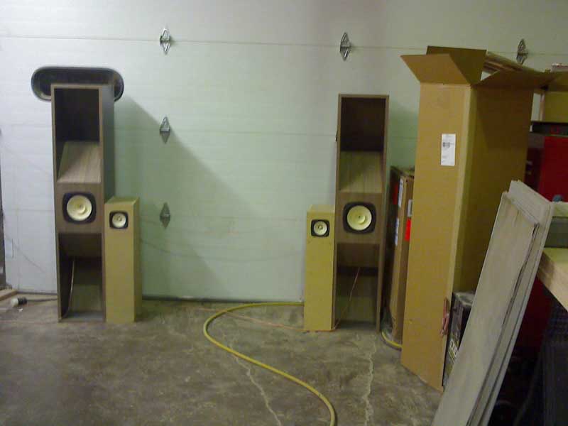

I just finished my surround sound speaker build
The movie explosions scared my wife off the couch and shook the house. My dog gets confused so it must be realistic--project complete. Now that my wife understands when I ask how big something can be--it means that is the minimum size! Banished to the garage!
