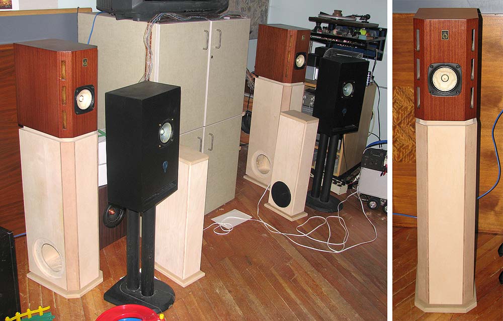

For the FE127E?
Why yes, I might just have a suggestion
Fonken + Fonken-woof (2 SDX7's per side)
The plans for the former are on the site, you'll need to contact Dave for the drawings for the latter. It was designed as a stand for the Fonkens, and has the same footprint.
100Hz works very well indeed for this combo- it just happened to be the turnover of an old active XO (Ace Audio) that was lying around. EL84 SE on the 127s and some generic SS workhorse on the bottom, fills a huge room quite easily.
shouldn't be long before Dave posts a photo of this pair

I.m listening to Fonkens biamped with FonkenWoofTL as we speak... next i'm probably going to try sealed.
Measures show the TL only gives a little more extension than the Fonkens by themselves but they sure do give a lot more weight and the mid/top gets better with the bottom-end relief on the 127
dave
