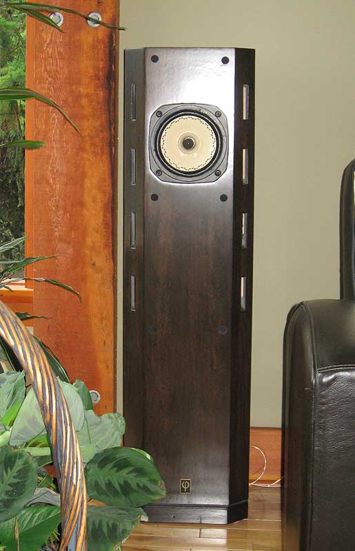

planet10 said:
When we introed the Fonken167 at this years diyFest, 2 different Bob Brines FT1600 (ML-TL) owners said it was the best they had heard the driver.
Yeah, critically damped speaker systems regardless of box alignment type is where it's at SQ-wise.
GM
chops said:
If the Fonken167 is that good, then I think I should build those. I desire the best I can possibly get my hands on within my budget.
not a project for a single afternoon, but definitely worth the effort
I imagine the Fonken167's were using your modified drivers?
yup
chops said:I was gonna check out the plans for the Fonken167 only to find out that the link is bad. Pooh.
Darn, i haven't fixed that link yet? I emailed you the plans earlier today.
They will only be available in detail for those that buy drivers or by donation (silimar program to Bob's). At the moment they are part of a beta program to get them into a condition that warants the (modest) tariff.

So does anyone have any listening impressions of these yet?
chops said:So does anyone have any listening impressions of these yet?
1 pair exists. They were a hit at their intro at this last summer's VI diyFest. Chris took them over to his sisters, and we were only able to extract them long enuff to veneer them... after vebeer and before delivery Chris set them up in his (wife's) TC room and the Milevas are going to get replaced. We'll also have to do another set for demos.
They get the mids almost as well as the smaller Fonkens, have better, deeper base, better dynamics, and play louder with the small amps we are so fond of.
Chris can chime in, except for his sister, he has had more time with them than anyone else, including in his man-cave which is much the same size as yours.
The bases are purposely mutable so that the height can be adjusted for needs (including short of stature for WAF)

Since the snow has prevented me from making that trek to the end of Mark Lane for the past 2 weeks, I'll have to rely the memory of my impressions from my last listening sessions.
The two specific driver/enclosure combinations (FE127 / FE167 & Fonken) are as closely optimized to the same goals as the driver's parameters allowed.
I have spent over a year and half listening to a series of FE127 Fonkens, with a variety of electronics and sources, and I think I have a pretty good handle on their strengths and weaknesses.
IMHO, in a direct head to head, the FE127 will still have a greater degree of intimacy and finesse from the midbass on up, particularly at lower volumes and in smaller rooms, as well as superior imaging focus and dimensionality of soundstage - but above 90dB average levels and in larger spaces, it's another story. As the cliche goes, (when it comes to SPL levels and frequency extension) there is simply no replacement for displacement. Think of the Fonken167 as the smaller system on performance enhancing hormones, but without the 'roid rage.
I could certainly live with them, without the need for bass support, but I suppose there will always be folks that need more. For those folks, we could always envision an F'n 207 - but I'd suspect those would definitely need tweeters.
For reference, I have 2 main listening rooms - my "small room" is approx 200ft^2 of usable space, and the larger is the family / TV room which is approx 320ft ^2. The room the 167s now inhabit is at least 800ft^ of very open space "great room" with 12ft ceilings and >30ft wall of windows overlooking the water.

How low do the Fonken167 extend in a real room? I dunno - we haven't had a chance to build the second pair or measure them at my sister's yet.
chops said:So you both covered bass and midrange with the Fonken167's, but how about the top end? How do they do in the upper registers compared to say the smaller 4.5" and 4" drivers?
I found the top end of the F167 to be quite satisfying... i was fully expecting the F127 to be far ahead and it just wasn't the case.
