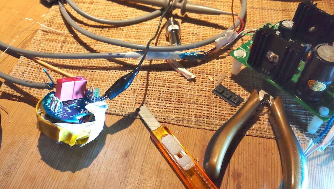

Macel - what DC levels on each pin on the OP amp should I anticipate?
For the now replaced mic I see basically OK 15 volts and on the rest about 1,9V - would that be OK?
I suspect not...
On the scope I see some varying HF with tens of mV's...
The OP amp itself got actually a little bit of varm efter a while - an indication I suppose that there is some oscillating going on...
Where to put a few of 0,1 uF's to make the whole thing stable?
Thanks for any help / suggestions!!

Yes
Yes
Yes
Yes for 1/2 but haven't checked 3 - did check 6/7 and anticipated same as for 1/2 but it didn't seem to be knock sensitive. I'll check 3!
Yes stable 6/7 (5?) but some hf oscs...
Maybe there is hope
All is a bit exposed so this might be a problems also...?

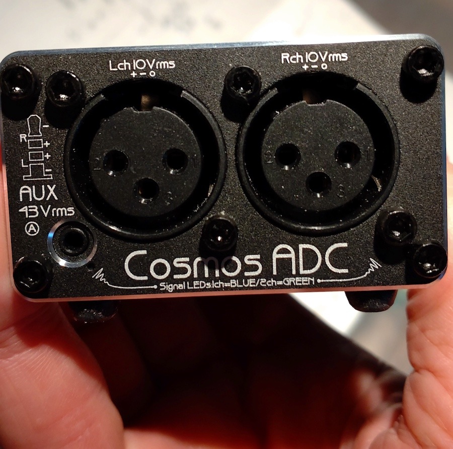

While I'm contemplating the situation with the TI EVM, I acquired on of these.
It was not solely for this project but I had hoped it could be a gap filler while I'm dealing with the EVM so that I could start doing some trials with the mics. But now that I understand that it is single end, maybe it will not be a reasonably match...
Assuming its XLR inputs are line inputs only, so with no risk of activating a phantom supply, it should work. A single-ended signal is mathematically the same as a differential signal with a common mode signal of half the amplitude.
The noise floor is probably poor and if the Cosmos has input transformers (which I don't expect it has), their cores may get magnetized.

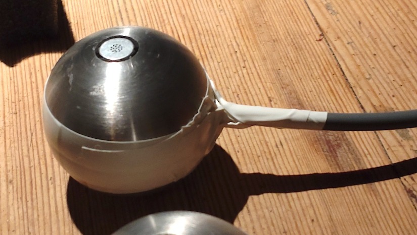

Attached is first recording (24/96) excerpt with the microphones using Cosmos ADC at highest sensitivity. I mod'd the Line-audio mic holders to fit the "kugel" - this needs an other solution....
Gain added digitally in post was 30dB.

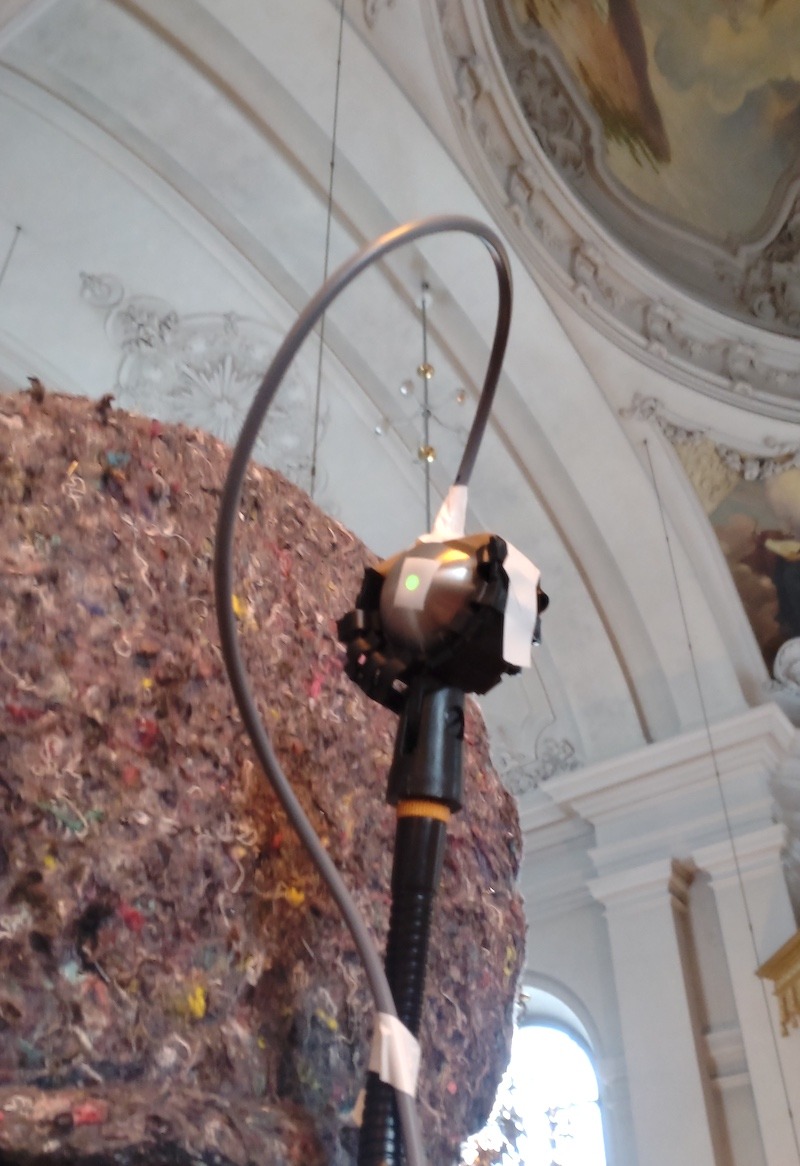

Mic halfs where only taped together (with a slight gap for the cable) so not in their final intended fashion. One can see the green LED shining thru the taped hole where the cable shall go in eventually...
Picture shows all packed up for field duty.

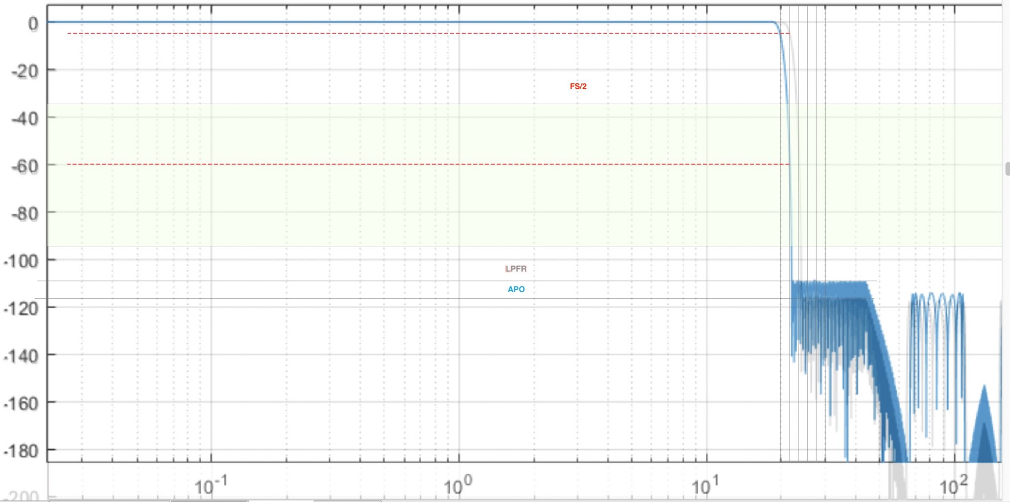

It seems properly steep to get rid of anything dangerous at 96 dB down at 20k->3oct = 160kHz -> Fs = 384 . But OK, I see, so no need to worry about aliasing - is that what you are saying.
With the scheme you describe, is the "only" thing the filters in a AD needs to do is to remove the mirrors which is basically "hf noise"?

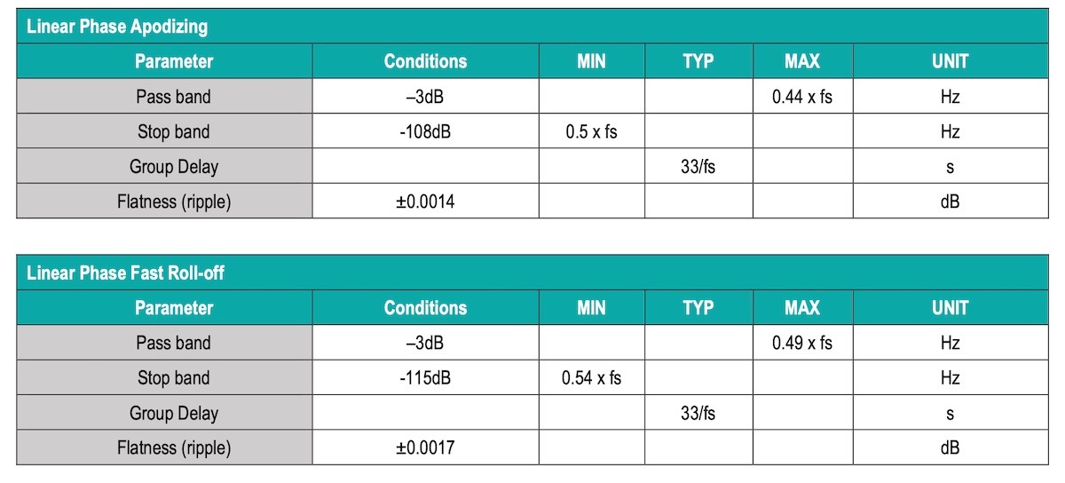

This from the Cosmos AD:
Which one would you use Marcel?
Linear phase apodizing, as it is the only one that has a stop band starting at fs/2 and not higher.
According to the datasheet, the ES9822 modulator clock frequency is 22.5792 MHz to 24.576 MHz. If that is also the modulator sample rate, the analogue part only has to suppress signals above 22 MHz to avoid aliasing. The microphone itself probably already has quite some attenuation there, and the only acoustic signals are presumably very high harmonics of bat echolocation signals.
