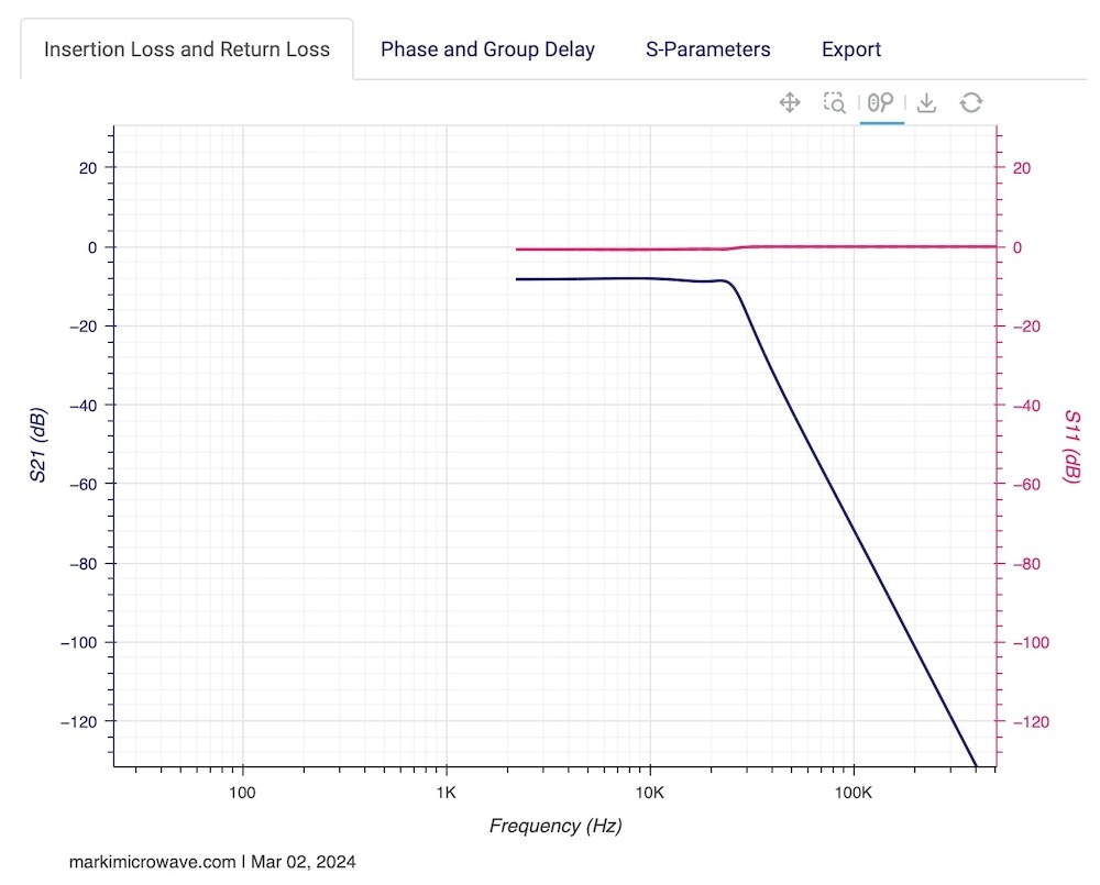

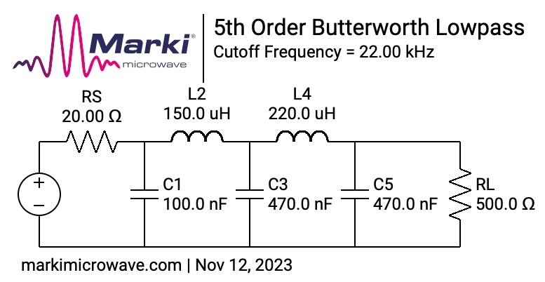

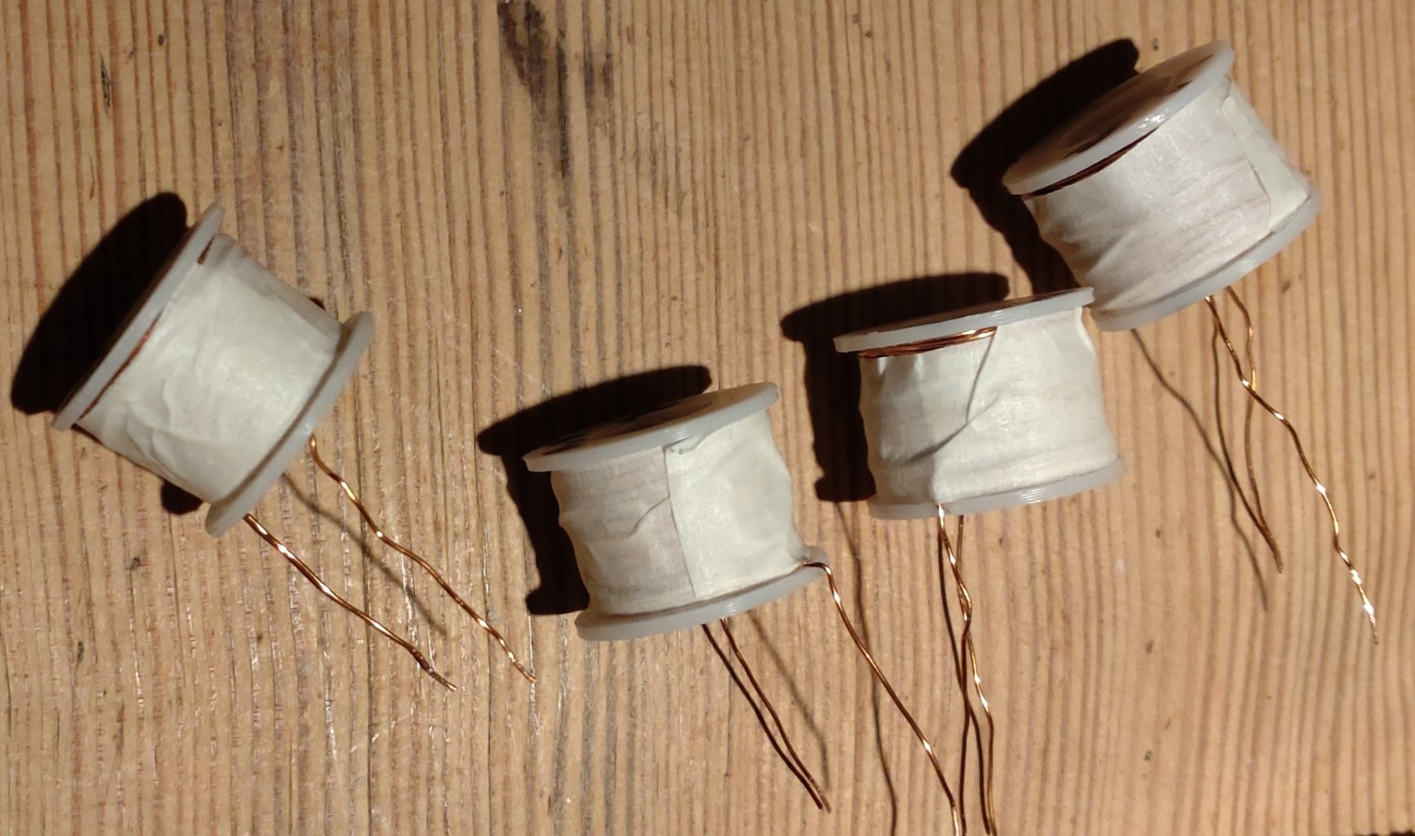

a) Designed and built anolg 5th order LP filter:
Approx 100 dB down at Fs/2 if at 384 ksps:
Made me some coils with the help from a 3D printer owning friend :)

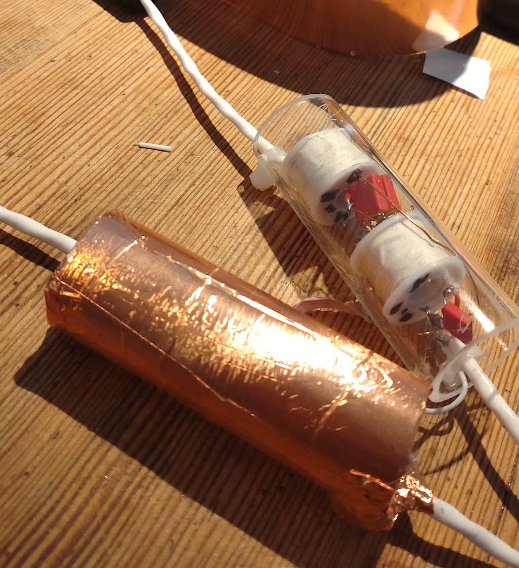

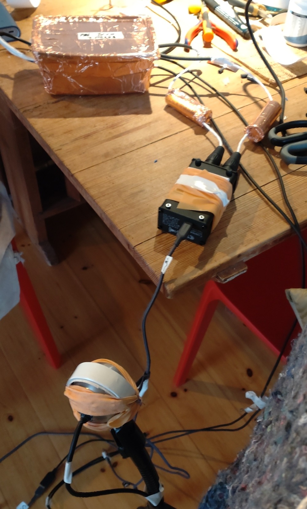

b) Sheilding with the help of copper tejp. Worked really well...
The whole recording system is one single continuous cage - mic, cables, "box" and ADC. Hmm, well, the battery pack remains... but great effective as we shall see...

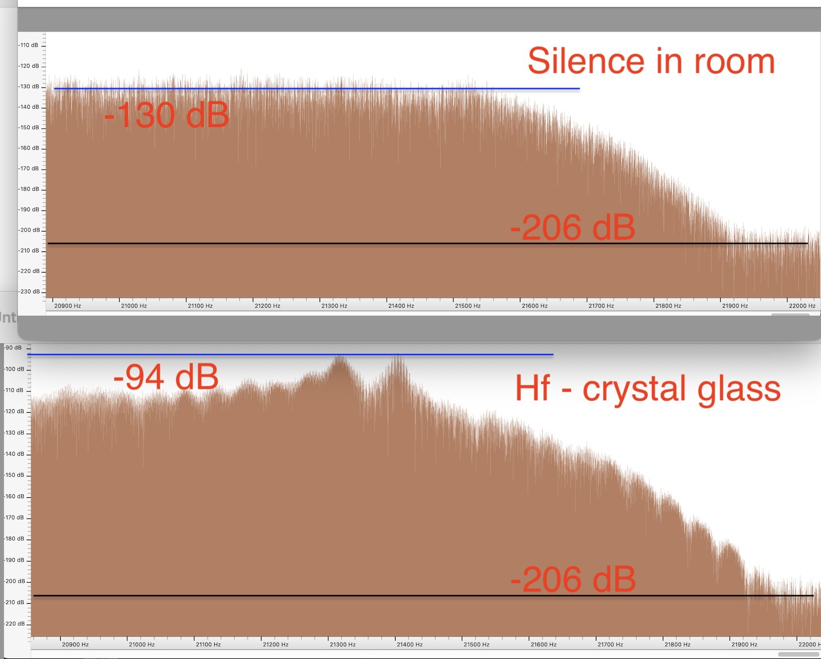

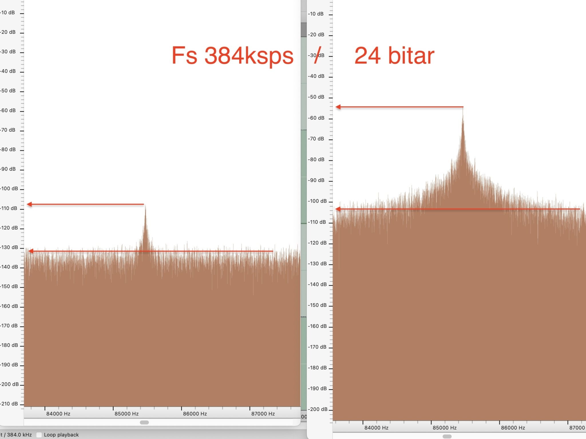

Measurements:
Analysis with continuous cage connected to earth vs. not connected to earth. 30 dB diff :
Same recording but processed to 24/44,1... comparing two sections of same recording - one I did no noise, the other I struck a glass with a metal knife - focus on "hf"... NB1 frequency axis... NB2 - the very low rise level at near FS/2 - NB3 - this is from the recording system as intended for field use - recorded at 24/384.
I know these absolute numers are probably not correct - but the difference is probably... Seems promising - now out on the filed ;-D

Here are two excerpts from yesterday recording with the revised gear and down-sampling process. A is from the silent beginning and B is from the roaring end ;)
The list of improvements:
  • Added analog anti-aliasing filter.
  • Partly new cables.
  • Farady cage created
  • New resamplingsprocess - 24/384->24/44,1 by CamillaDSP
  • Dedicated battery for the Cosmos ADC
Complete recording data:

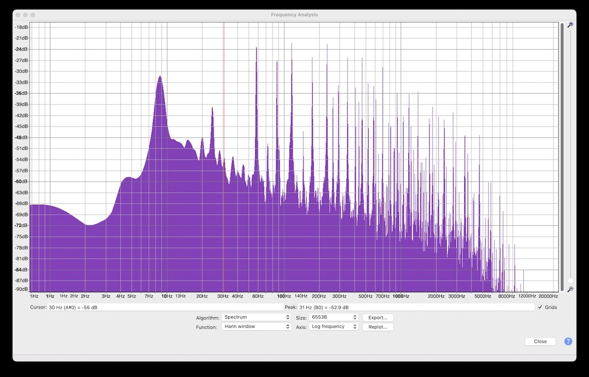

Well, it's an organ. In a church. But I would like to say that this particular one is a bit screechy in its top registers. At the final go, my ears ring... and it doesn't have 32" pipes so the lowest tone its about 58 Hz if I look in the FFT... so not that super impressive as other churches, but still should sound quite massive/potent in a "final push"..
https://sv.wikipedia.org/wiki/Adolf_Fredriks_kyrka#Orgel - it says that there is a "Subbas 16'" - the should be about 30 Hz - perhaps it broke nor not played.

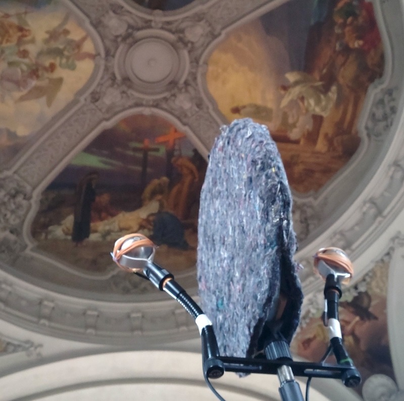

Sounded a bit muddy in the midrange frequencies and rolled off in the highs. The room sound echo/reverb decay kind of cut off early; should have continued down to a very low level. I'm guessing some IMD and limited dynamic range?
EDIT: Are you using electret mics? If so, what bias voltage are you using?

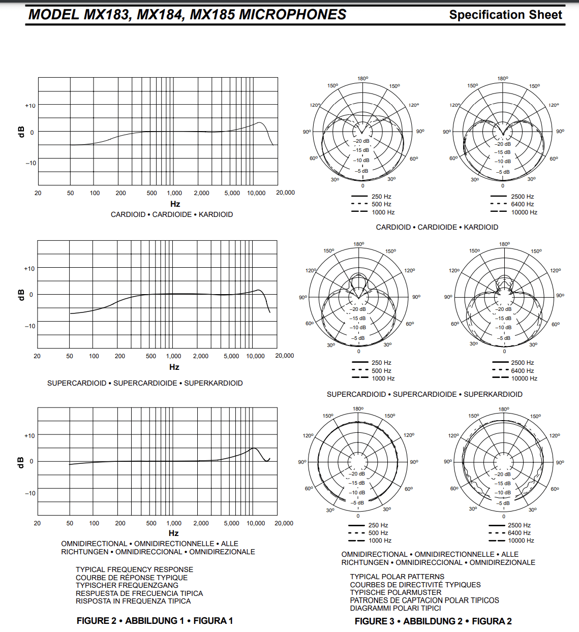

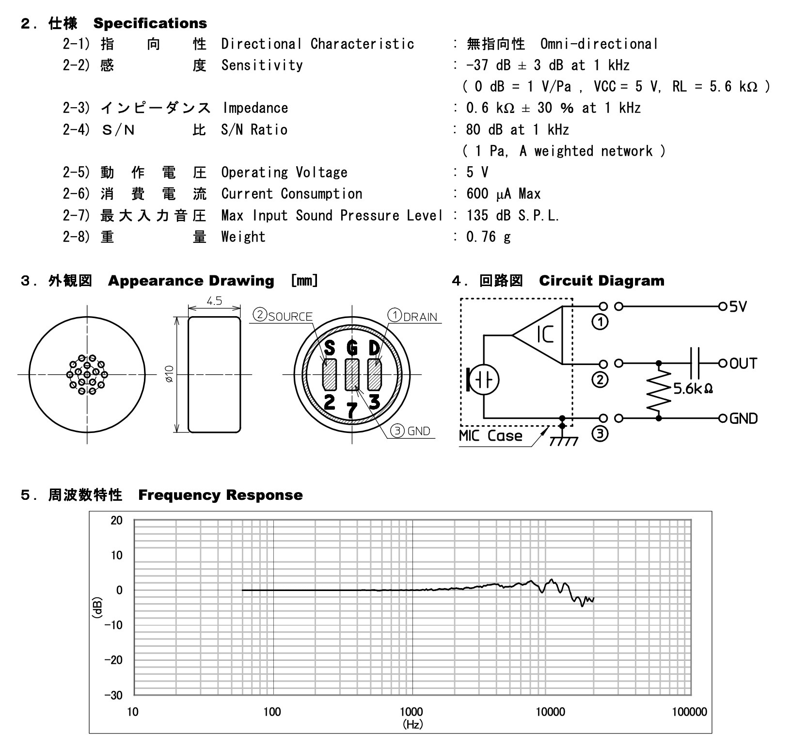

Looks like 8v through about 5k? Maybe that's what the manufacturer recommends for those? I used to use some Shure MX184 (actually the R184 capsules) with 2.2k and a 9v. They are super cardioids:
Just wondering, since it all starts with the mics and what they are capable of.
Also being the experimentalist I am, if I were looking into why the sound of a recorder is the way it is, I would probably skip the AD/DA steps and just listen to the mics through an HPA and some cans to get an idea of the sound with an analog-only signal path. Then I would include the AD/DA in to see what that's doing. Just thinking its easy to measure the electronics; transducers are a bit different animal. My preference would be to listen to the mics along with any measurements of them. :)
Okay. 8v with a dropping resistor is not the same as regulated 5v?
Also, some electrolytics in the sound path area. Is their value high enough to keep the AC voltage on them less than 60mV at the lowest pipe organ frequency? Also sometimes it does help HF if electrolytics are bypassed with a decent film, such as Wima MKP, .01uf. (MKP may sound better for that application than FKP; sometimes it helps to get HF sounding a little better).
Looking at the mic specs some more, 80dB SNR @1kHz could be an issue. Maybe not going to get to CD quality (especially not like a well dithered CD).
