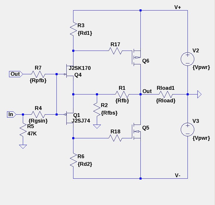

LATFET - lower Gm, lower input capacitance which is more linear than vertical fets, negative temp coefficient at 150mA - 200mA, different biasing voltages than vertical fets, more expensive
Vertical FET - higher Gm, higher input capacitance which is more non-linear, positive temp coefficient until high currents (10A or so), cheaper, better availability
I was thinking that source degen (not emitter! oops) of vertical would reduce gm to same as lateral, with similar linearity (thanks to degen) and improve thermal stability so as to narrow the differences between the two devices considerably ??

A bit more speculation, F5(ish) type input (possibly high current); here's the twist, the summed multiple outputs form the second half of a current mirror (multiplier), only a few extra active devices needed but still only a two stage amplifier.

My guess is that a Turbo version would require cascoding to keep the JFET drain voltages within limits and, unless beefier single output MOSFETs were used, would require either extremely careful matching of the MOSFETs or source degeneration.So when does the turbo version come out?
