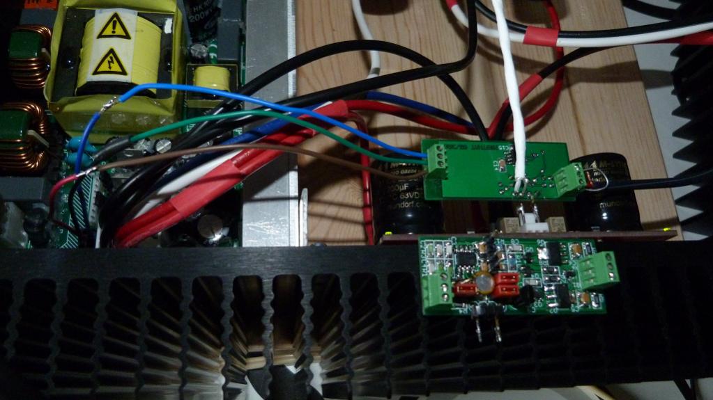

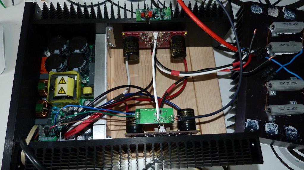

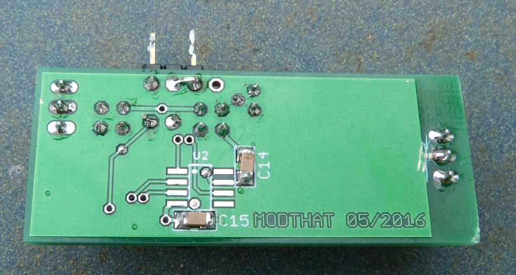

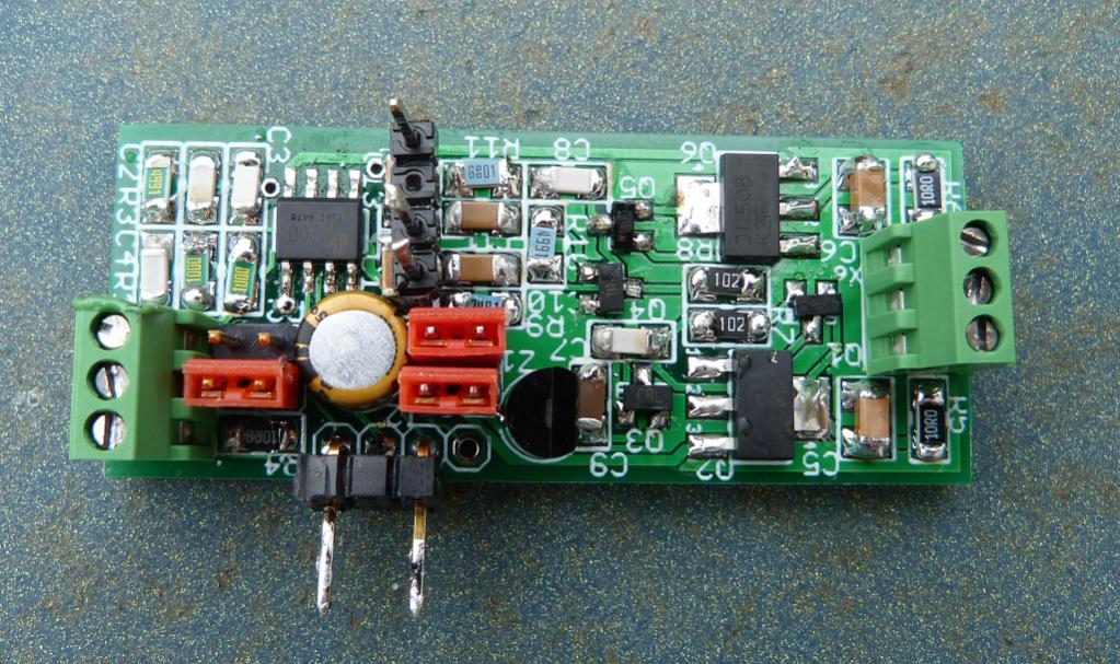

Hi Guys,
I m sharing with you the outcome of a small project for FO which is a small PCB for providing a differential input for the FO and also to facilitate bridging or use with single smps.
The PCB is 51 x 21mm and contains 2 discrete regs (+/-12) and 1 or 2 That 1200.
it is made to be soldered close to the FO and can be powered by the hypex +/-21V Aux.
The benefit of using a That is obviously to provide differential input capabilities, but also to enable integration of 2 FO with a single SMPS by uncoupling the 0V Signal thus ensuring expected damping and very high crosstalk.
A second That can be soldered on the botom side, in order to just invert the same input and then to drive a second FO to "bridge zem all".
I have not done any listening in bridge config, but I can tell you the FFT is wonderfull, most of the residual 100hz harmonic from smps are gone. Br
I have 5 pairs of PCB left for whomever want to play with this and share with us. anyone interrested please send PM and I might open a thread for further talk. Pinnochio please send me your adress by PM

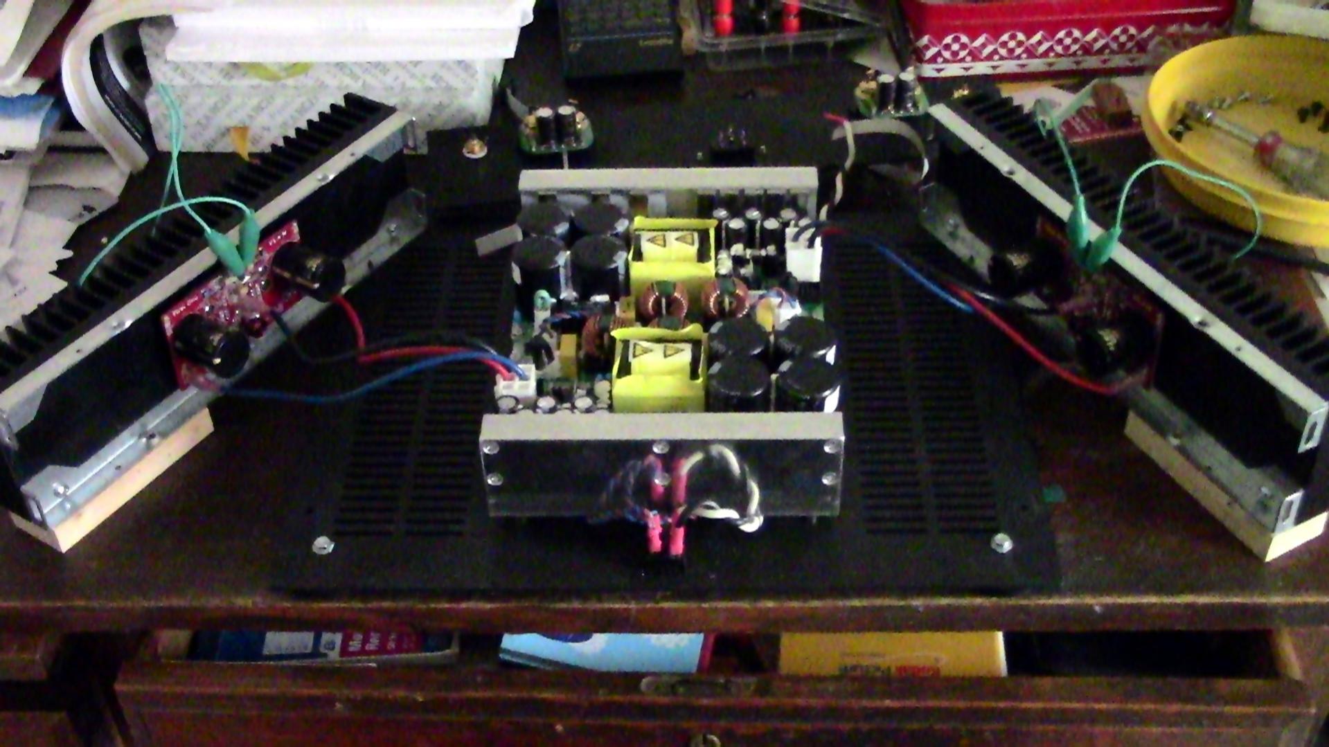

Almost there guys...
I am getting close, I only have my input signal and speaker wires to fabricate and hook up.
Power supplies work as expected and the First Ones leds light up.
I only have one DMM, so adjustments are slow and tricky. I am glad this is a trial all You expert amp builders go thru also. I started out doing something noob-ish, I laid the heatsinks down, for easier measuring, but found of course this did not allow proper heat dissipation. So I attached the heatsinks to only one side of the chassis bottom plate and fabricated some wood blocks to keep everything level (See photo below). Many of You can easily test this with a fully enclosed chassis, but for me, with far sighted vision and blind in one eye to boot, I need to make this as open as possible. (there are times I miss the near-sighted vision I had before getting cataract and having a lens implant) Once I have everything dialed in closer, and the amp has 100 hours into it, I will re-calibrate, with a fully assembled chassis.
Getting DC offset close to zero was not a problem. But getting the VAS idle bias (TP1-TP2 or TP3-TP4) down to 180 mV AND getting the DC offset to zero did not seem possible. The VAS idle bias started out at 560 mV And that was after an hour of warm-up time. The closest I got was 350 mV, but it was getting late, and I do not think I was giving the module enough time to stabilize. So I decided I would stop and come back to it this weekend.
The bummer for me, is the long, long, long work week a have. Monday thru Friday is ALL work no play, so I live for my play on the weekends. I keep saying, "this will be the weekend I get the First One done "... ...well it has been five weekends already!
I am feeling pretty confident about this weekend, and I am sure the blood sweat and tears expended can only make the reward that much sweeter.
