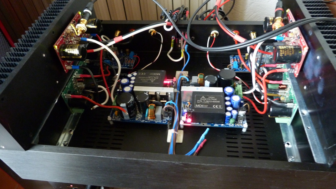

this is to share some information with you about 1.2 vs 1.4
as I got my 1.4 couple of weeks ago, I gave a pair of 1.2 (which havent been used in fact) to a friend who did quite a nice integration with 2 SMPS from Audiopower (DPS400-ST-2x45Volts).
Then he told me the sound is ok but flat, no life...
I was surpised but I decided to give it a try and to compare with 1.4 using same SMPS.

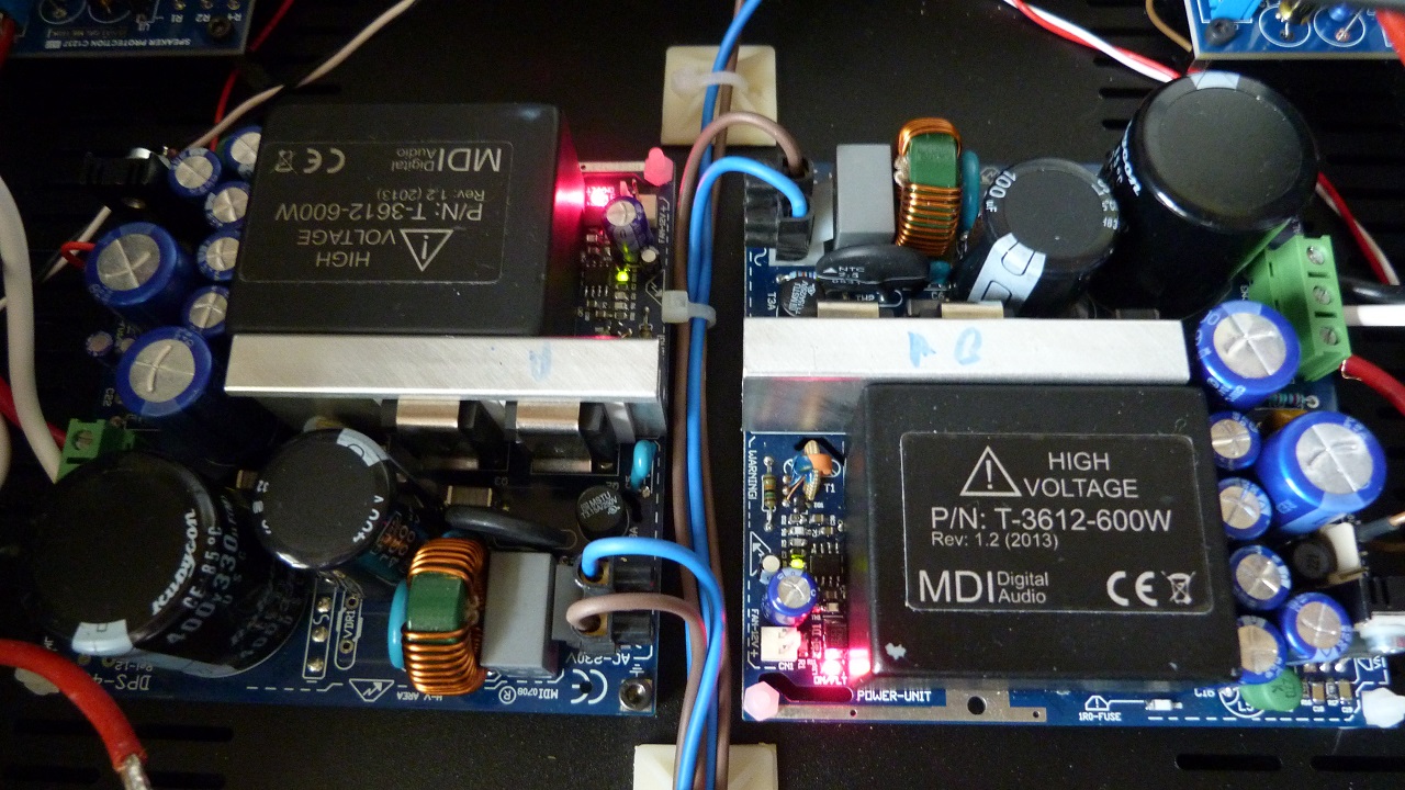

I ve been listening the 1.2 for 2 hours at quite a level (pot calibrated for 66Watss into 6ohms for 0dbfs/2vrms) and it was ok but yes it was flat. Not sure how to explain, just check if your foot is knocking the floor and then you know.
As on one side I have the FO1.4 with a single hypex, and on the other side a FO1.2 with dual SMPS, I was wondering if the difference comes for the SMPS or the FO. Then I dismatled my 1.4 eek and put the heatsinks on top of the FO1.2 and I ve just disconected the 1.2 and conencted the 1.4 on the 2 SMPS.
Whaou, back to life ! amaizing difference! the 1.4 ROCKS, really ROCKS, again, just check your foot. The bass are very tight and strong, and this gives an overall "loudness" like effect which brings life in the recording. also warmer.
my imediate recomendation to my friend(s) is to upgrade to 1.4!
as the DPS400 were only 45Volts, I wasnt able to push the system to its maximum. the good news is that at this voltage it is not hot at all, I got 42°C on 2Ux300 heatsink (after heavy listening) and the SMPS was at 45°C (surface, box open) with factory bias setting. This voltage si probably ideal for a bridge FO1.4 M solution.
I will test an higher power of this SMPS (S1/S2) in 52V later this month, as I think LC is right promoting dual smps with FO (also confirmed with a LTSpice simulation, this dramaticaly improve damping and crosstalk due to 0V signal configuration).
Cheers

one or two SMPS that is the question
By the way, I ve done some simulations in order to better evaluate the theoretical impact of using a single PSU instead of two, as this topic has been raised many time.
in fact all the concern is about the current return in the ground wire (going back from FO to PSU) which is generating a shift in the 0V signal as the "in-" of each FO chanel is located on the FO PCB.
Hopefully these wires will be in the range of 1 to 5 mili ohm according to equations.
I enclose below the result of 3 simulations which are interresting not in term of absolute value, but in term of delta by comparaison to a dual supply simulation.
Also all my simulation are made with a model for the FO and the Hypex which is far from the reality (but not stupid).

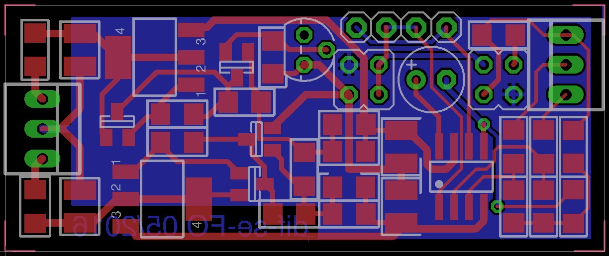

if we put a differential receiver upfront, such as That1200 or INA134, this will be up to 85db CMRR, with the concern of an additional component in the signal path.
I have just launched in production a smal PCB (51x21mm) containinng 2 regs and 1 or 2 that 1200. It can be used as a differential receiver for FO, or as a way to solve the damping issue and to use FO with a single SMPS thus reducing overall cost, or as a way to bridge to FO with the second That being inverted.
I enclose the picture of the PCB, and I plan to open a topic later this month showing more details and results with it, not to polute LC thread. As I will receive 20 PCBs next week, if you guys are interrested by 1 or 2pcb just drop a message and I can send you a basic mail free of charge under the condition that you contribute by sharing your practical experience.
hope this is of interrest, and appropriate here and then

I m realizing that due to the cables from amp to Loudspeaker, the difference in Damping between 1 or 2 PSU might be only 3 time and not 17time as metioned in previous post (which considers 0ohm for cables)!
the more I m digging on this the more I feel that one good PSU might be good enough to feed 2 big boys. Stay tuned.
