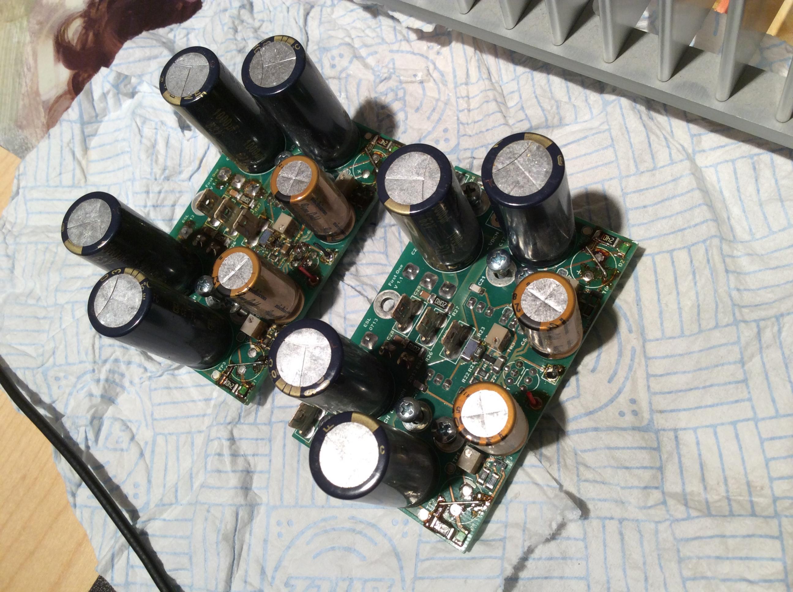

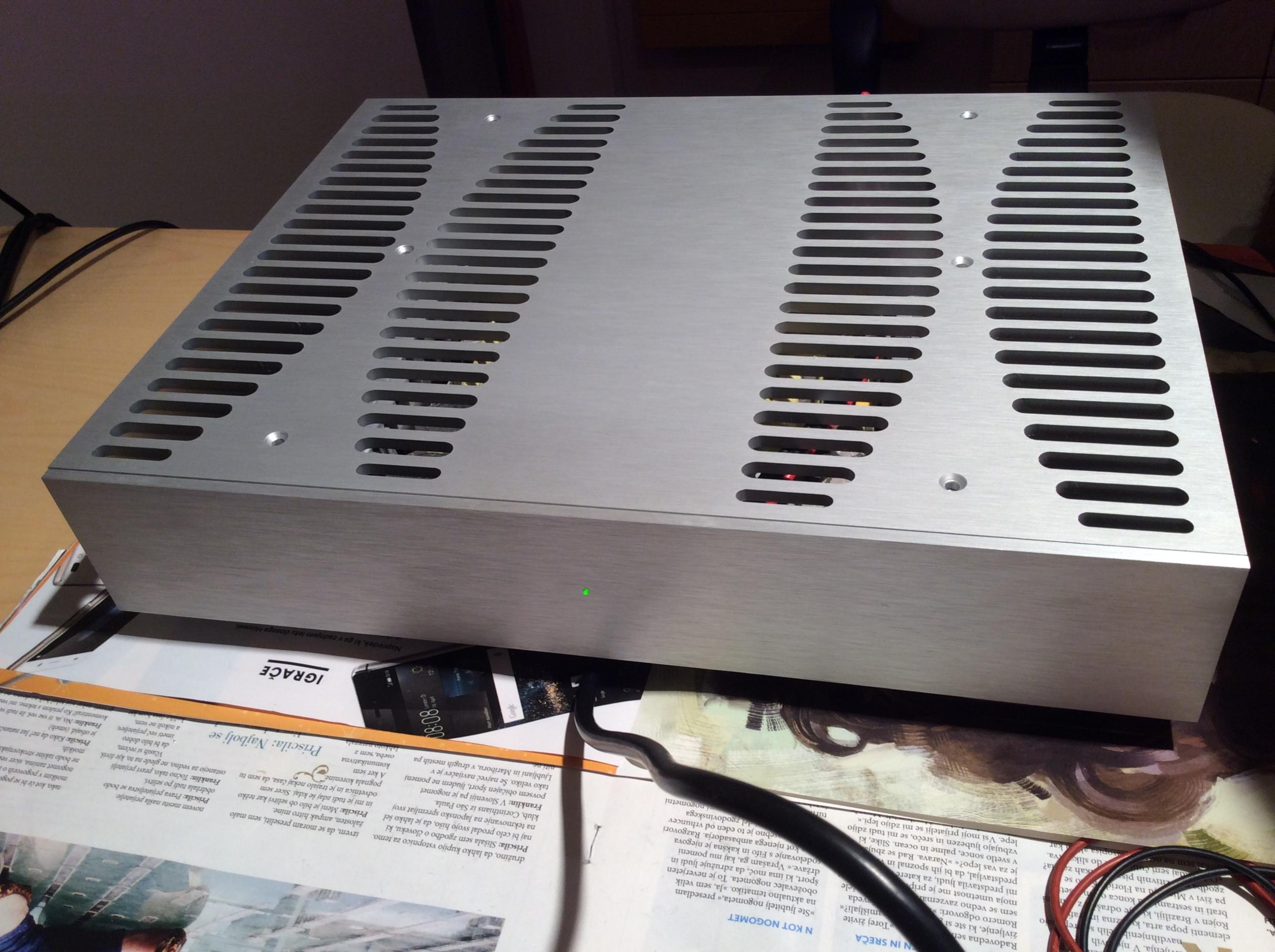

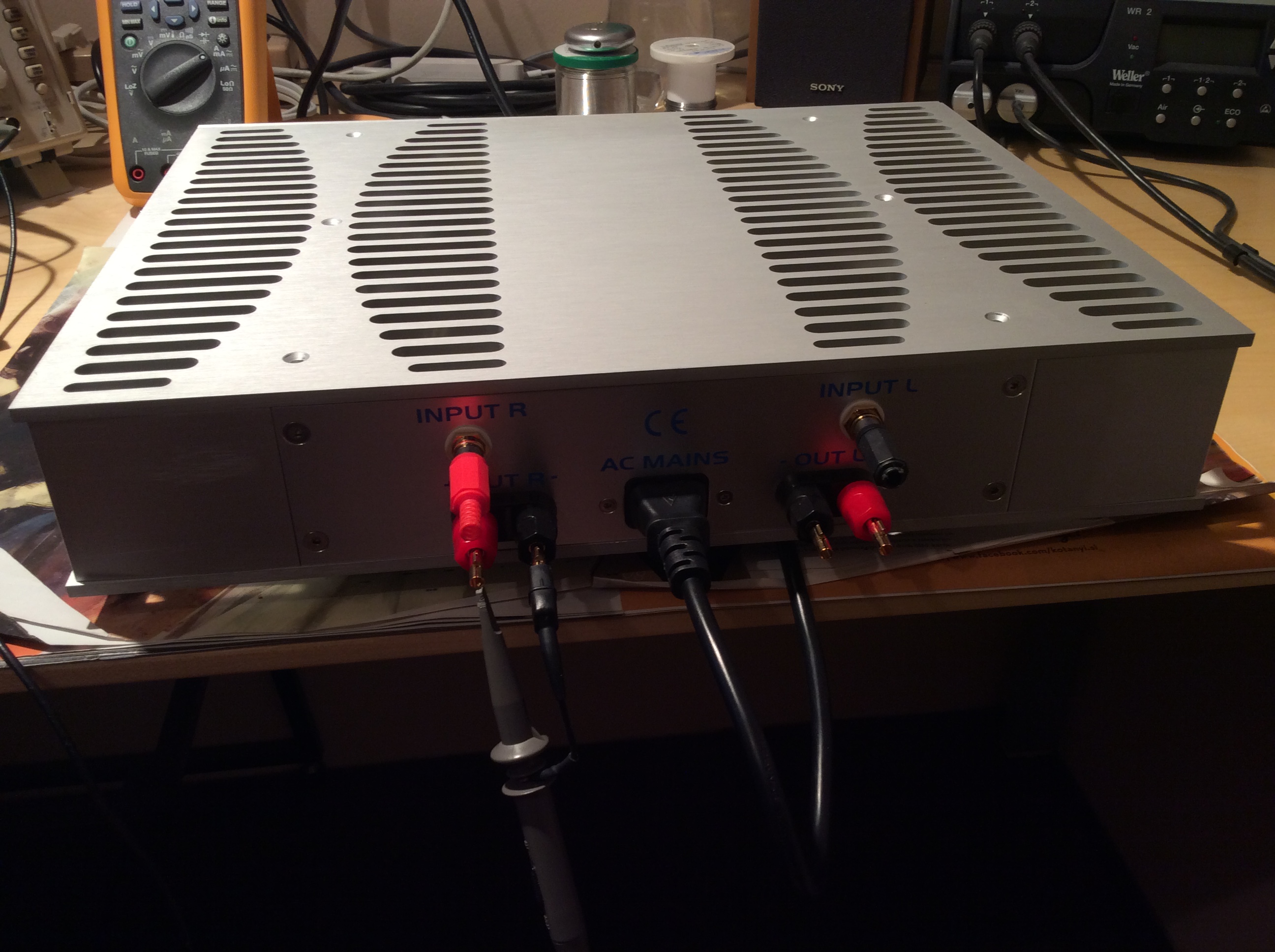

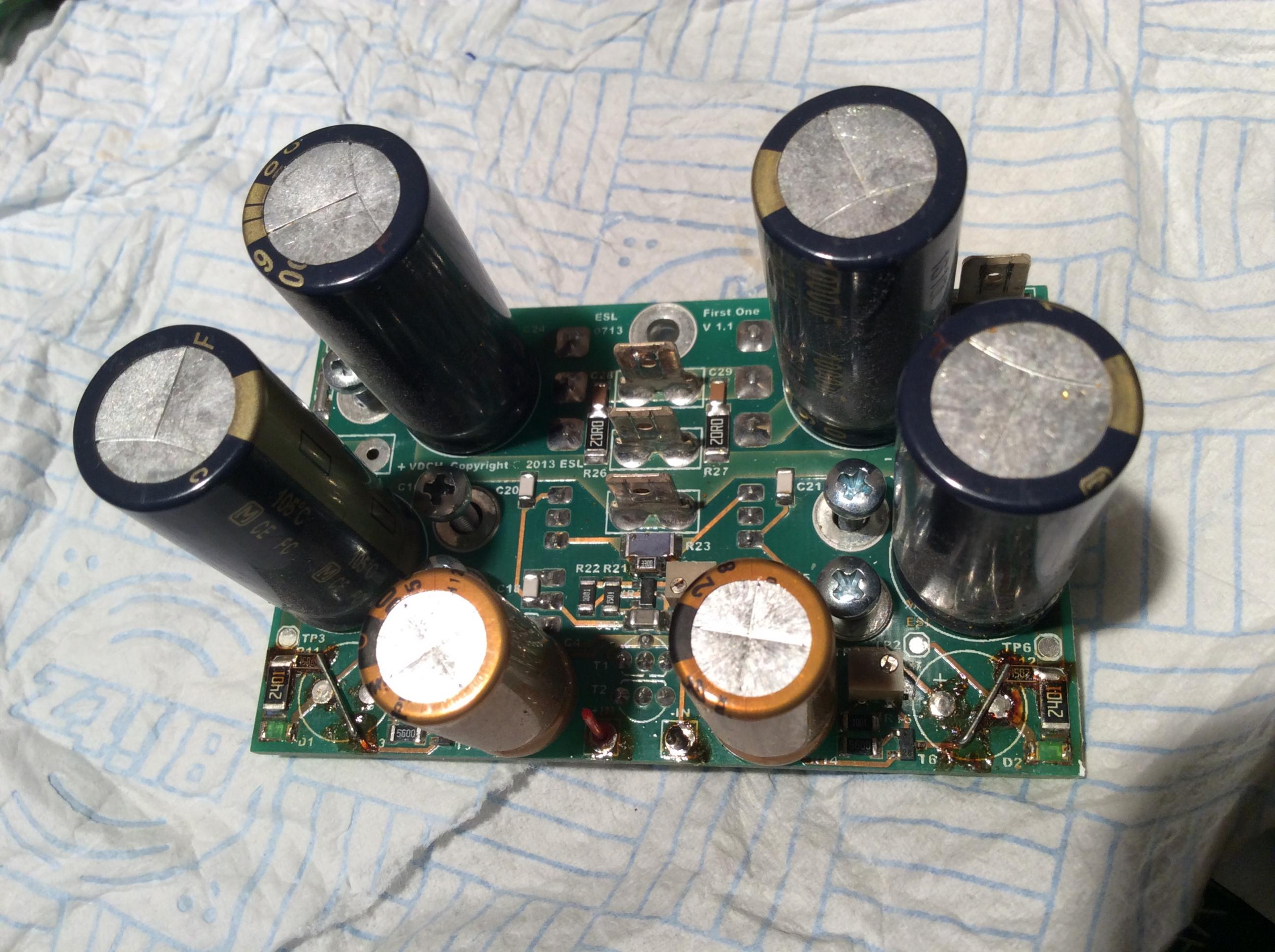

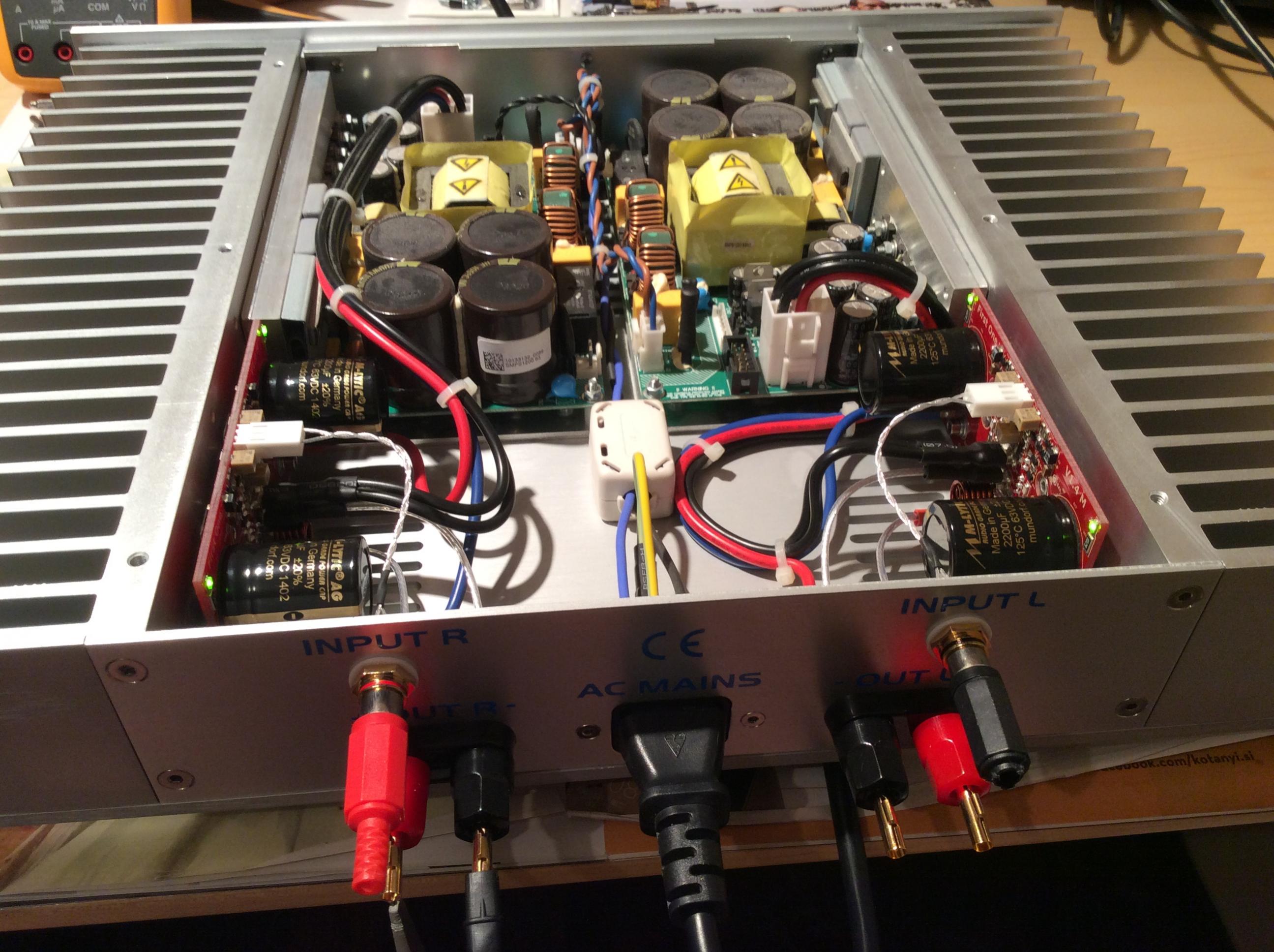

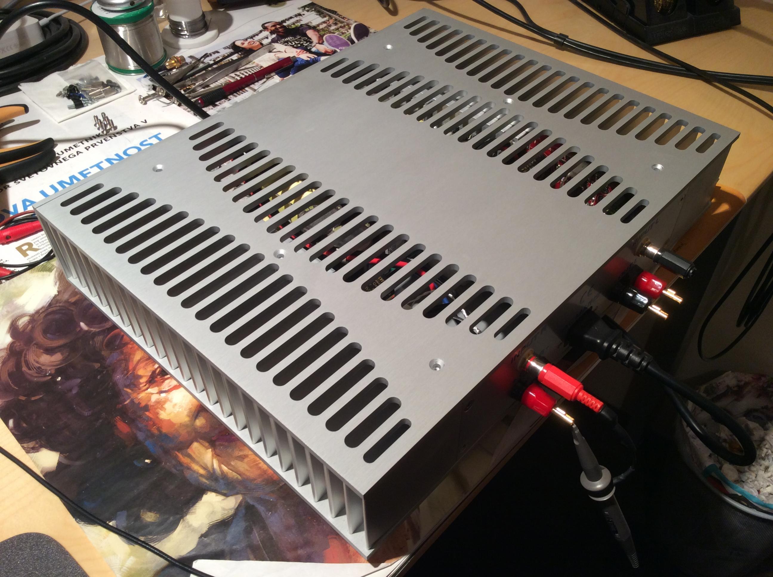

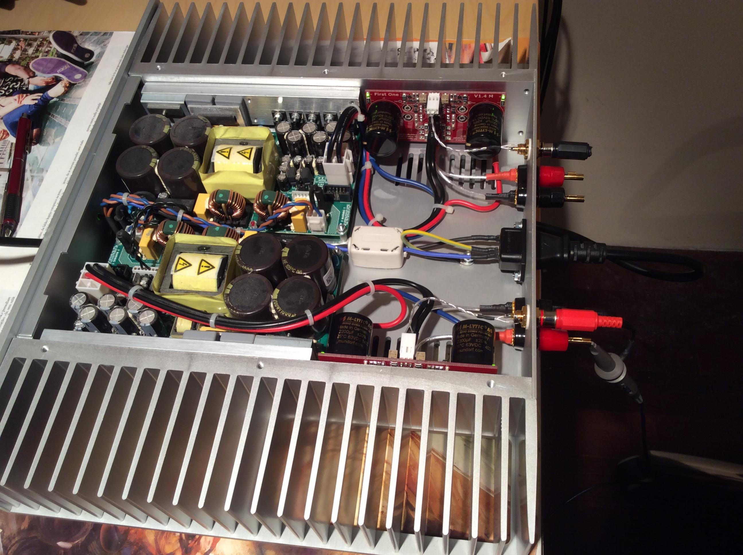

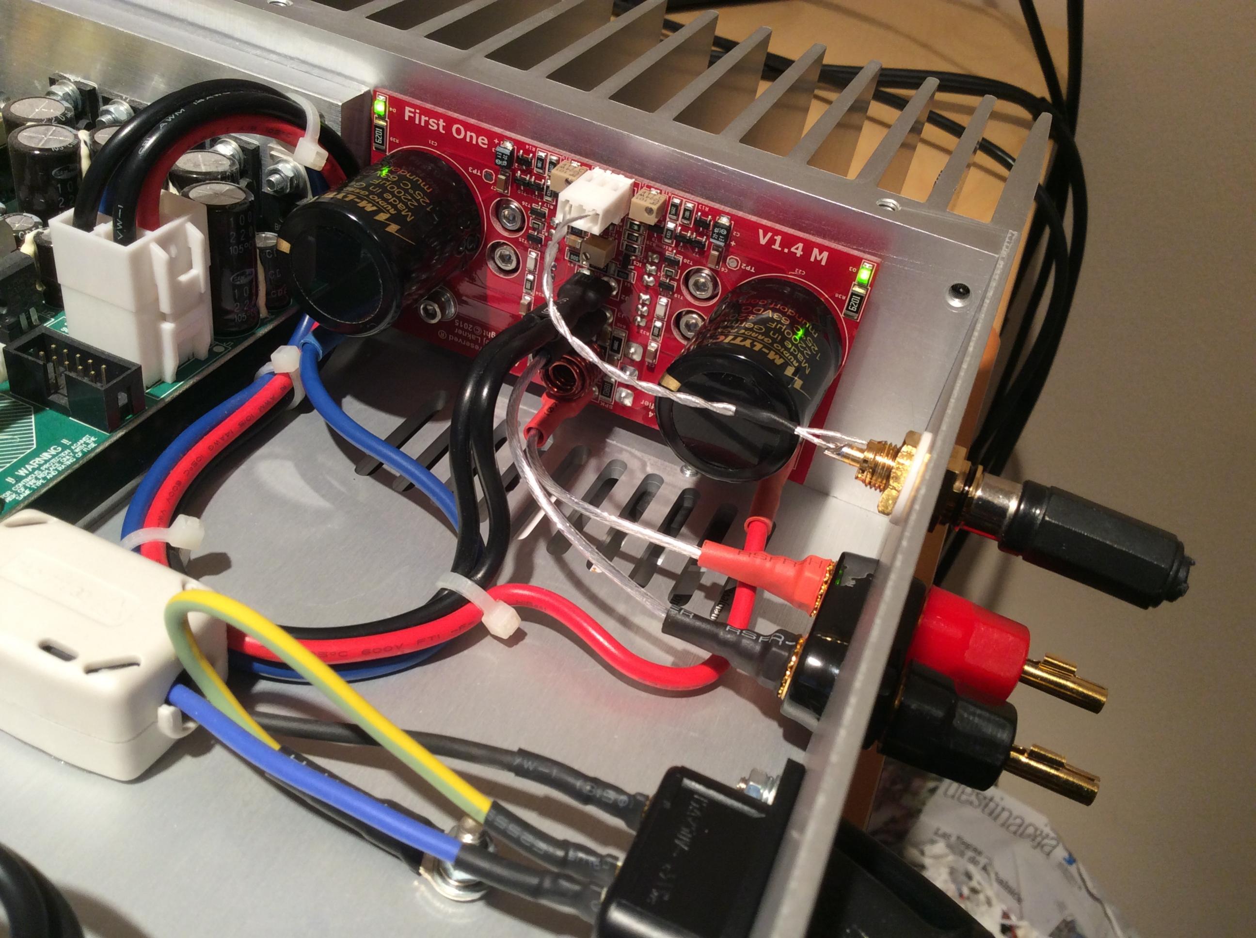

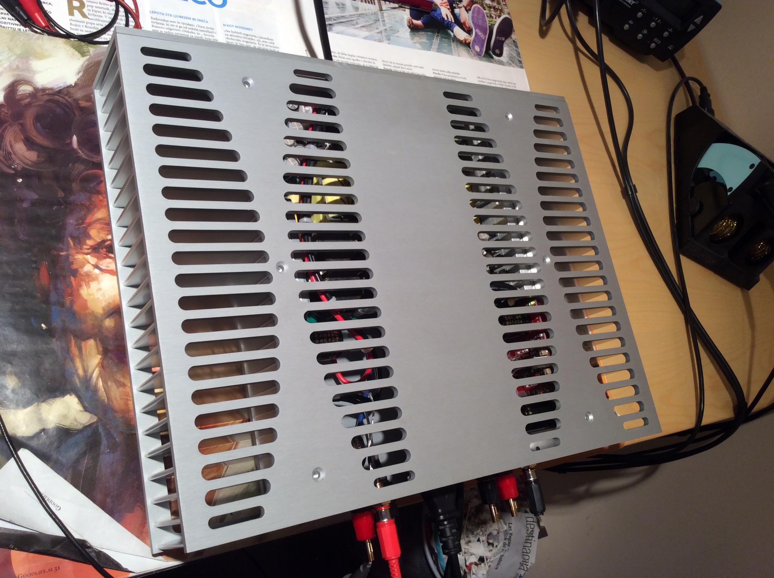

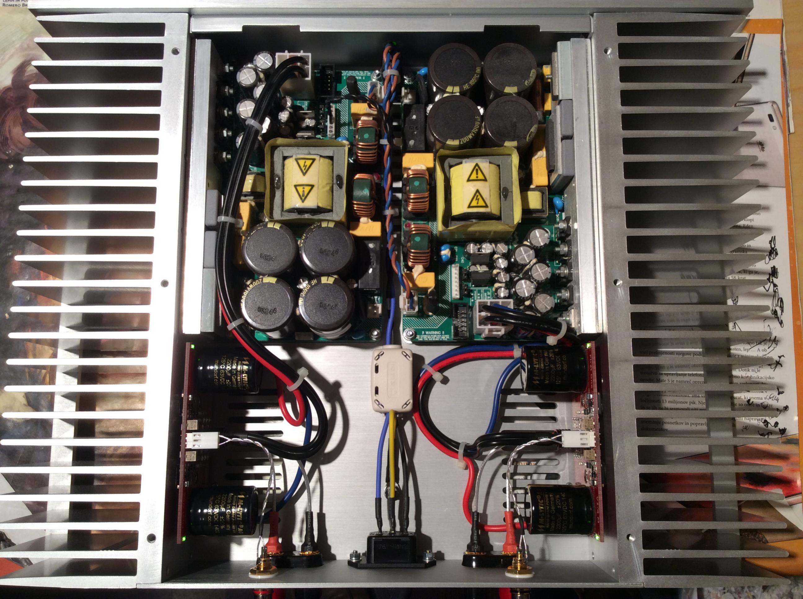

First One module began like this..
In 2013 the first First One v1.1 module started its life in a chassis below. Lately, after reading few positive reviews my friend was finally convinced and asked me to make an upgrade. Here are some photos of job done.

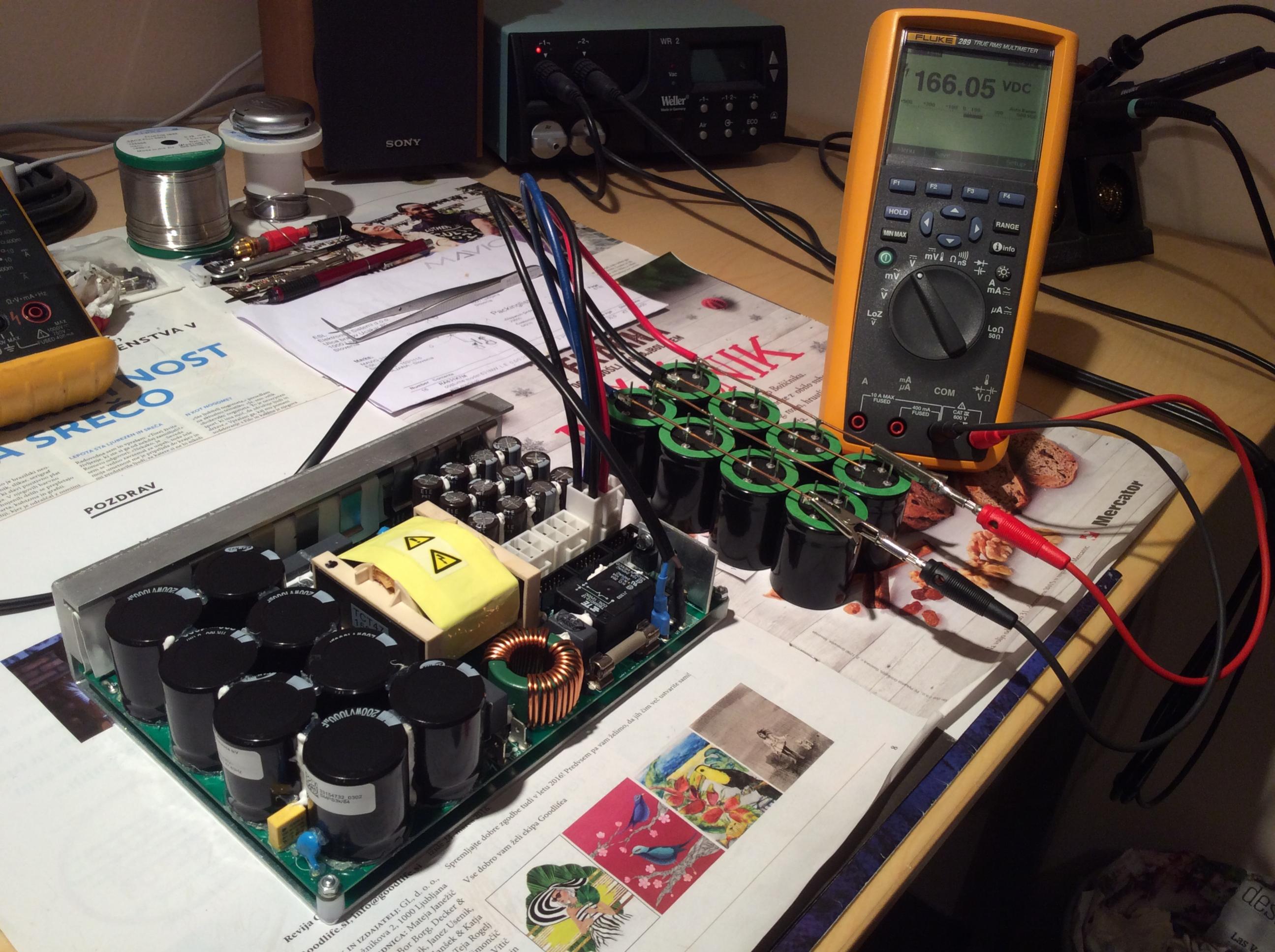

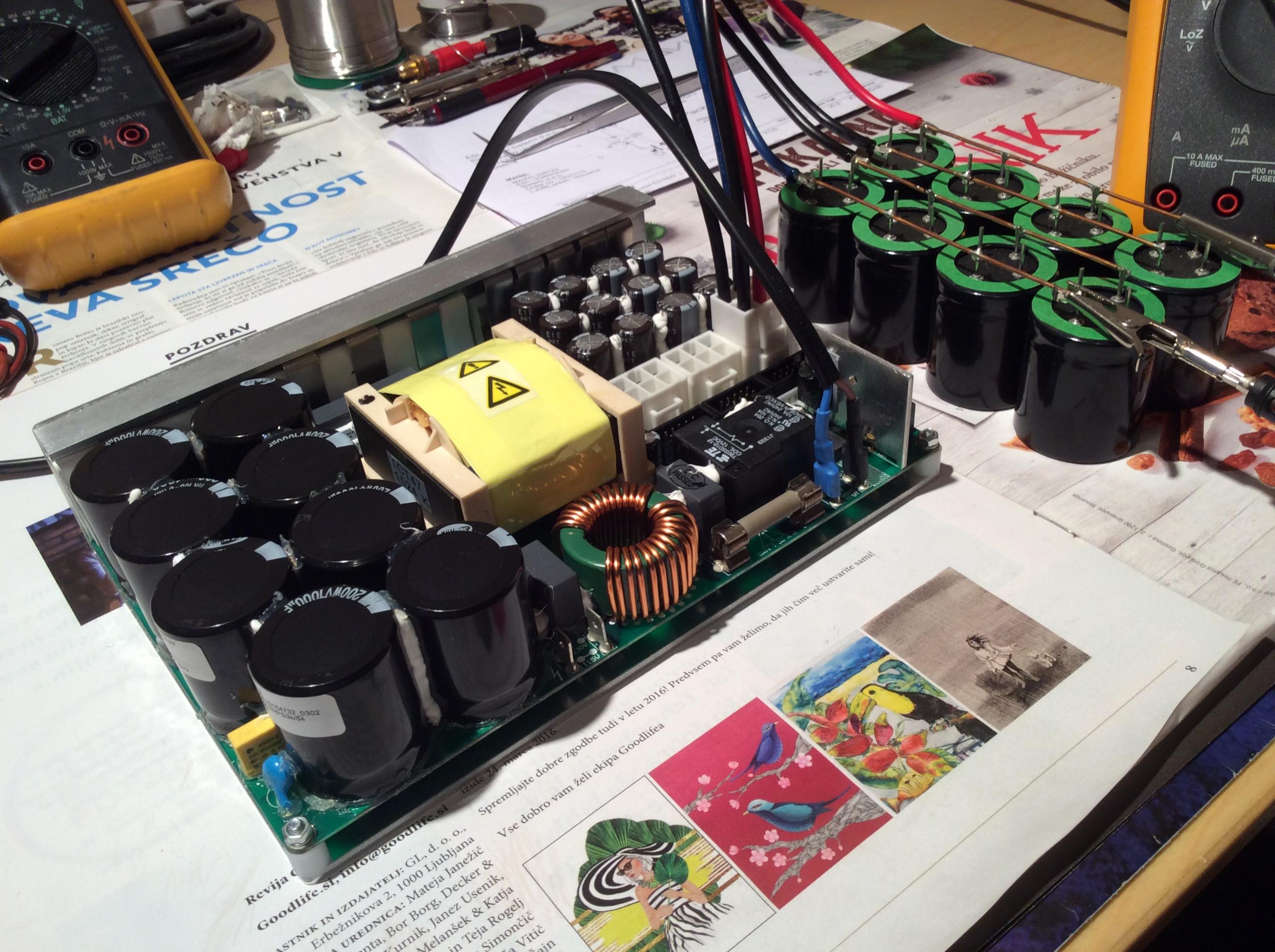

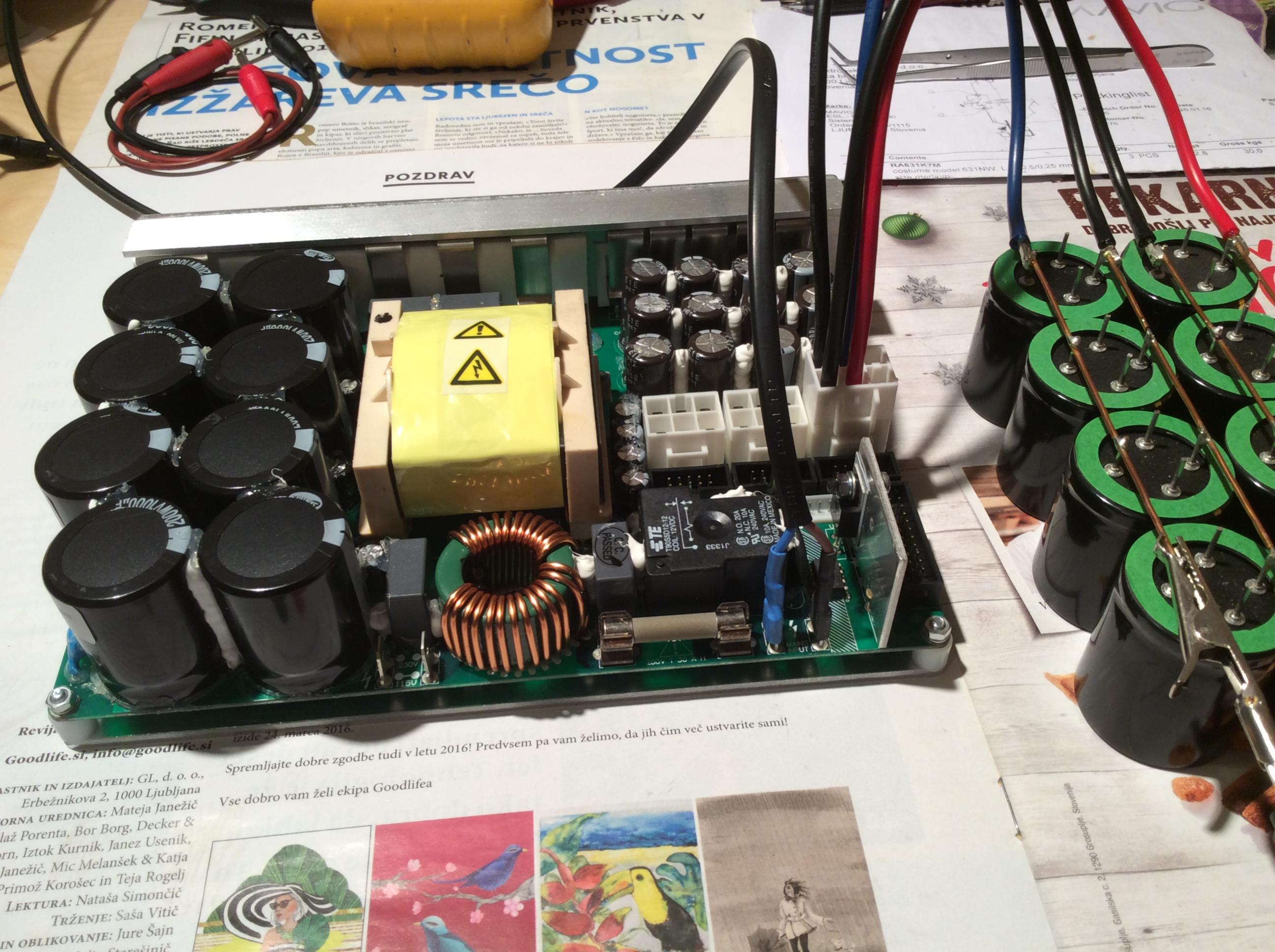

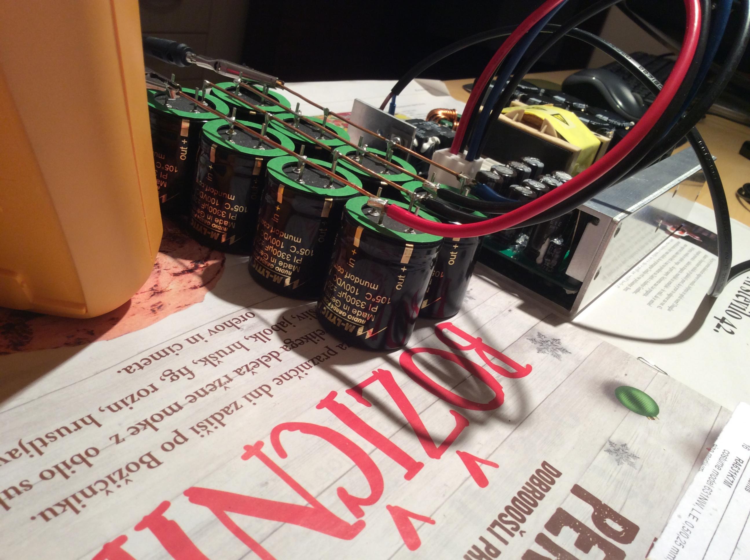

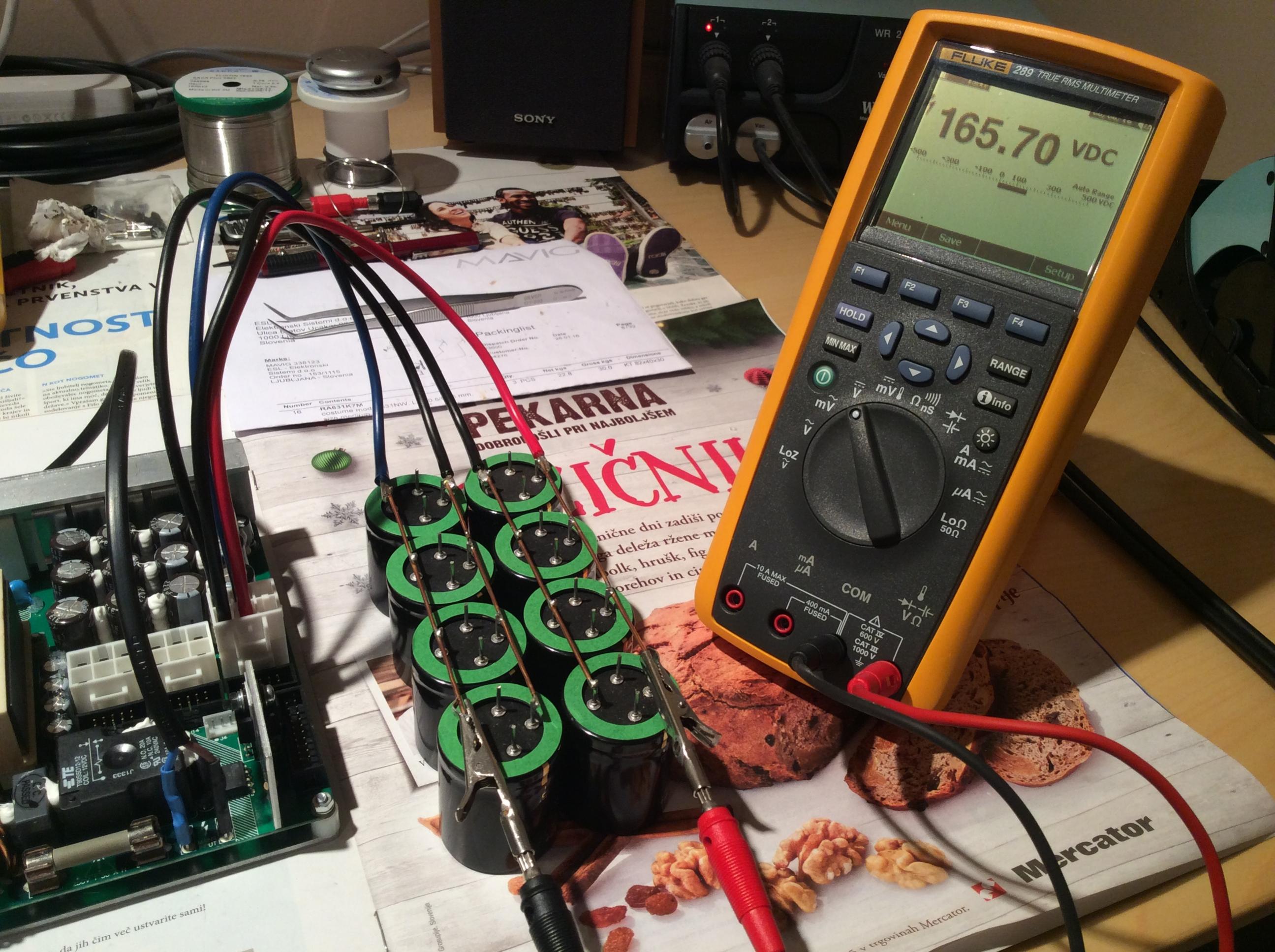

Playing with the beast
Two SMPS3kA700 just arrived on the testbench. Both turn-on with extra 26 mF caps on the rails without any problem. 200 J of energy storage per channel will be more than enough for the First One L module.
