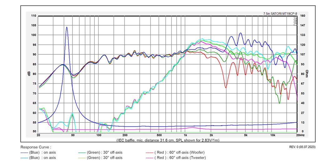

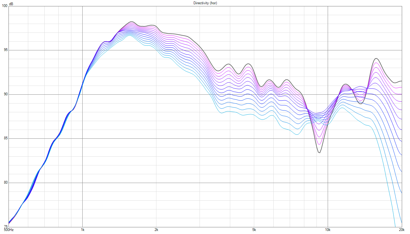

finally, the Satori coaxial is now here

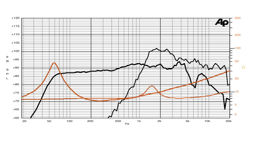

Which Coax of similar size is the better one? (passively filtered)
Sourcepoint 8 inch or the slightly smaller Satori incarnation? (7.5 inch)
I think the Satori sounds at least as good , that's all an average DIY guy wants to know!
With an integrated sub (bigger cab of course reaching down to the floor replacing speaker stand) it will even beat the MoFi asthmatic stuff in the LF range ....
I see a big wide grin in the faces of Satori Coax owners coming up :)
And tears in the eyes of Andrew Jones :(
Power to all our DIY friends!
The configuration looks attractive but at £250 it is too expensive compared to the price of a good tweeter and midrange. Their budget coaxials at £45 are a good price. Would like to see a standard range coaxial at £100-150 but not hopeful given it would almost certainly hurt sales for this driver which being their prestige brand likely has a much larger profit margin.
The edge around the tweeter looks sharper and deeper than it might have been. I wonder if diffraction off it is helping with the high frequency radiation pattern. Anyone? It is causing the unsightly on-axis deviations but these are likely to be largely irrelevant in use.
