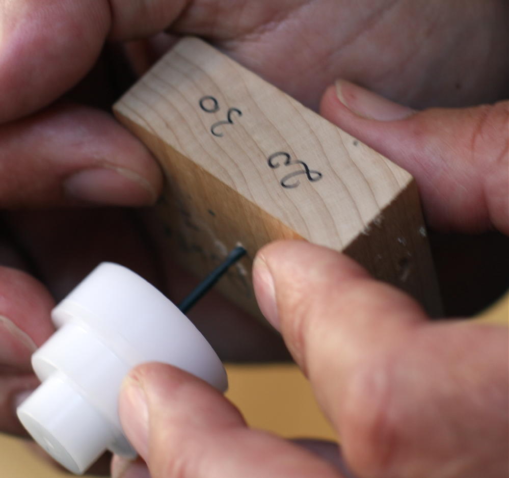

Here's a simple way to remove new table from a shaft. I used 1.86mm drill bit mounted in a wooden block. The drillbit goes through the hole on top of the puck; by pressing the wood piece with your palm (against the shaft) and pulling with fingers the bottom of delrin puck, it can be safely removed without damaging anything.
Any attempt of using shims, screwdriver or anything similar between motor and puck, to push the puck out, will damage the shaft mount.

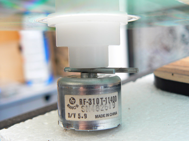

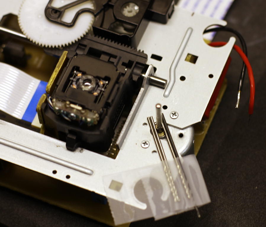

Alright, it's installed now. I used multiple 1mm drill bits as spacers to set disc table height. Please note that 1mm is not from the frame but from motor bearing plate which is somewhat above frame surface.
That distance is 10mm for the original disc table supplied with a transport.
There is some wobbling and you can notice it by the amount of movement the laser lense does. However, I think it's still rasonably small.

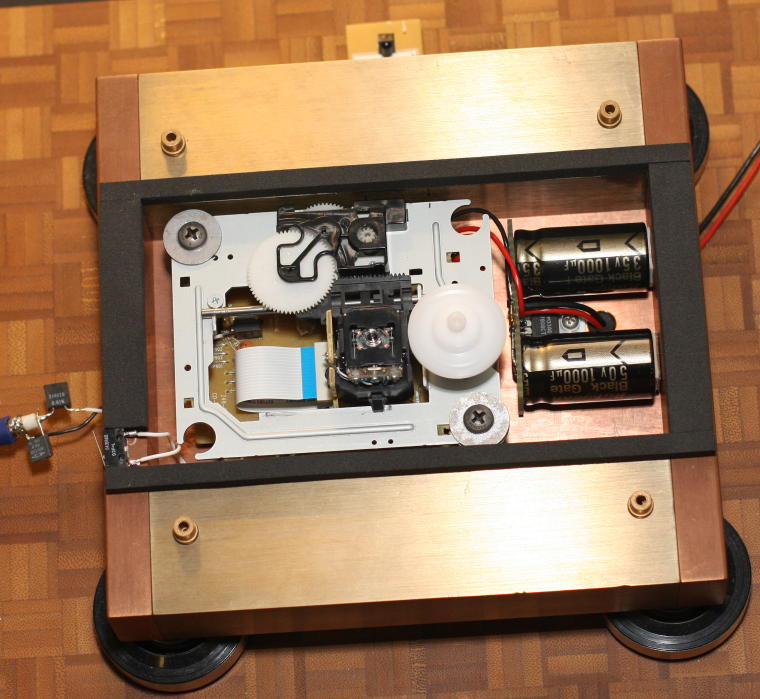

That's my present setup. I recently installed some foam material around the inside edges of copper/bronze frame to prevent dust collection from underneath the acrylic top. The TOC switch is elegantly installed on a side. The output cable (6ft Belkin Synapse) is soldered directly to resistor divider (300R Vishay/100R Caddock)

About the sound with a new clamp, well, it seems like it is an improvement.;)
The sound is more effortless, there is more dimentionality and separation. The resolution seems to be improved as well. The bass better defined and I'm noticing the improvement in accoustic space.
The sound may be a bit more forward, but it's not bothering.
Overall, it is probably an improvement similar to installation of a new clock, without typical drawbacks of those clocks ;)

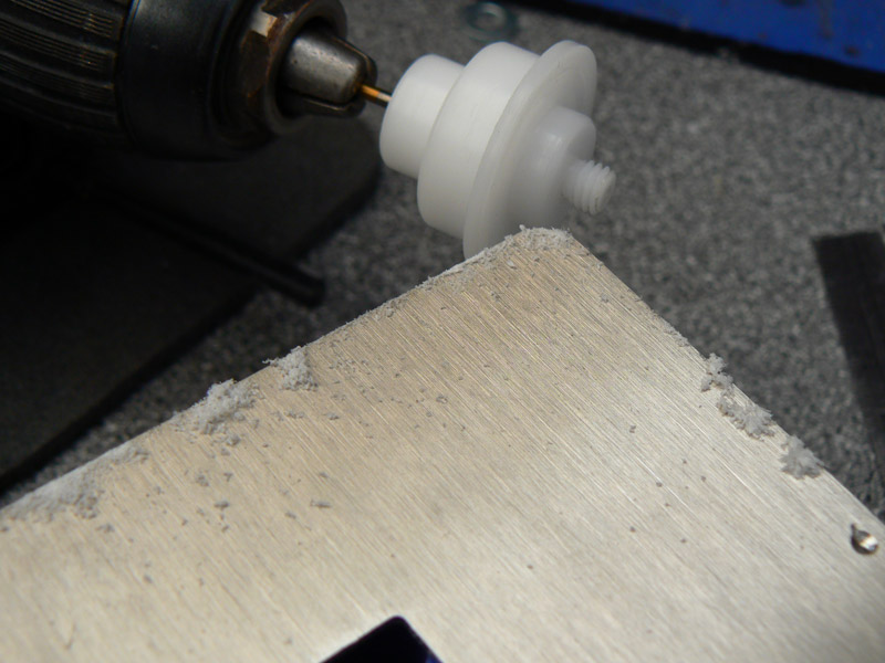

I did press it by hand with a top cap on. It's a good idea to run spare shaft few times trough, to loosen hole a bit, as it's rather tight; for that you may use a chuck and go slowly with rotary motion.
If the shaft hole is made last, after the table is fabricated, some wobble is always possible, deppending on accuracy of the hole.
If I can suggest something to fabricators, why not do the final sweep on the lathe with a table mounted on a 2mm shaft, you only need to re-machine the surface of the table supporting the actual disc. That should provide perfect horizontal alignement, with regards to the shaft.
Another thing, the cap side wall should be also re-done, when mounted on a table with a spacer of the same thickness as the CD. That would provide perfect centering, presently it is a bit off and probably due to thread imperfections.

Okay Peter you have persuaded me to continue with it.
I mounted it on a 2mm drill and used a piece of stainless steel to shave the table surface and the puck. It has worked. The material seems to work very easily.
I had given up on it and had nothing to lose and am not telling anyone else to do the same..
