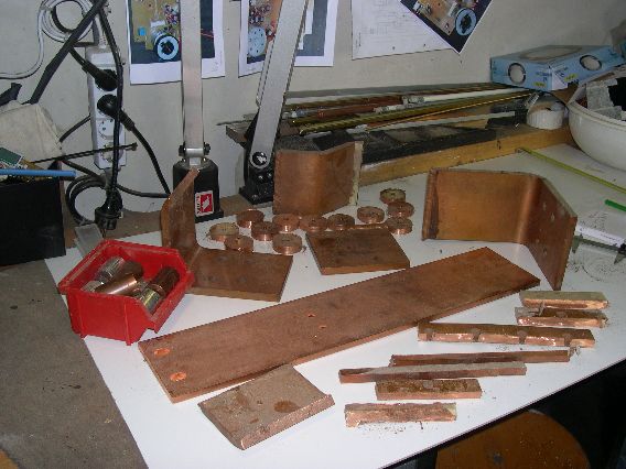

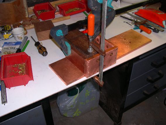

Today I took the entire day working on the copper enclosure....
details on the dutch forum...sorry :D

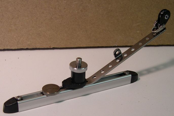

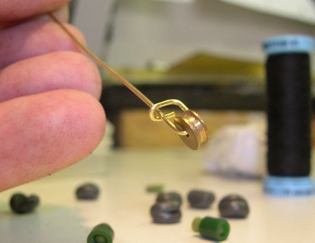

...a couple of days ago I made (with my friend ofcourse) a kind of weight compensation for the laser transport to solve the resonance and the free-friction on it...
Remarkable how it influences the sound for the better....by increasing the weigt you are able to "voice" ...it speaks for itself that this will continue as my final tweak....however I could not resist to build a more versatile crane for the final enclosure...:D
The foto shows a contraption made out of brass wire and a part from my miniature boating articles...quickly made to good use to give it a try...
The idea comes from Cees Pel (years ago) a very good friend of Wilco (VOID) who explained the boombox laser theory.
They have a 5 year further development of the Shigaraki on their resume..:cool:
