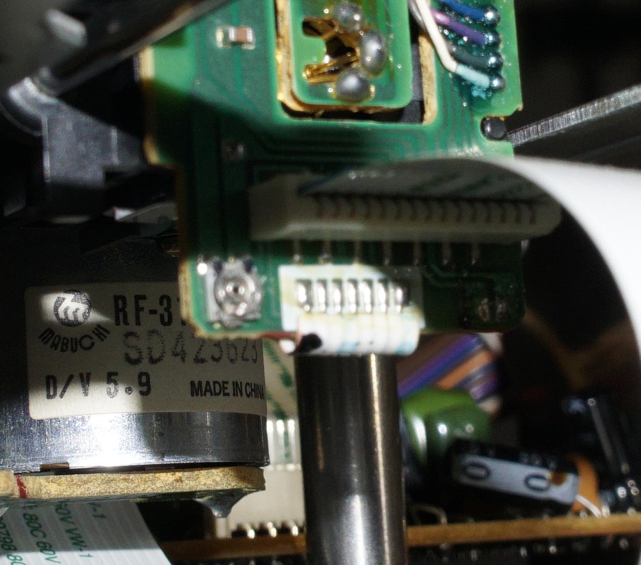

Finally, an affordable CD Transport: the Shigaclone story
You were correct, the Shigaraki seems to use the 15 pin version , see attached image .
Available from the same UK seller here .
Thanks again .

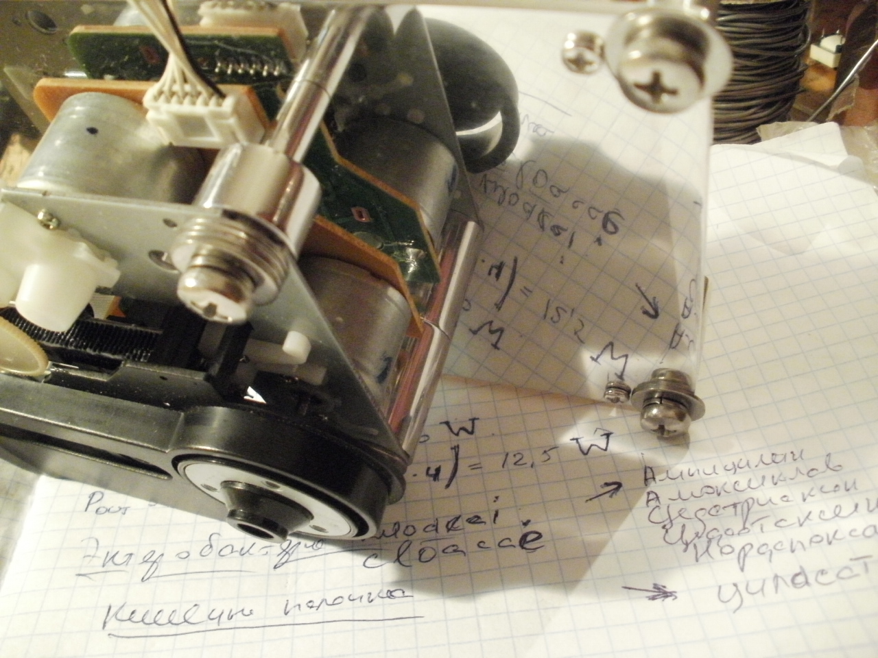

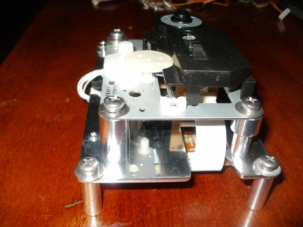

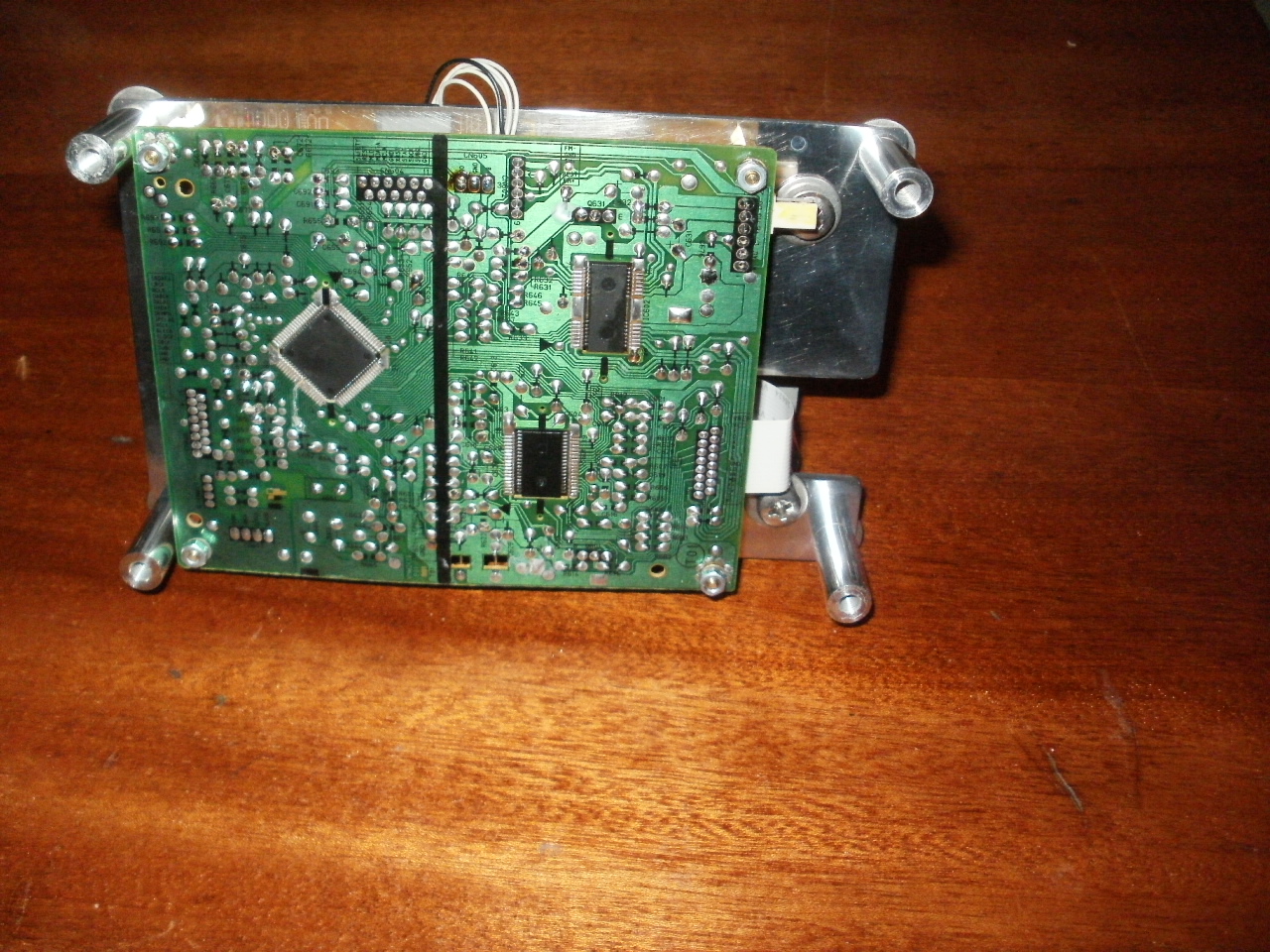

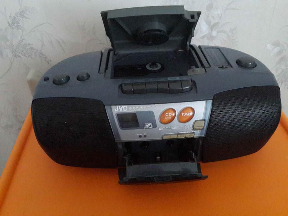

Hi friends!
So I got Shigaclon.
Bought for $ 7 JVC RC-X260 with transport SONY KSS-213S are actually one to one that SANYO S101-n 16 pin. Yet removes superfluous for normal switching power on and remove the extra boards and connectors.

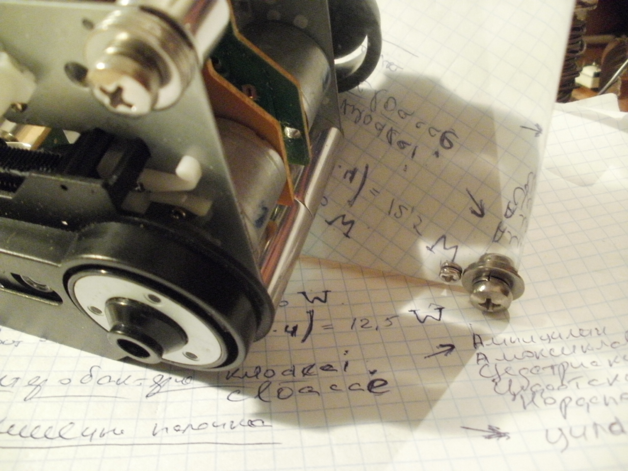

After a long time idle with this project I want to finish my Shigaclone I.
In the package once sent by Tibi loose contact pins for the connectors were missing. Since the connectors seem to be RM2 not RM2.54, I would like to have any infos about what connectors have been used and where I can get those.
C'mon apoopo, no need to rain on his parade like that :D

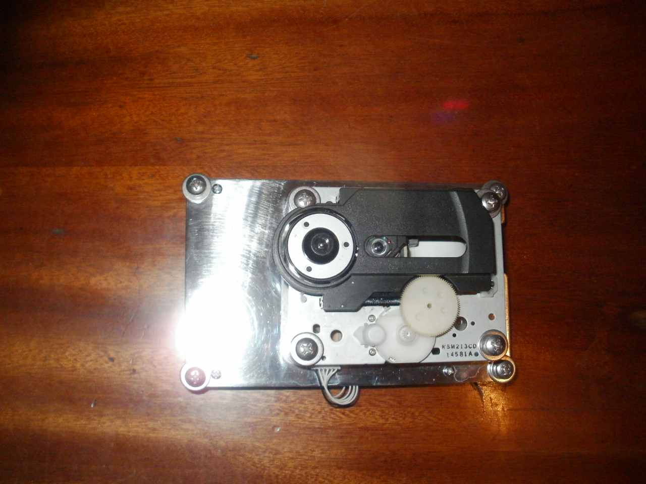

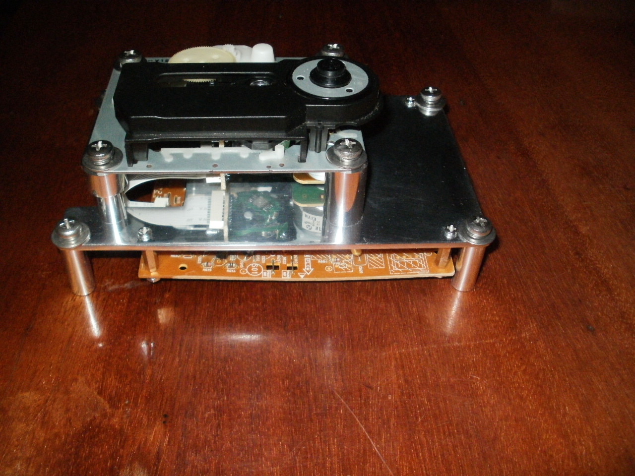

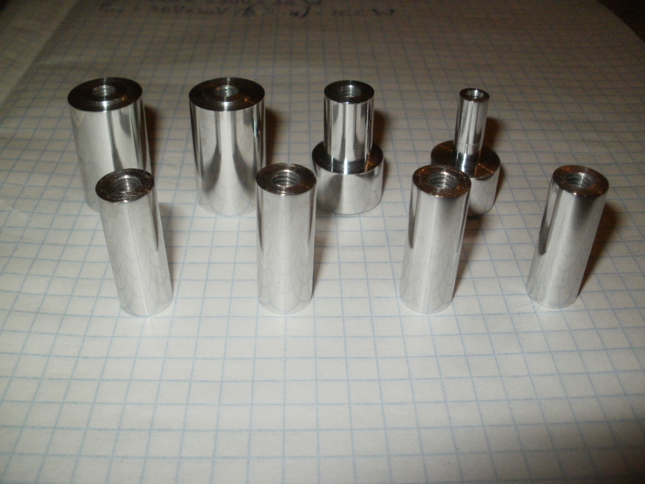

@amatti73 - Great job with the mounting hardware! Also try mounting the mechanism to the metal plate with just two bolts, rather than four. This will be an improvement sound-wise, and that is also how the original Shigaraki was mounted.
Another tweak I recommend is to get rid of the black plastic cover - it just sounds better without it ;)

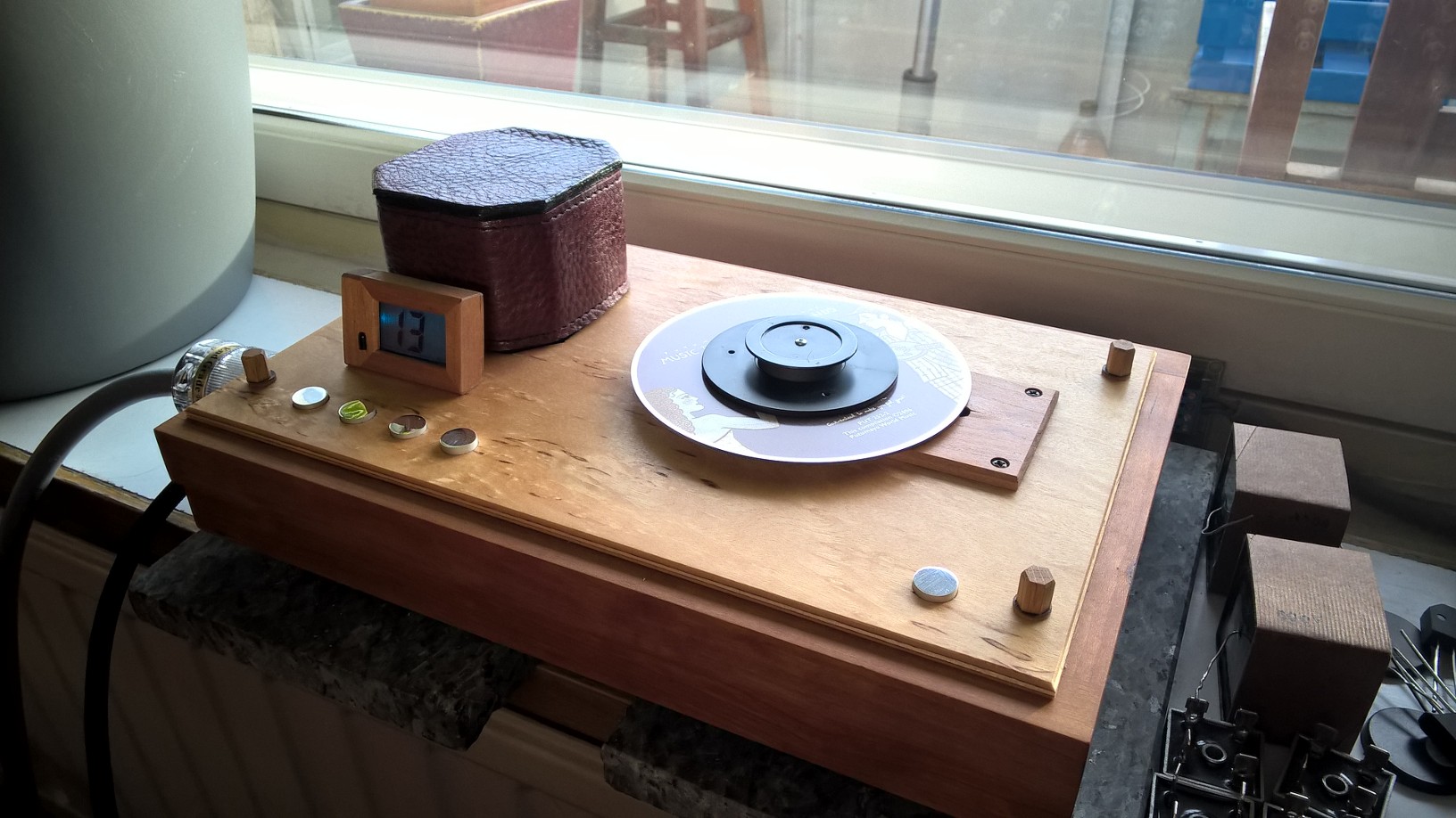

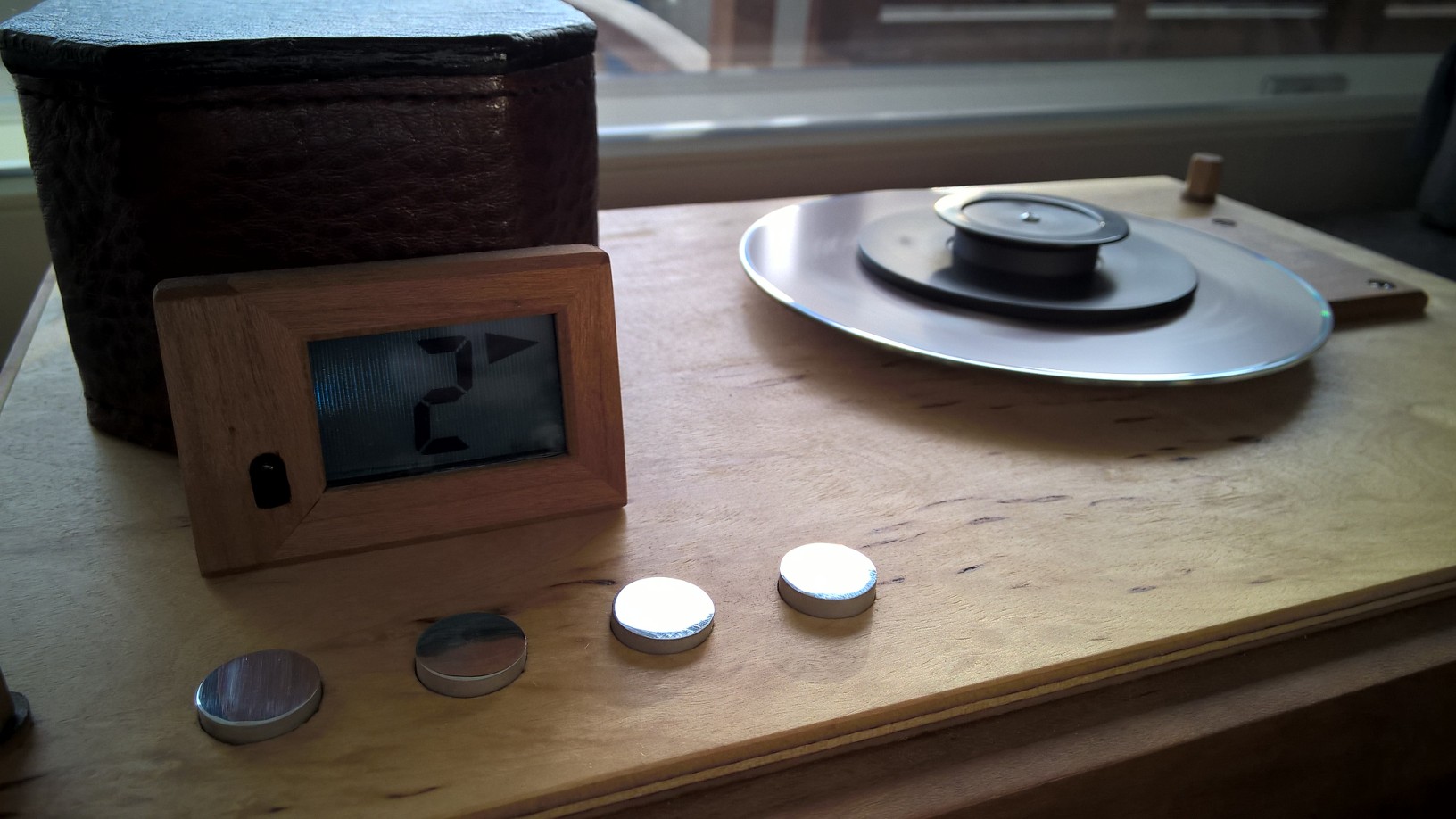

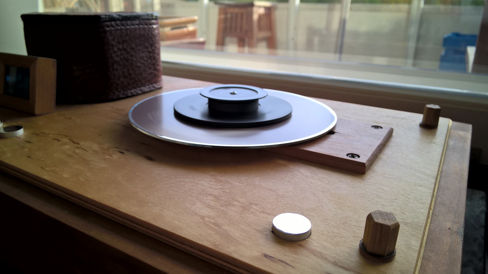

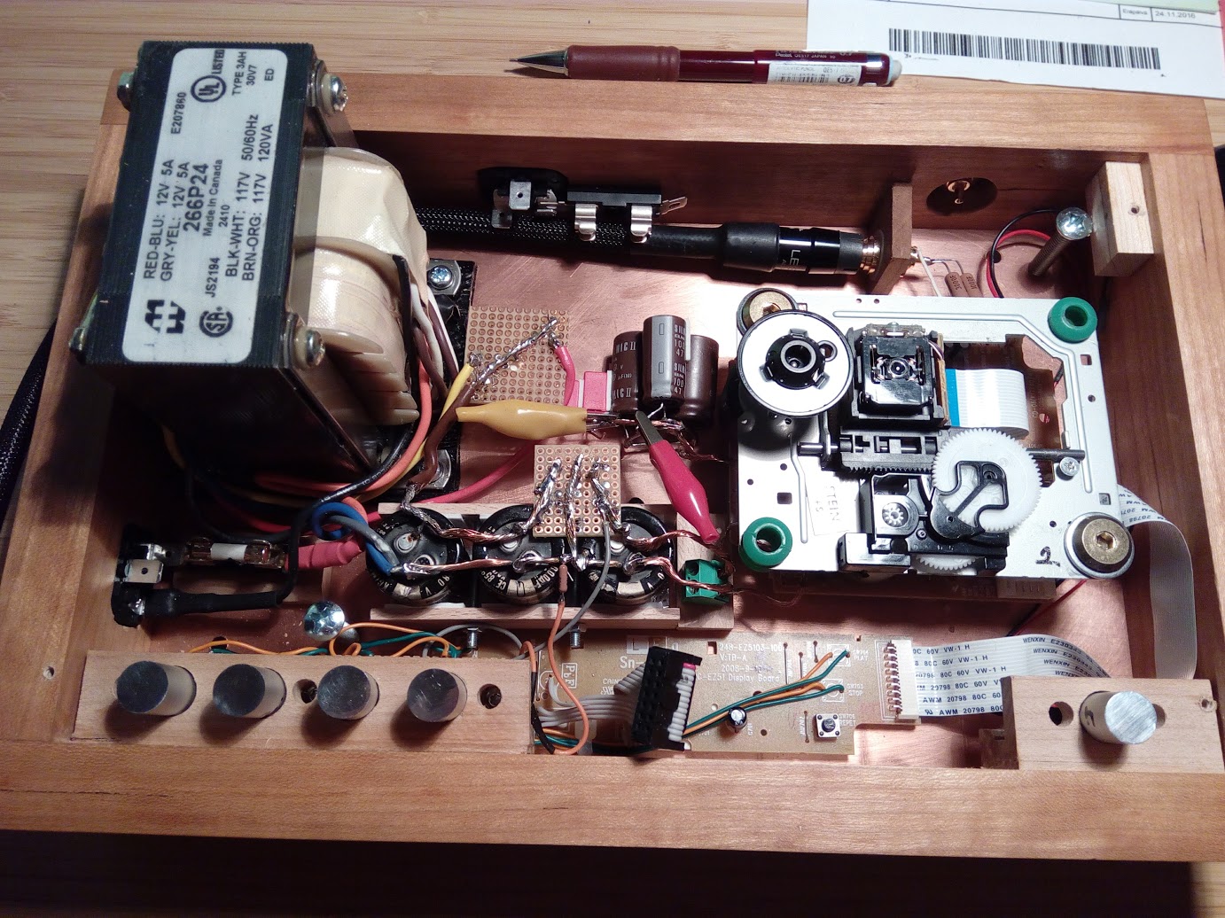

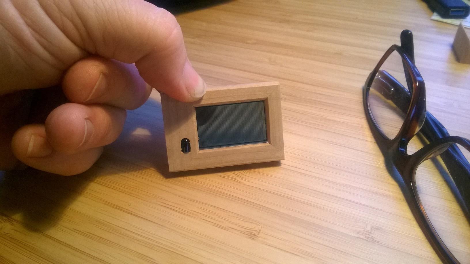

Got the second version of my DIY Shigaclone ready...
I quite like the outcome. :D
A friend helped make the leather transformer cover.:cheers:
