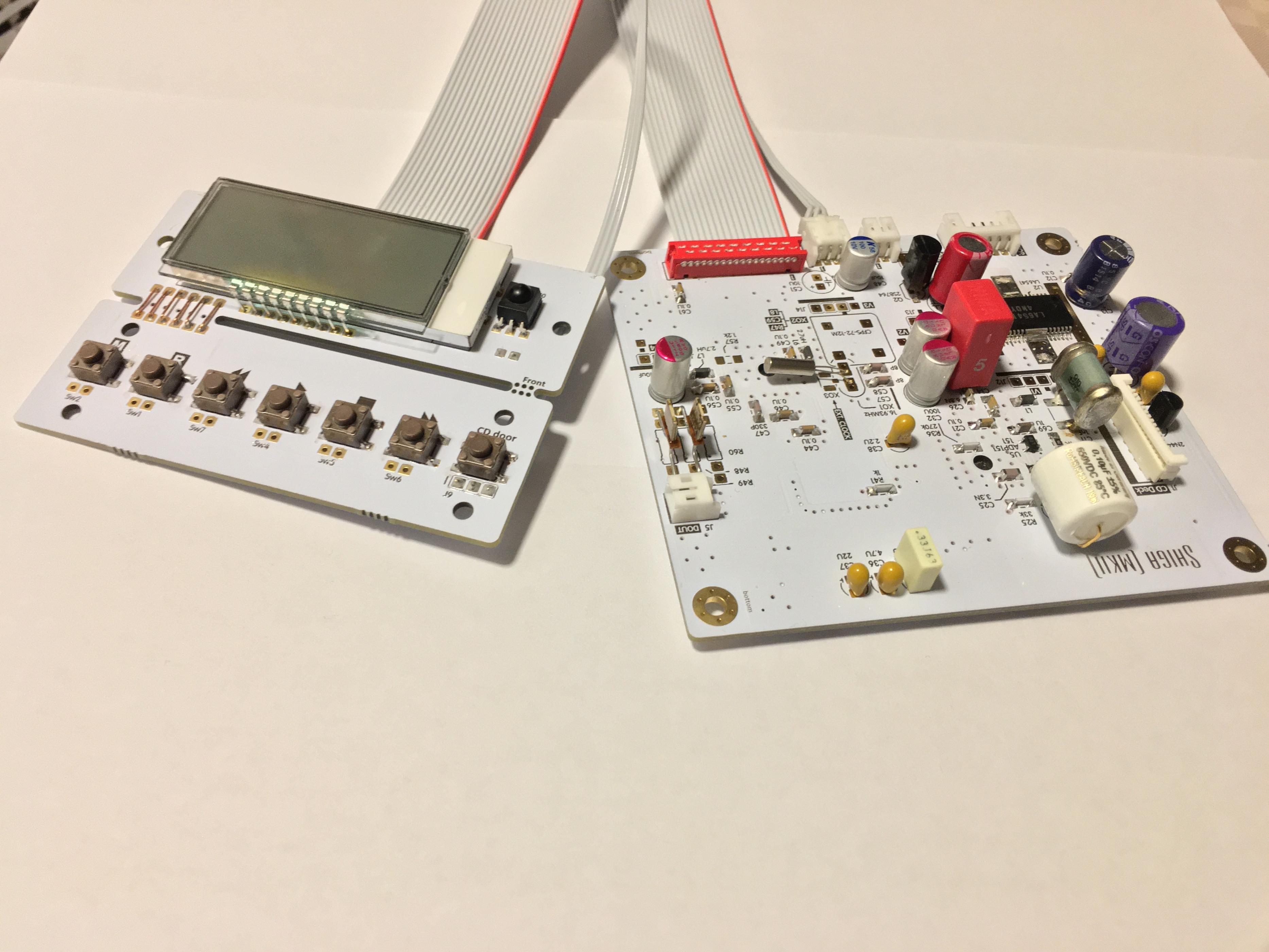

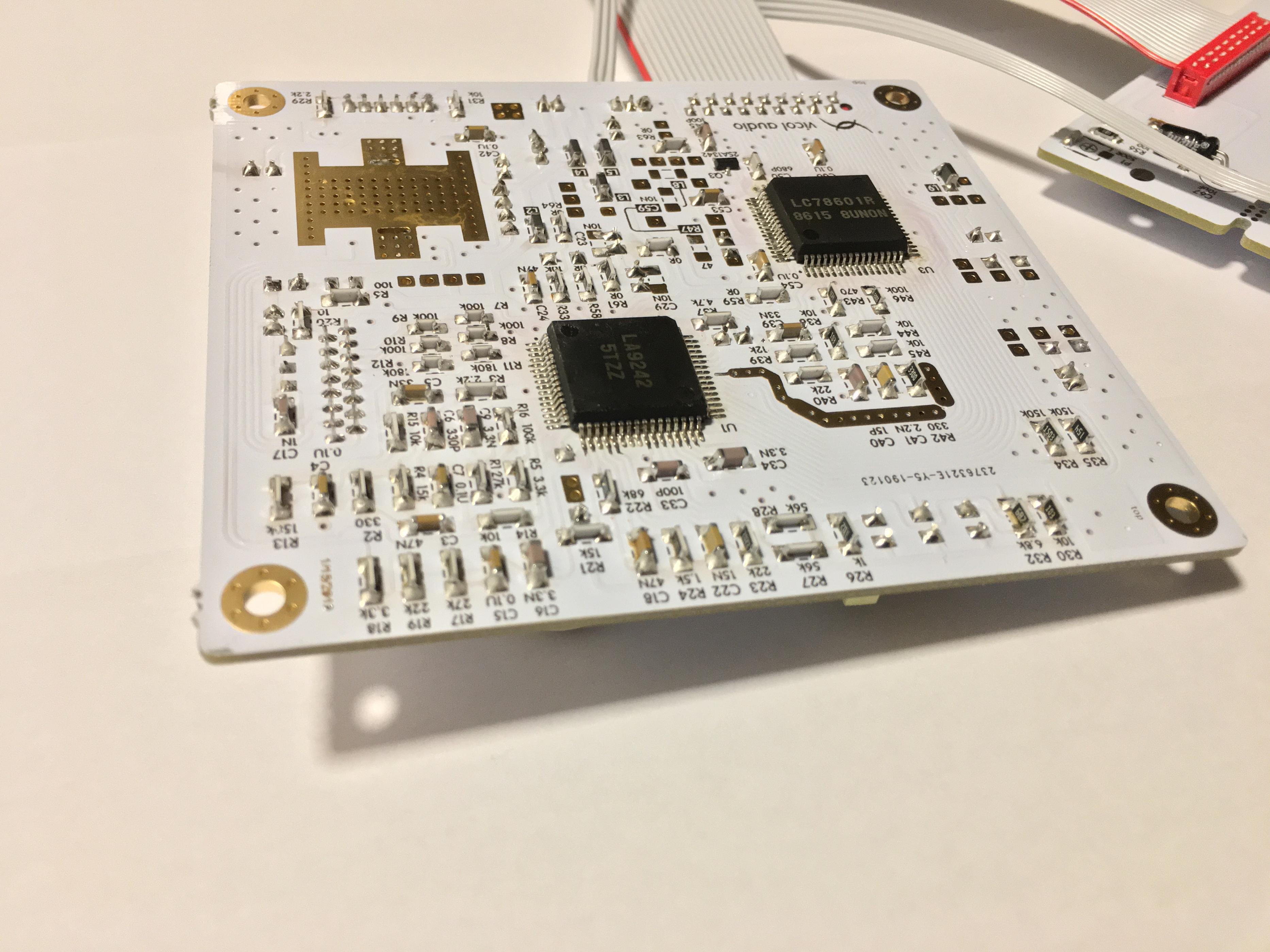

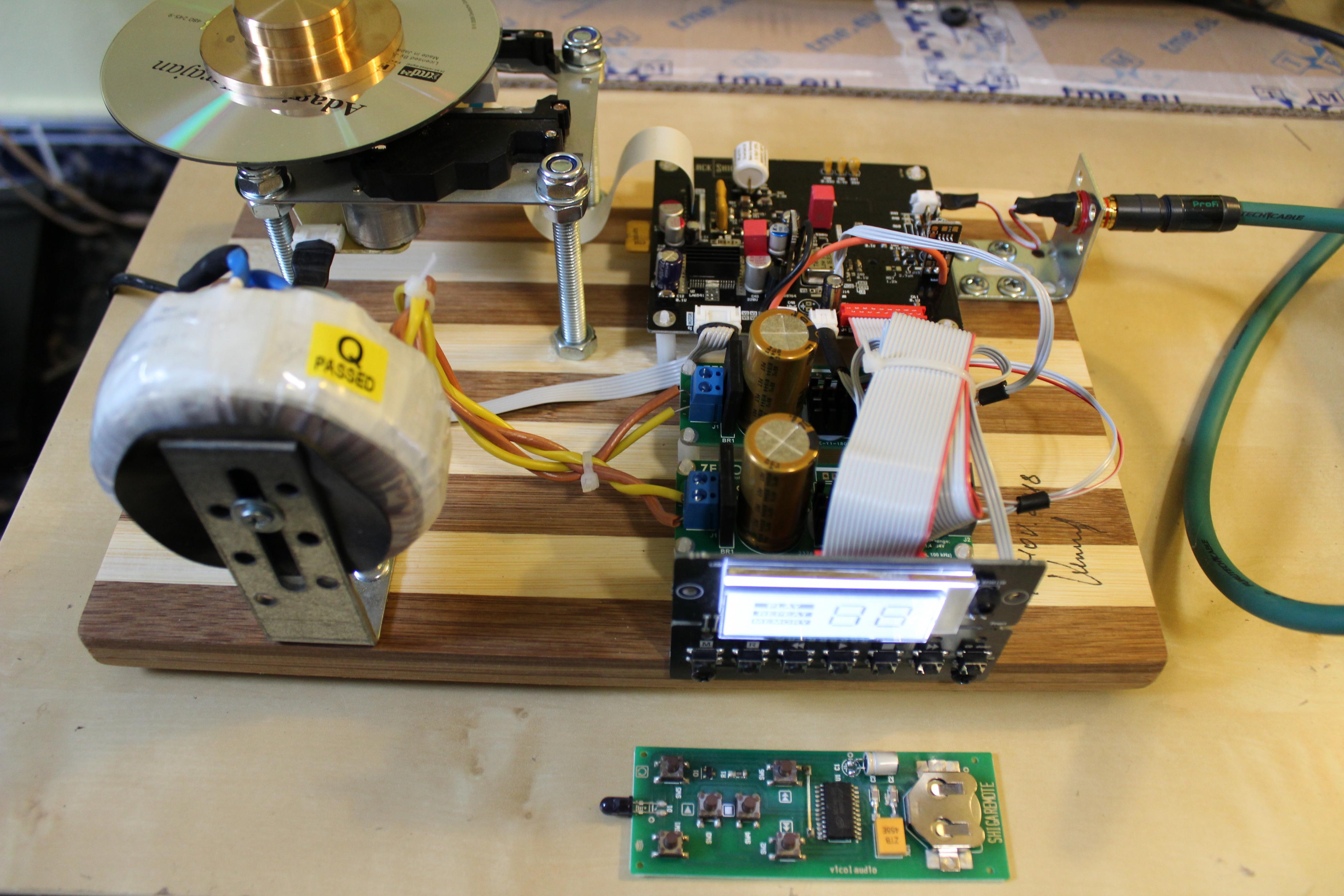

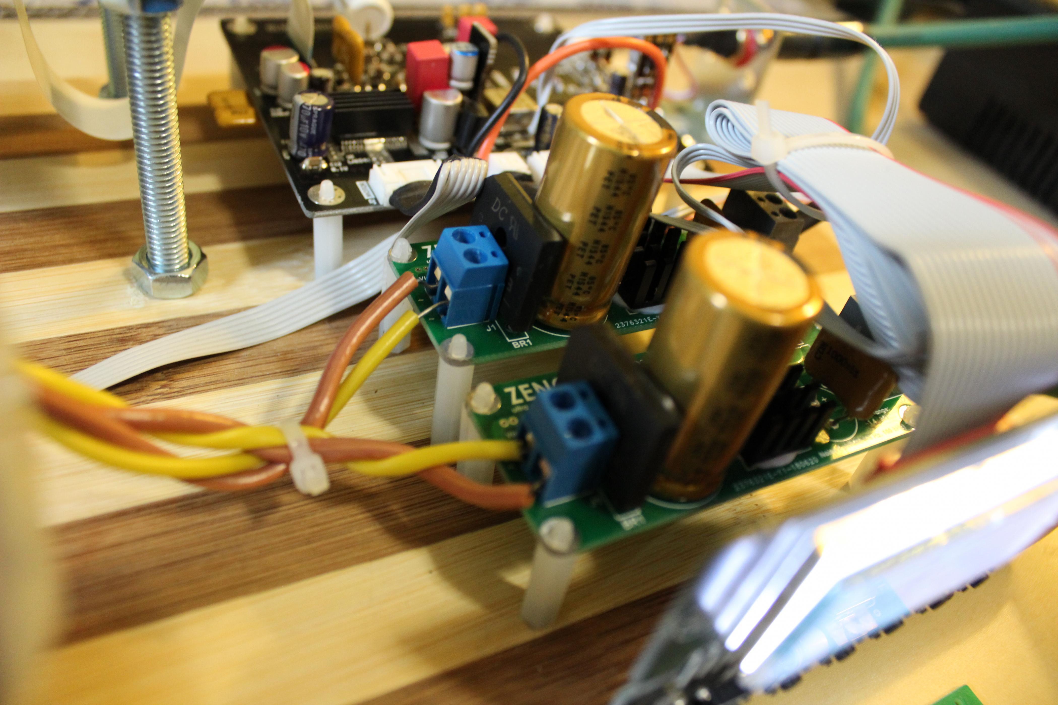

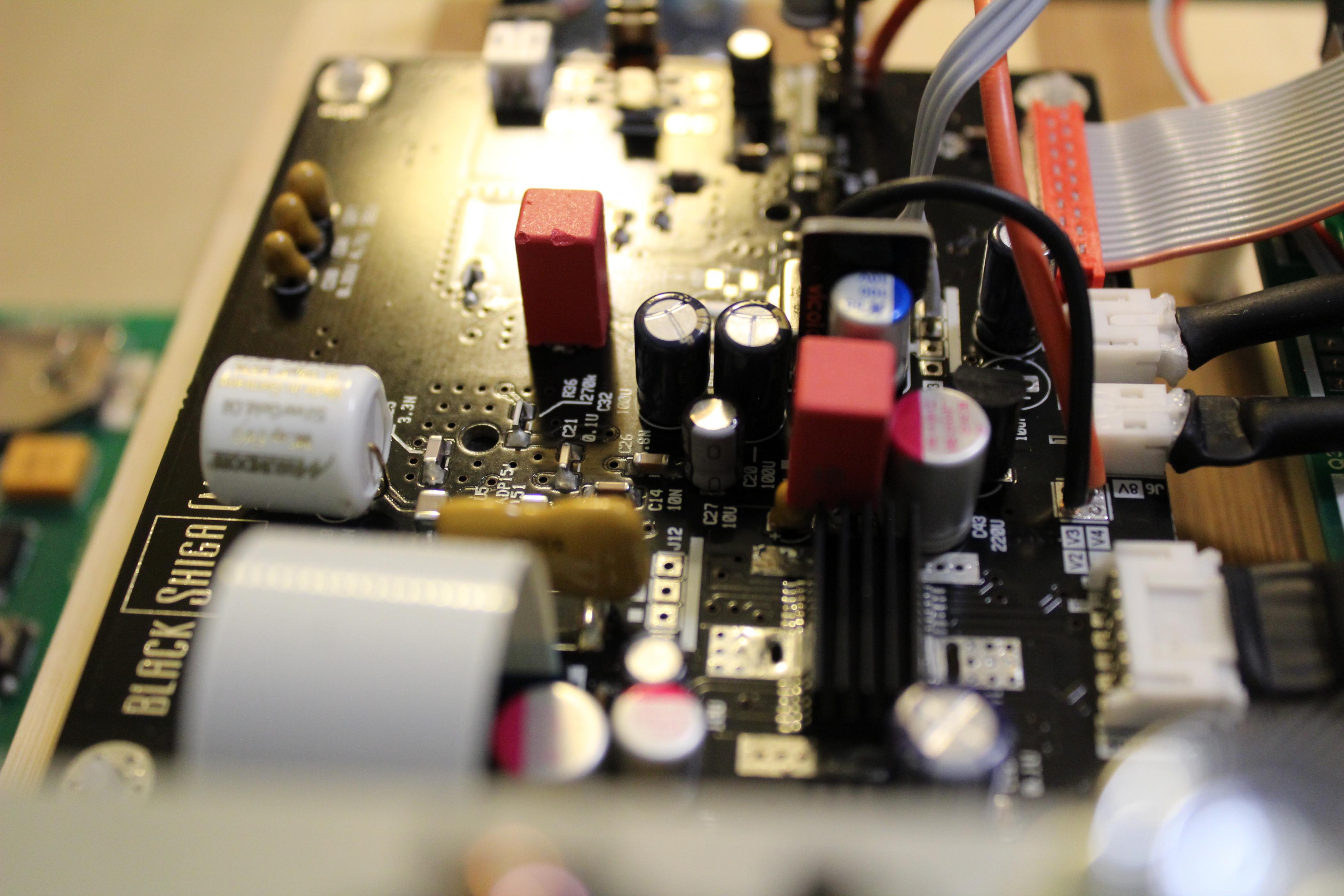

Shiga MKII high grade with Zeno low noise regulator
Anyone interested ? :) PM or mail me.
Moded CD mechanic.
Tentlabs clock with separate Zeno supply.
2 miniregs
Bronze cd puck.
Mundorf EVO Silver-Gold and Zfoil resistors.
Low noise PIN detector reference with ADP151.
Tibi

With the bronze puck my unit often struggles to spin up to speed enough to read TOC or play thereafter. Aluminium puck has no problem.
This means I have to manually give the puck a spin to help it along but this does not work all the time. I worry about the strain on the motor.
I’ve lubricated the spindle with some silicon based lube and will check this again.
Is it possible to increase the current a little to the motor or another way to give it a bit more juice?
Joined 2016
If I add add extra trafo (the same) and an additional Psu - both of which I have, will this allow me to devote one trafo/Psu to the motor to give enough oomph?
This should not happen. Shiga will operate perfectly with bronze puck.
Can you provide a picture of your implementation ?
Does your trafo deliver min. 9Vac at min 2A ?
Tibi
Joined 2016
Just tried with a vanilla mechanism/laser - all ok.
So will have to start the laser mods again. Ive long known the one I have been using was a bit suspect but I am surprised by the randomness and range of issues that that attempt at the laser mods has thrown up. I'll start with the easy (relatively) mods on the laser pins and trim pot and test to be sure they are sound before I go over to the more tricky ones on the tape.
Thanks for your attention.
Joined 2016
For arguments sake I swapped my previously modded laser to a new mechanism and this fixed all my woes?! Seems that the problem was not my soldering but something on the mechanism board itself - possibly one or more of the pins at the connector has got cracked as a result of many plugging/unplugging instances? Will have a closer look at some point. But for now happy to be back with the full monty of laser mods.

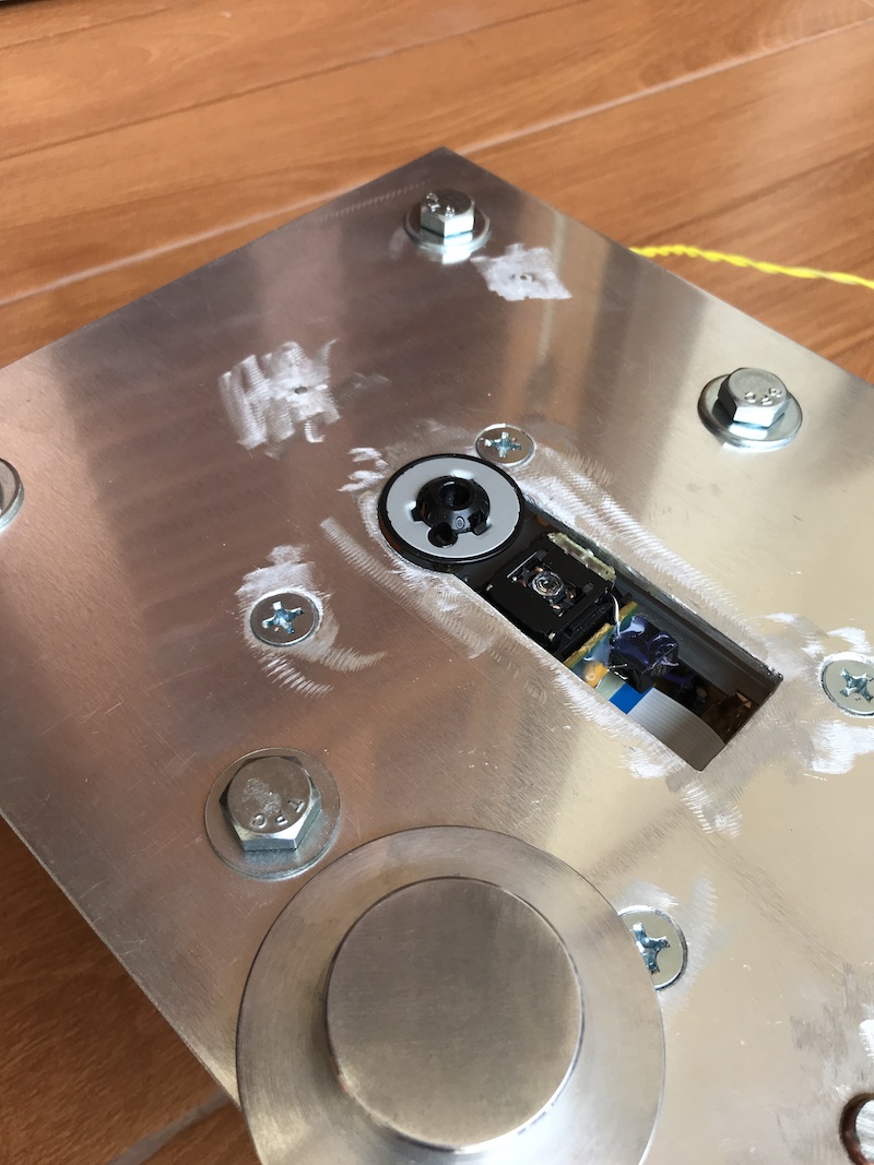

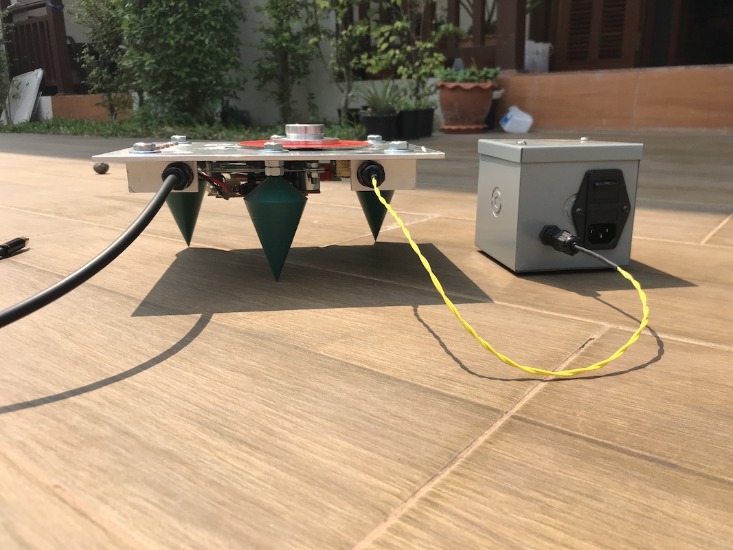

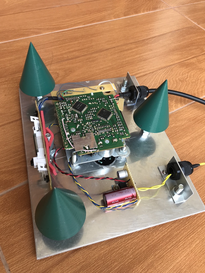

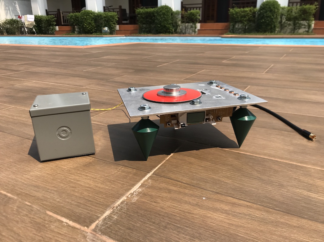

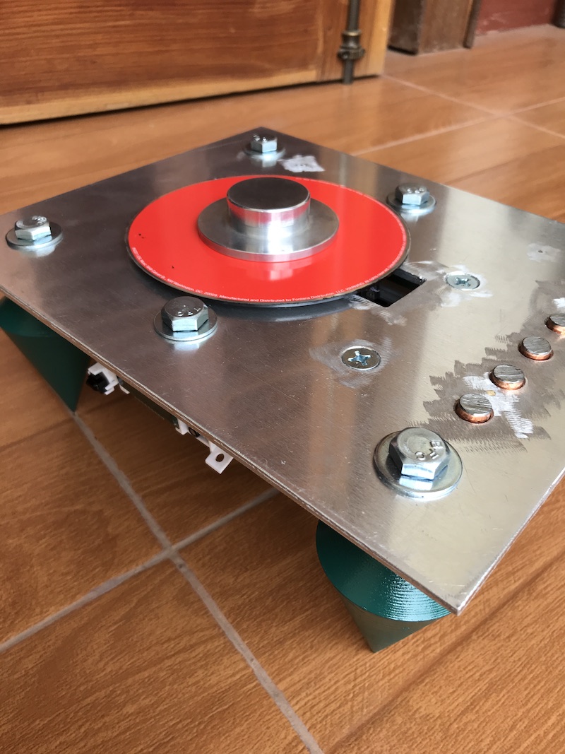

JVC RC-EZ51 Shigaclone
Had the guts out of the original boombox Shigaclone sitting around as they were redundant once I got Tibi's Shiga Black. Over the last 3 weeks I've had a lot of fun making this for my brother as a 50th birthday gift.
Very happy with how it turned out and this morning just solved the issue that I was having with CDs skipping. Just waiting for the NC tactile switch so I can wire in the TOC button - otherwise it is complete!
Except for the aluminium plate which was guillotine cut to order, the drilling and machining is all hand tools. At $2 each the 400g plumb bob feet are a great find and I am going back to the hardware store to buy out their full stock! (there is a smaller size that will look great attached to speaker boxes).
