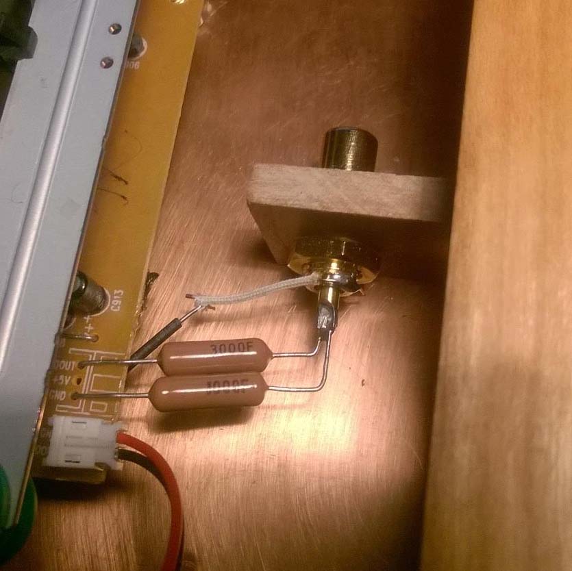

Hmm.. I made a new version of the Shigaclone as my first one stopped working.
It's about ready now and I tried it... Works just fine, just one little detail... no music(!)
This is the way the resisters should go? - right?
That else could be wrong?
OK - nothing exactly wrong... just not locking properly. I have the s/pdif cable coming in from the side of the cases (room restrictions) so I guess the power supply interfered with the locking of the DAC.
