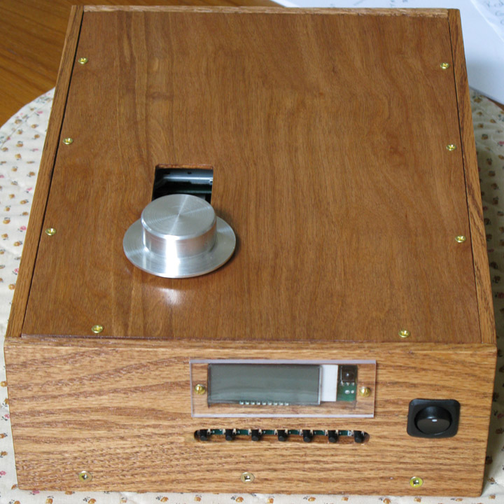

My stock Shiga is all done. I've been running it for about 30 hours now in my system. I won't say it beats my Proceed PDT-3, but it's surprisingly good for the money. Besides, this is going to be my control for the next one.

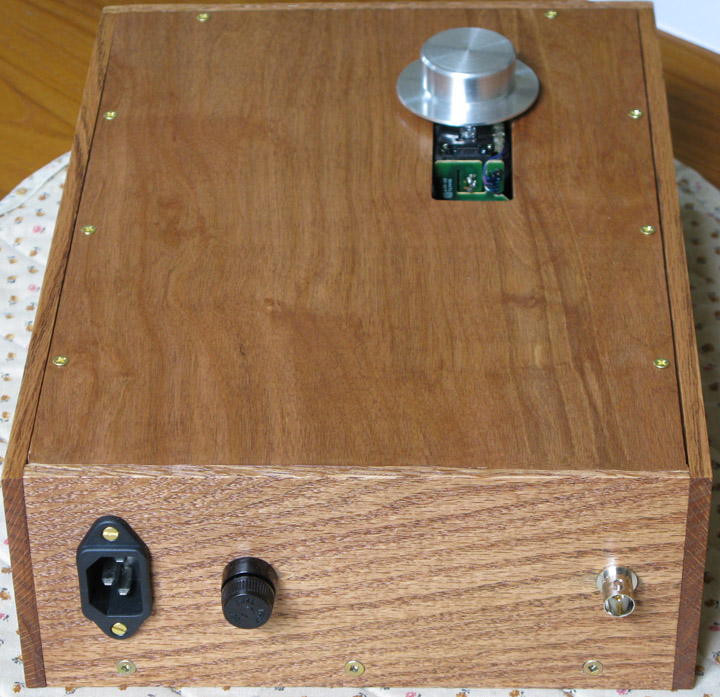

A couple of pics of the finished item. No, I'm not a very good woodworker , but I think it came out okay.

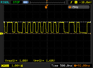

I measured the output of the shigaclone with my scope...
The input is indeed above the industry standard of 0,5V actually measuring around 1,6V peak to peak with the T pad in place. It s probably a bit higher with no shunt parts installed.
Which brings the required attenuation to around -10dB or a bit more if we account for the shunt parts that were present during the measurement.
In the output of my 75R 12dB T pad, the signal looks like this, which is far from what I was expecting to see...
The so called "square" sits at around 100mV peak to peak which is pretty damn lower than expected...
So perhaps we need to reevaluate a bit our thoughts about the attenuation needed? Perhaps digital square stuff behave quite differently than plain DC...? Perhaps we were looking at a completely wrong place and actual audio nirvana sits somewhere between -5 and -10db?

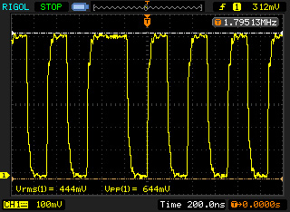

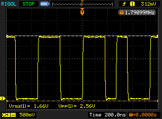

OK after a rough day, I m relaxing with some proper measurements this time... for some silly reason I did the previous measurements with the mid of the T as the ground reference...
So here we go:
This is the image before the attenuator. The peak to peak is actually 2.56V which actually verifies my fears that the DMM experiments were averaging the voltage a bit.
And this is the image of the signal after the attenuator.
It is 0,65V which almost perfectly 12db lower than the input Vpp, which also verifies that I did not screw up the attenuator and that I was talking bs when suggesting that high frequency digital signals could behave differently in that aspect than DC....
This also suggests that an attenuation of around 14.2dB will also be more appropriate if we are after the industry standard of 0.5V.
The rise time also seems a bit slowish. Seems to be around 60ns. Again, I wonder how could this be affected by an easier impedance load to the chip and how this could affect the sound.

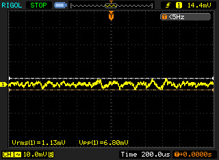

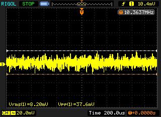

I have also measured the 7808 and salas outputs.
The 7808 driving the motors only seems to behave pretty well with almost 7mv noise... I bet I can make these go even lower with shorter and better motor cabling, and some caps in the spindle motor.

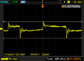

Salas seems to be having some trouble with the digital stuff though...
Peak to peak noise is about 40mV. I bet I can do better than that with shorter cables and some minor adjustments to the output caps
Do NOT add capacitors to the motors. That is another thing that sounds good in theory, but awful through the speakers. I posted about this a month or two ago, and Erik later confirmed my observations in this regard.
As for the cables, minimise their inductance (twist the wires or use stacked ribbon). Shorter length is indeed advantageous.
I intent to repeat the test with caps only in the spindle. My "theory" is that the diminish in sound quality was coming from the sled which needs to be really fast, but the spindle speed should be as smooth as possible and changes slowly only with the movement of the sled between tracks.
About the wiring I have some stuff planned. We will see...
