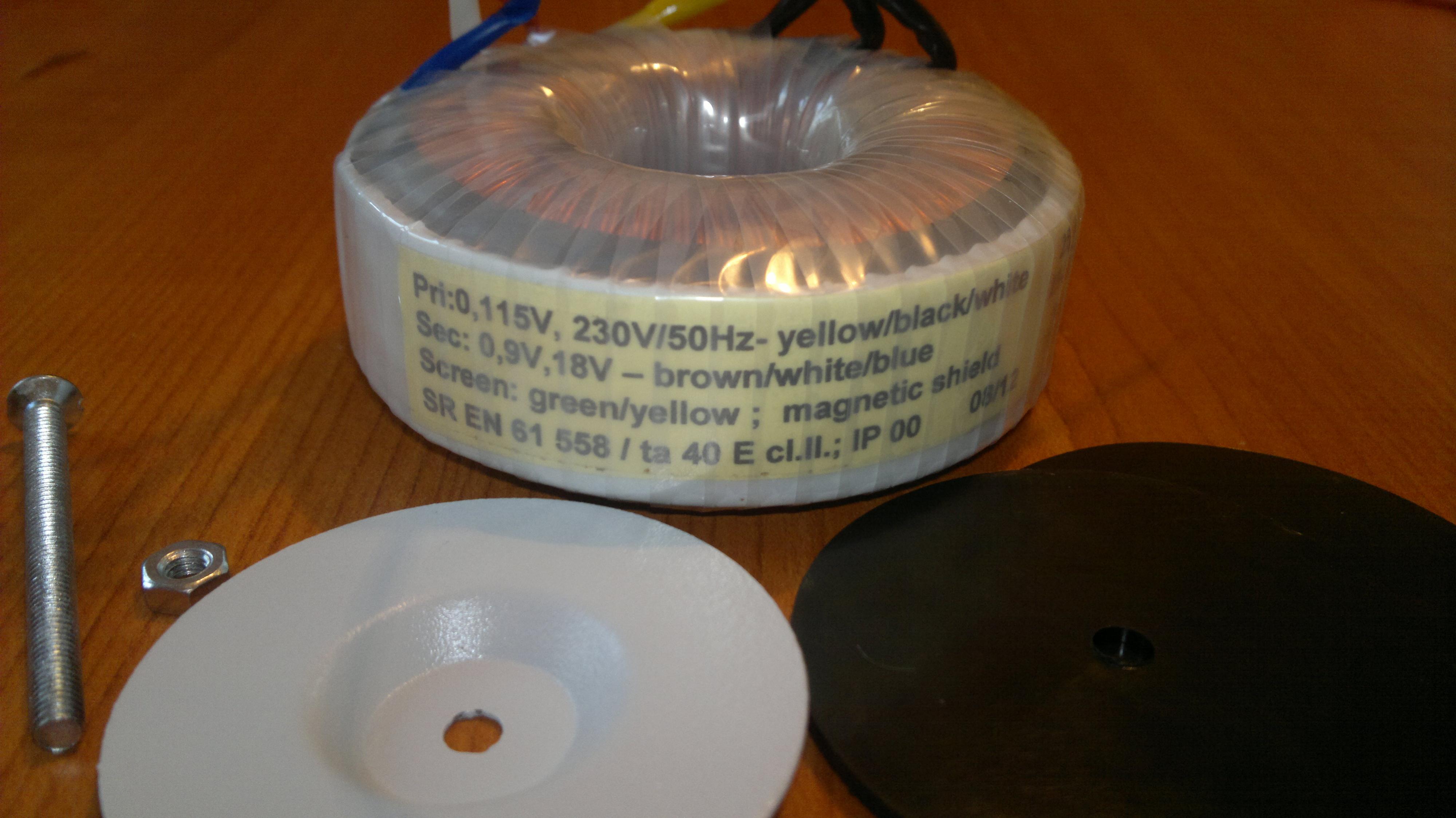

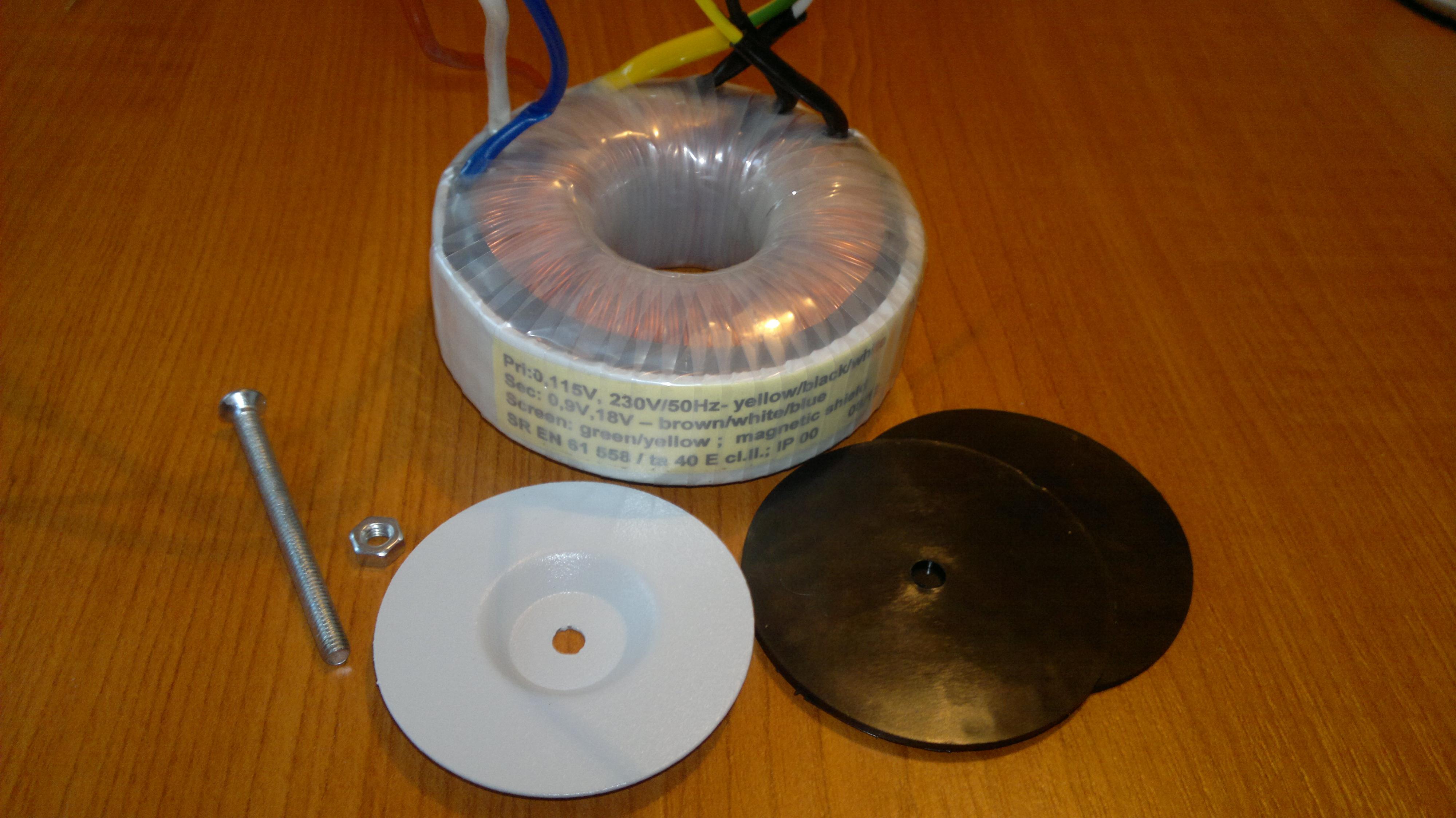

We have received the trafos from factory.
These are ultra low-noise with magnetic shield.

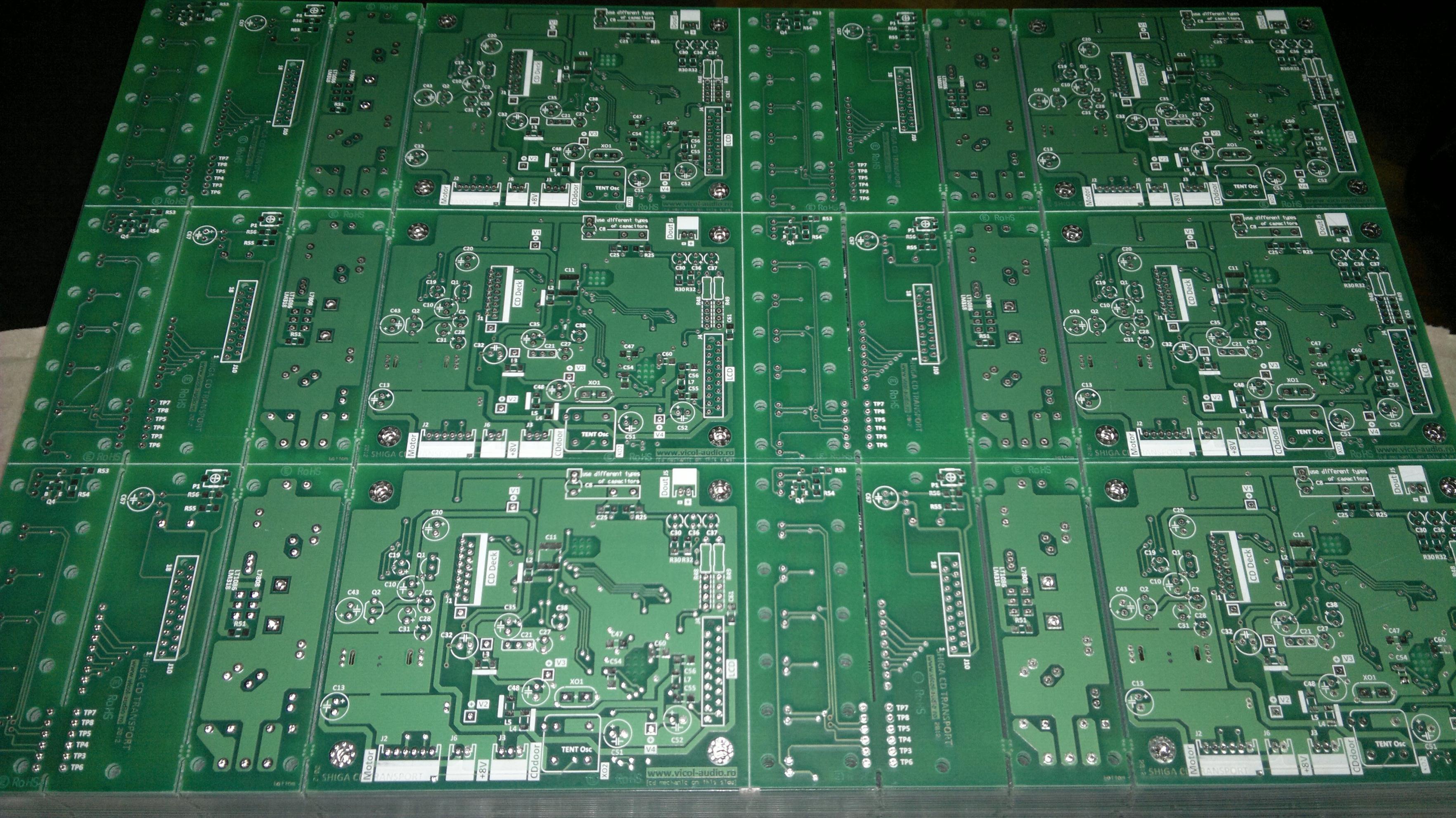

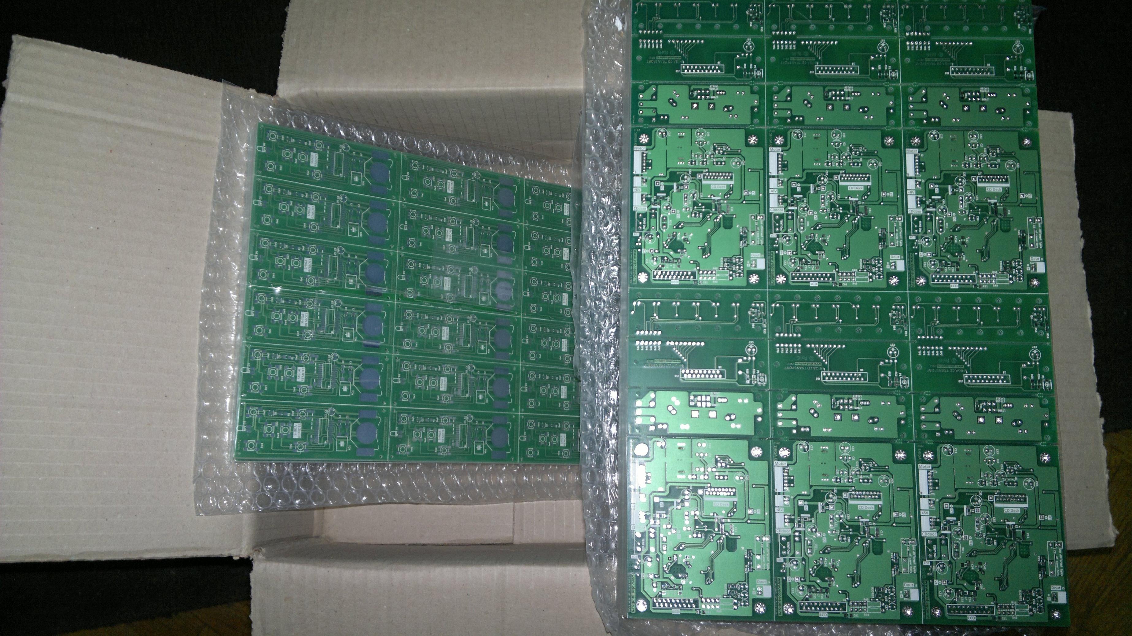

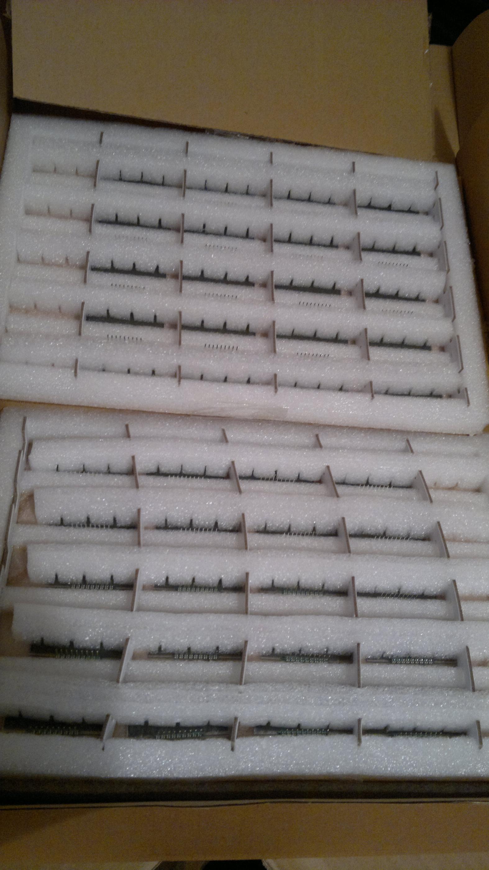

PCB board have been sent from factory and we expect to receive them today.
The good news is that remote PCB boards will be received also today.
LCD displays arrived in Bucharest and we wait for customs clearance.
Tibi

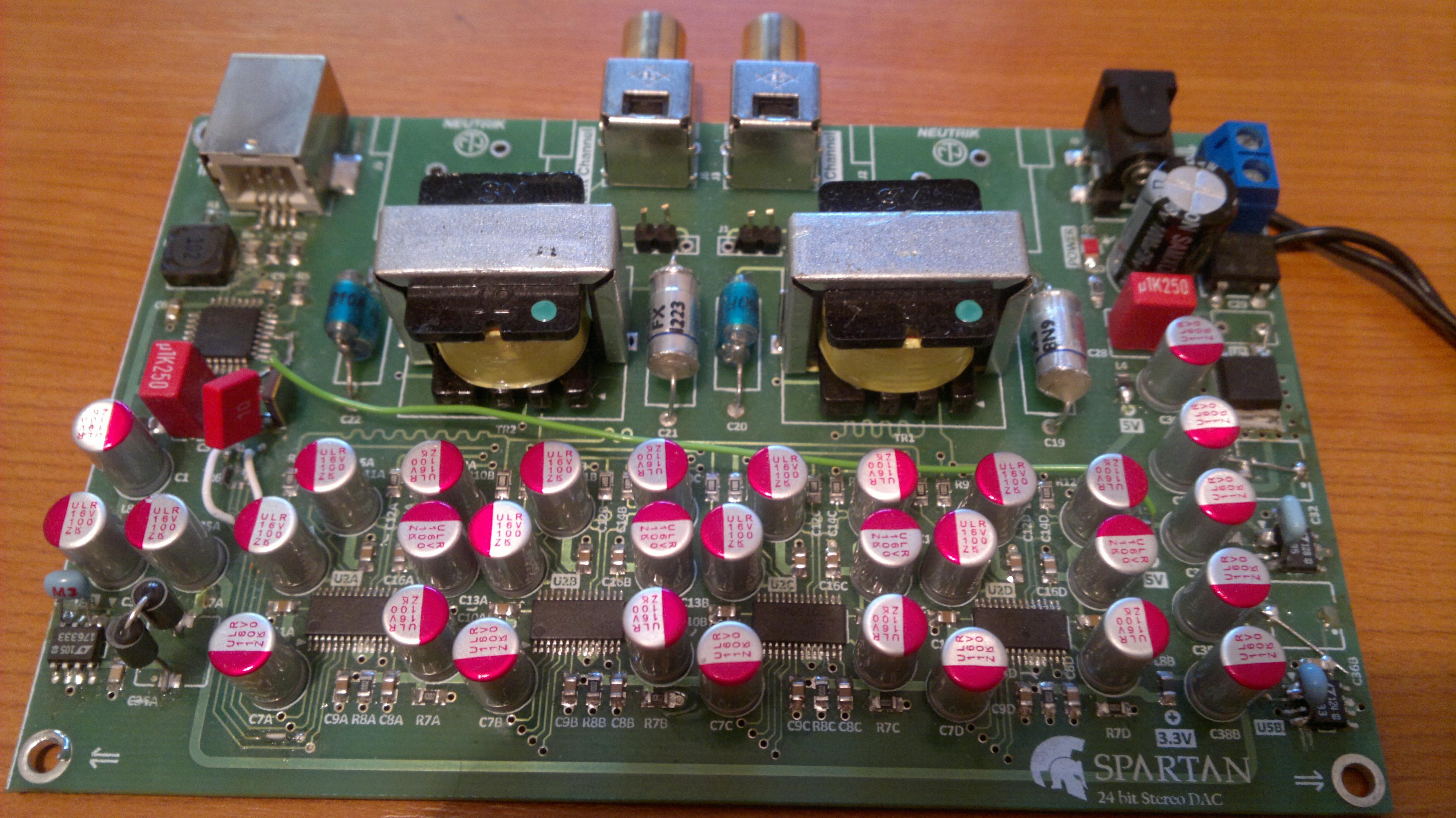

The boards arrived yesterday ! :)
We have also a puck concept and also a prototype. It is a very simple one.
Tomorrow I´ll post remote price as well.
About our dac. This is called Spartan and make use of 4 x CS4398 in parallel. Output is passive and use transformers.
This is a commercial product and was initially designed to be used in conjunction with a PC trough USB. We have customised a Linux distro to only 8MB . The goal was to reduce jitter and provide a constant data flow to USB.
Same dac will be interfaced with a spdif receiver. Pictures tomorrow. :)
Tibi

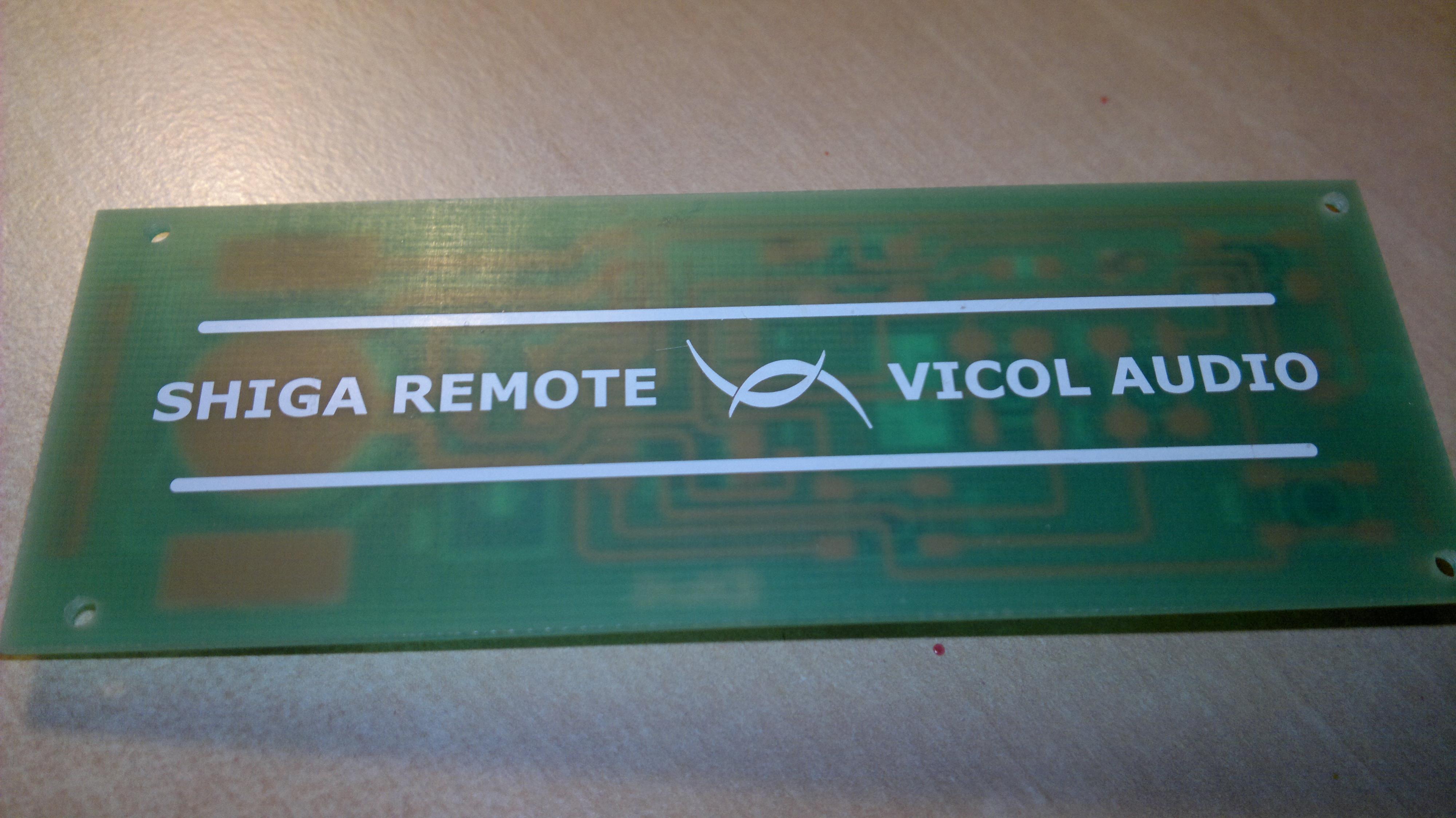

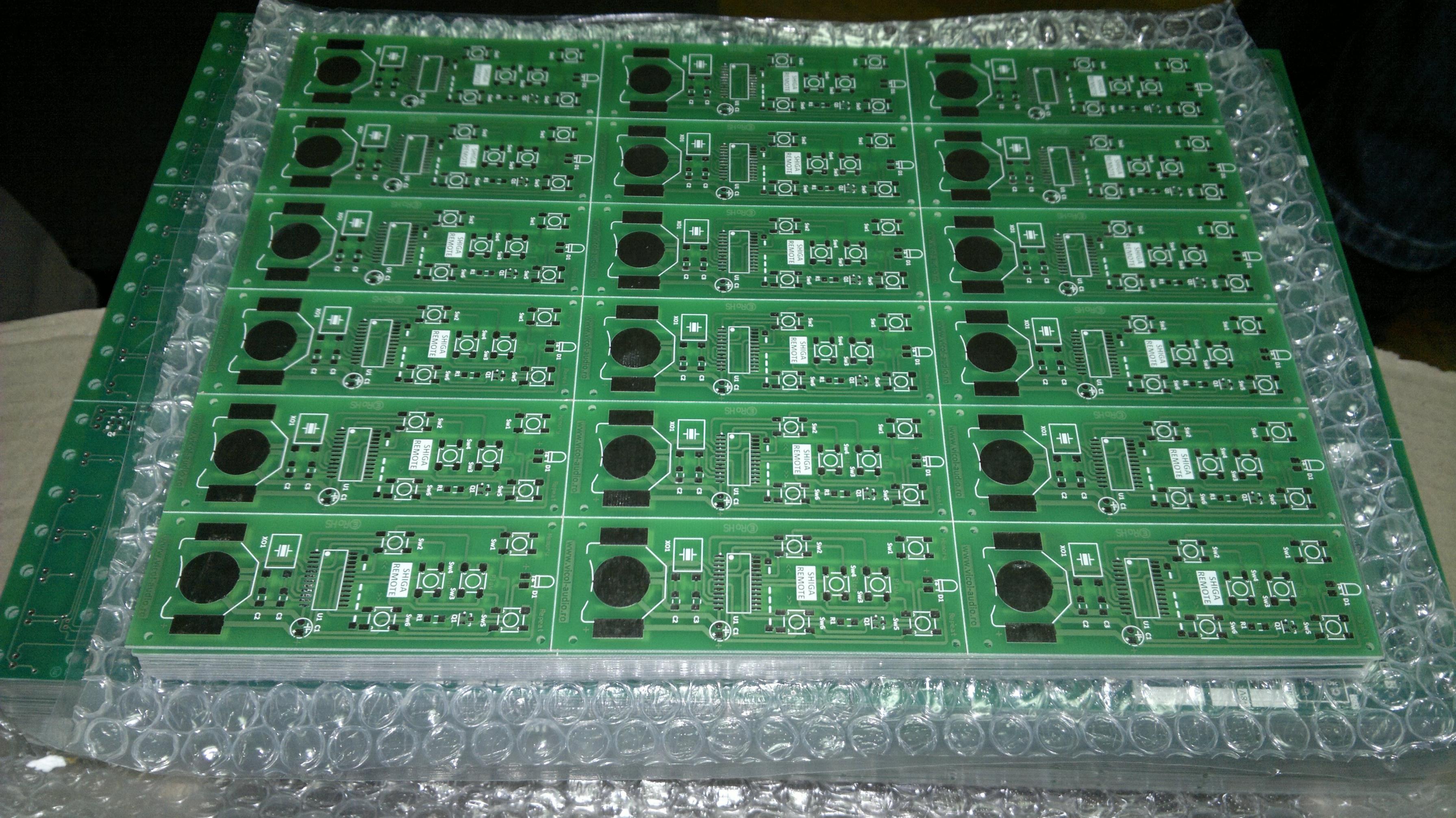

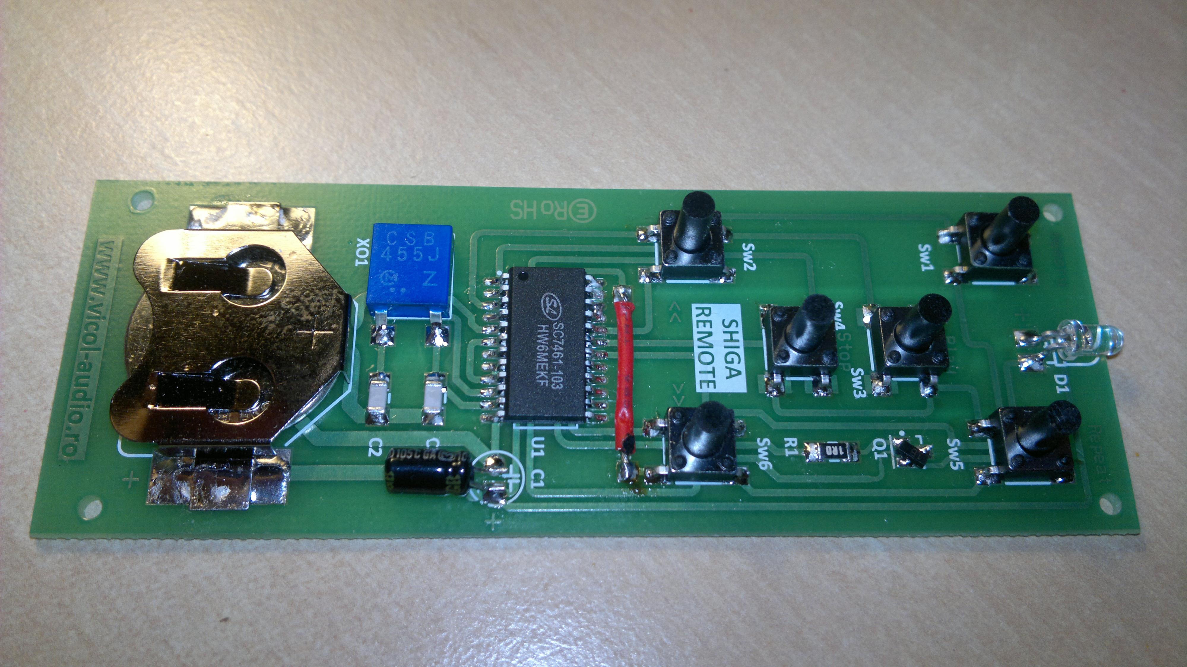

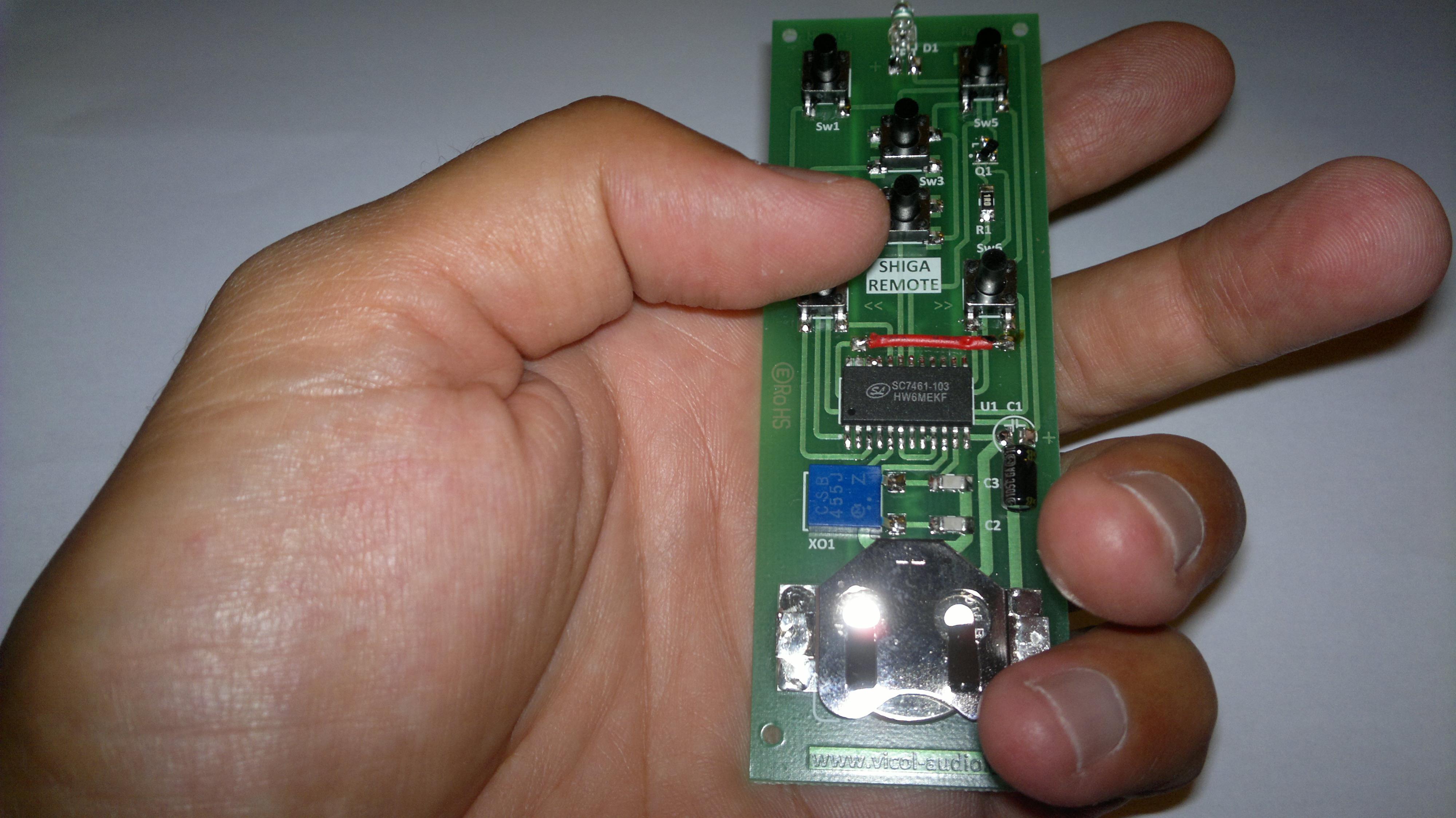

And here is a remote mounted.
Pcb was intentionally made single side, with no holes.
This allow you to make a box very easy.
Tibi

Infrared Remote options and prices
Shiga Infrared Remote options and prices are:
1. PCB + SC7461-103 10euro.
All needed components are listed in BOM
https://docs.google.com/spreadsheet/ccc?key=0AuQF0EAtUutedEhBYW9hSklhOEVmSERodi1xSldyUUE#gid=0
2. ready mounted and tested 29euro.
All interested please let me know which option you prefer, by sending a mail to sales at vicol-audio * ro , and I´ll send you an additional invoice.
No extra shipping will be added, only 3.4% paypal fee.
Tibi
