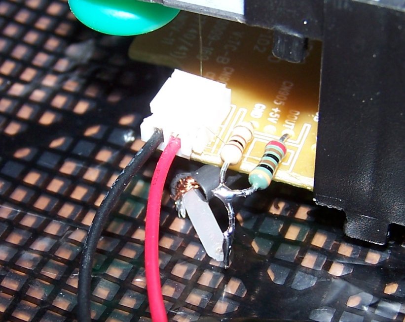

I too have just got a '51 - £9 from ebay, brand new, but with a missing tape door
One question/clarification I have (after reading through 40 odd posts today I think I know the answer, but want to check).
To put a signal through a DAC I have to connect A1 and A2 to a suitable D out socket. My understanding is that this bypasses the onboard DAC, but I'm not sure how it does this as the onboard DAC is actually in one of the chips.
Can someone please first confirm my understanding of connecting to an external DAC, and please try to explain how the internal DAC is bypassed.

westers151 said:I too have just got a '51 - £9 from ebay, brand new, but with a missing tape door
The DAC is indeed inside the LC78601, but you won't use it. You don't need to do anything to the internal DAC to be able to use an external DAC.
This IC has a digital output that only needs the signal level corrected to S/PDIF specifications.
That has been written a few times but I'll save you going through the many pages:
- on the CD-board (next to the connector for the door-switch) you'll find pads labeled GND, +5V and Dout.
- solder a 100 Ohm resistor on the GND-pad
- solder a 300 Ohm resistor on the Dout pad
- solder the other end of the resistors together
- solder the centre conductor of a digital interlink on this spot
- solder the shielding of the coax on the GND pad.
You can also choose to use a female RCA connector so that you don't have to chop up your expensive interlink.
Attachment: this is the spot you're looking for to connect your separate DAC to.
