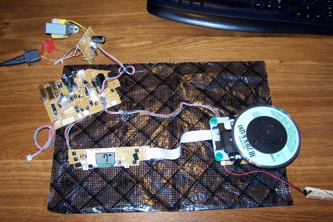

First, I want to say thanks to Peter and everyone else who contributed ideas, suggestions, inspiration, and details on this thread. We stand on the shoulders of giants!
I got my clone running yesterday. It's a bit rough and ready... still using the door-closing switch (just bent it closed and open it with my fingers when I load a CD as someone suggested), the transformer needs a cover, and I need to get some real AC wiring setup for it. Eventually I may also do some sort of cover over the PS and possibly the transport mechanism.
But it runs...
AND HOW IT RUNS! WOW! Now I know what all the fuss was about. The sound is very 'dense' and very heavily 'textured', where the buzzes, rattles, tinks, and all the other subtle noises of an instrument or voice come out and add a stronger sense of realism. And it still does a good job of keeping all the musical elements separately audible while presenting a good coherent 'whole' musical experience. It pulled me into the musical experience in a way my current rig (a professionally modified Oppo 970... which is no slouch!) doesn't even dream of.
And it's not even broken in yet!
Ok, now for some questions for Peter...
1. In your latest creation, did you find it necessary to remove the chip bypass caps on the bottom of the board towards the center?
2. Also Peter, did you find much difference between having the digital out Rs at the board vs the jack? I've got them at the jack and initially set it up with the 75R/75R from your original build (I'd ordered them back in the spring), but I'll be trying the 300R/100R to see if it sounds better with my setup.
3. Have you tried the delrin clamp with the new setup? If so, how'd it sound?

Hi Greg,
I only removed 2 ceramic bypasses, the ones that were with 220uF and 470uF caps (and choke). I didn't touch anything else as it sounded good to me as it was.
I noticed slight improvement after I cut off RCA jack on my cable and soldered wires directly to a board: more immediacy in a sound.
I didn't try that clamp on my recent transport as I have only one clamp and taking it off is a major problem. Custom clamp is fine, but not really neccessary: the result is rather subtle.

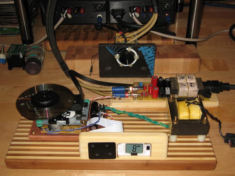

Gotta love direct-wiring. You likely cannot see in my poor photo, but the SPDIF cable is hard-wired into your NOS DAC's input... along with the cables into and out of my jury-rigged ladder volume control AND the speaker cables to the speakers.
I hardwire as much as I can... cheap improvements (actually cost-effective as I save on expensive connectors!).
One aspect of the sound through the Shigaclone and NOS DAC that I neglected to mention yesterday is something that will make sense to vinyl junkies here, especially ones who were around in the late '70s/early '80s... a 'Direct Disk' sense to the sound, in that there is an improved sense of immediacy and intimacy with the sound, just like a direct disk record is to a regular studio-produced record.

My Shigaraki is almost a year old now, and is modeled on the original design Peter came up with.. I used all Black Gate capacitors and a very big overkill psu with LM7808 just for the mechanism. Uses most of the rest of the ideas where applicable - what is different is that it is based on the RC-EZ32 and shares more features in common with the actual Shigaraki than most clones. (Micro-controller is on a separate board and the display is slightly different- displays track and time, although not simultaneously.) The mechanism is supported by two heavy aluminum stand-offs on an aluminum plate that is mass loaded with 3.5kg of bronze, overall mine weighs in at about 6kg. The mounting technique was very audible as Peter said and the additional mass helped as well. There are some pictures of it in this thread, it is far from the prettiest of the lot as I have very limited metal working resources and skills. (Electrically it is very good.)
The quality of the spdif signal looks very good, good open eye pattern, no ground bounce or noise present. I've not really seen better, and I have seen much worse. I have no way to measure spdif jitter or link vswr unfortunately. (I did work very hard at making everything a real 75 ohms from connectors, internal cabling, external cables, to termination techniques.)
It sounds really good, but I have better sounding sources yet which is what I was hinting at, these are not however CD based. I think it would be hard to do a lot better without expending obscene amounts of money. I expect Eric's version to better mine in significant ways due to superb quality of execution and the additional effort he has put into optimizing things like power supplies, shielding, and mechanical issues I barely touched by comparison. (I'll bet he has spent at least 10X what I spent on mine when you factor in time and materials. )
I do think it was money well spent and at some point I would like to build another, perhaps one based on one of the Sanyo boom boxes recently mentioned.
