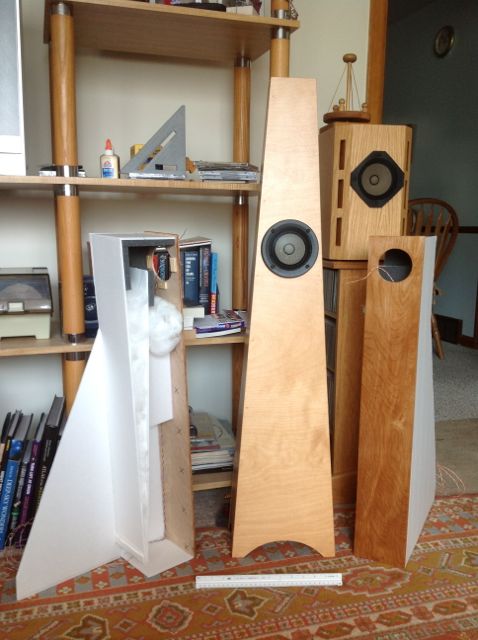

Thanks! The bottoms will be foam core. I went for straight lines so that if I get ambitious later, I will be able to cover the sides with veneer. Top will get another piece of 1/4" ply.

Yes indeed. Sure-Ply scraps from the Cornucopya build. Don't know why, but Sure-Ply is cheaper & better looking than the hardwood veneered 1/4" ply that sits next to it at the local Lowes.
For finish I used some leftover Minwax Polyshades pecan color polyurethane. I decided to go a little darker than the clear polyurethane I have been using on the red oak (which I typically use).

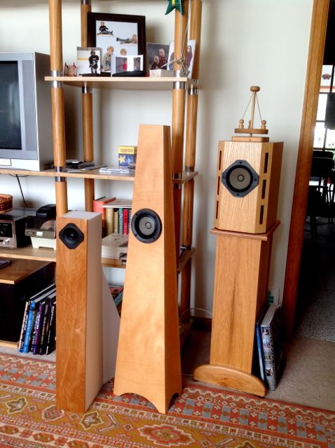

They’re finished! Photo below, again with the small Metronomes and Fonkens Prime for comparison.
Only about 10 hrs on the drivers, but they are sounding rather good. Listening to Miles Davis ‘Round About Midnight at the moment. Pretty good sound stage, smooth mids and decent highs. Instruments are well separated (articulated?). The ambiance of the venue is well presented. When listening to NPR news, you can hear the differences in microphones and environments as they change announcers and locations.
Are the Vifa TC9FD as good as the Fostex FF85k? Certainly not! But for less than $12 per driver, I’m plenty satisfied.
I have used BSC on many of my single driver builds, but none is needed here.

While they do produce bass, it’s not what would call clean, articulate and powerful. I note that the enclosures vibrate rather severely--even the baffle. Not too surprising since they are foam core construction, and the baffle (while plywood) is very thin. I suspect that a proper plywood build would yield better performance and be well worth the time and expense.
Executive Summary: A fine speaker if you listen to jazz or small group type music at moderate SPL. If your favorite is Mahler’s 8th (Symphony of a Thousand), then think bigger, much bigger.
Mr. X: Based on this experience, I would say, don’t bother building a Metronome with the TC9FD. The FH3 style enclosure has the characteristics that I like in the Metronome. Probably not surprising, since the acoustic properties are so similar: long, tapered air column with the driver located near the mid-point, port near the floor (and not on the front), and baffle about as narrow as you can get. My thanks for posting the plans for this project!
