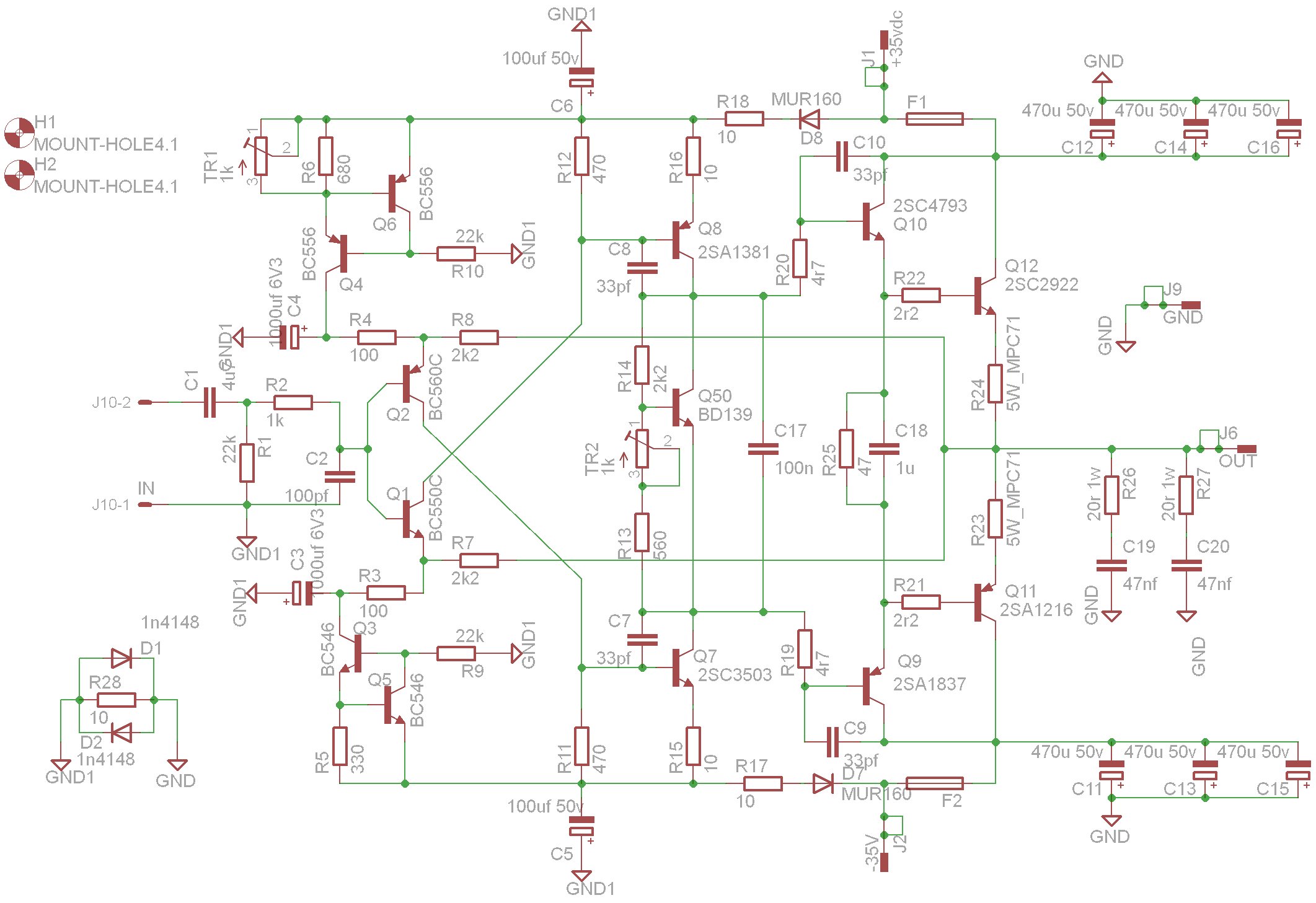

FET-hex explendit amplifier
1. Set 1k trimer at max value, set offset trimmer to get 330R all together with 680R resistor (they are parallel)
2. Power up the amp with +/-35V (or similar voltage), you can use 10R-22R/5W resistors in rails for first run and setup
3. Set up offset at first close to zero.
4. Set up bias trimmer to get around 22mV across 0,22R emiter resistors = 100mA
5. Check and correct offset trimmer again.

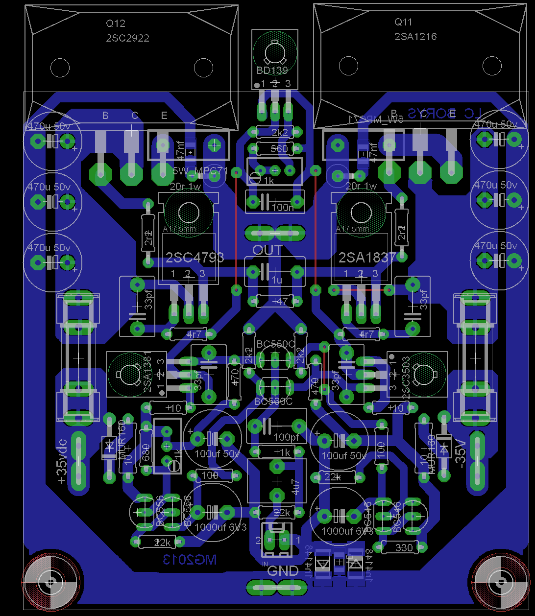

I have enough room on my board to place 18mm diam elco near output BJT. Do you see an advantage to swap from 1000uF to 2200uf?
I rearrage the board by turning VAS transistor the other side so that pad are facing the middle line. I could reduce starps number for 5 to for 4.

Very nice layout !!!
The cap near o/p transistor is very good to have it.
1mF vs 2,2mF - I do not know If there would be audiable difference but I have done some tests with 1mF and is doing the job fine (panasonic fc 1000uf/10V in my case)

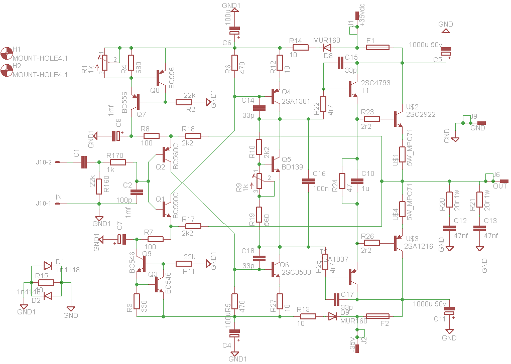

I was not speaking from those in input section but those how are on power supply rail near ouput BJT. In your schematic you put 2x470uf that replace by a 1000µf due location and place available.
Marc
Marc
Better is to put two small caps (lower impedance) than one bigger but in this case it prapobly will not make a huge diffrence. The caps are after fuse - so pulse response and impedance are more important tha amaunt of capacity.

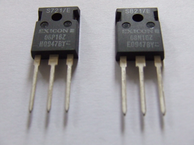

Today I had few spare minutes and plugged in latfet version of the amp. The only difference at the first is the bass, I do not know why but I feel stright away that is not that powerfull as with bjt and irfp. The best and strongest bas kick is with bjt wersion, but irfp version looks like has deeper bass anyway.
When I will have more time I will do A and B test for comparasion (but the bass is audiable stright away).
You right about that.
The main reason I do not want to give up these topology with the power darlingtons even do I have a thermal drift issue if I use higher bias.
Whit the darlingtons has very deep bass, well controlled, fast very dynamic.
With the LatFet the bass much softer, a bit round and does not goes as deep.
If you has some time can you take a look at my circuit may be you will have some idea to make the amp more stable.
I do not post here my schematic, and only if you have some time please take a look.
It would be greatly appreciate it..:)
Also I think I will test your circuit with Sankens to, and if ever someone come up with Toshiba audio 2SK1530 & 2SJ201 power mosfets I would love to test that to.
I do not own scope etc. that is why I do not jump into.:D
If you have some Exicon LatFet that has better bass, a bit more BJT like sound.
I compared the Exicon with Hitachi.
Greetings Gabor
