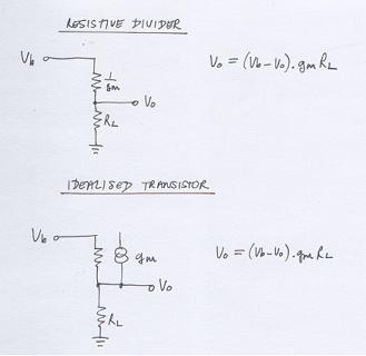

Charles & SY, this may help. It doesn't matter that a bipolar has three terminals - since one is a current source. Both a potential divider of two resistors and an EF with resistive load have the same equation. Now if Andy is saying that the EF is a feedback system because of the form of the equation then he must also be saying that a potential divider is a feedback system. My assertion is that neither are.

You see, if people are going to condem feedback as an undesirable charateristic and others claim their circuits have no feedback, then it must be worth defining feedback.
If we define what is essentially Ohm's Law as a feedback mechanism then we're surely lost as we cannot avoid this in any circuit.
So what is feedback exactly? Or less stringently, how do we identify the type of feedback that causes sonic degradation (allegedly)?

It's been a long held belief of mine that an emitter follower, or "EF", is indeed a negative feedback circuit. Of course, "long held beliefs", mine or yours, may or may not be correct. Maybe we're arguing over semantics.
Often, we tend to think of feedback in a "parallel" sense. A feedback circuit, which may be as simple as a single resistor, is connected at one end to the output, and at the other end to the input of the amplifier stage. This is PARALLEL feedback. An emitter follower circuit has no parallel feedback. It does however, posess a feedback mechanism which I understand to be SERIES feedback. If a voltage source is the signal inputted to the base resistor of the EF, it sees an input impedance which consists of the base resistance, Rb, plus the emitter Thevenin resistance (emitter resistor in parallel with load), Re, multiplied by (hfe + 1). The total resistance determines the current in the base. If hfe increases, the tendancy would be to drive more current into the load (output), and the emitter voltage wrt ground would increase. As a result, the base to emitter voltage, Vbe, would decrease, which would decrease the output current, and voltage. Resistance placed in the emitter tends to cancel out beta, or hfe variations. This is series type negative feedback, since the input is in series with the output. Also, devices with differing hie, or input resistance, would be stabilized by the series negative feedback inherent in an EF.
Many EE's I've worked with in 26 years, with discrete circuit design, consider an EF as posesssing negative feedback. Series, not parallel. Of course, I am not an audio circuit designer, but rather an EE generalist. Maybe the audio community has different definitions of the term. So be it. Let's not engage in a flame war over this. Best regards.
Claude,
I don't think "series" feedback as you put it is anything other than Ohm's Law in action. It's no different from two resistors in series (as I showed earlier).
I suspect, if this thread ever defines feedback, that the "parallel" form will be more akin to it.
I initially thought this debate was worthless, but I'm now starting to realise there may be a much more significant implication of the fact that differentiating feedback from basic network theory seems so elusive.
