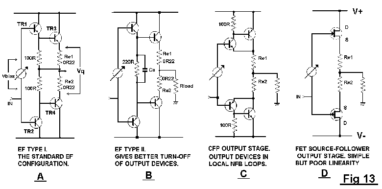

PrimeCase said:
I have one semi useful observation that I have never heard an amplifier with darlington output devices that I liked the sound of
Oh no! Now we have to start another semantic argument!
By "darlington", did you mean the schematic shown in part A or part B?
The reason that I'm asking is because an experienced designer will know that although all of these circuits can be properly called "Darlington", they will have different performance characteristics. Furthermore these characteristics will have an impact on the sound quality.
So it might be useful to define our terms here so that when we use a specific word, we can agree what kind of "Darlington" we are referring to.

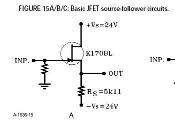

Here's the Borbely quote, from JFETS: The New Frontiers, Part 2:
"JFETs as Followers
Just like tubes and bipolar transistors, JFETs can also be operated as followers, more specifically source followers. The basic circuit is shown in Fig. 15a. The drain is AC-grounded, and the output signal is taken out across the source resistor, which means it operates with 100% local feedback. The gain of the source follower is:
AV = gm x RS/(1 + gm x RS)."

PrimeCase said:
I have one semi useful observation that I have never heard an amplifier with darlington output devices that I liked the sound of, not that one decent designer couldn't make a decent one, as I said just an observation.
Charles has already discussed the technical aspect of various
Darlington topologies. One thing I think he missed to include (or
I just missed it in his postings) is the Darlington devices, that is
those Darlintons on a chip sold as Darlinton transistors. One

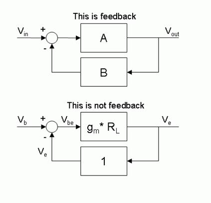

I for one do not agree that the lower diagram is necessarily a feedback system. Absolutely not. If you replace your transistor with a resistor of conductance gm it will fit the lower diagram.
ARE YOU SUGGESTING THAT A RESISTOR IS A NEGATIVE FEEDBACK DEVICE?
"JFETs as Followers
The gain of the source follower is: AV = gm × RS/(1 + gm × RS).
Two things become obvious from the formula: first, the source follower does not reverse the phase of the signal, and second, if gm x RS >> 1, then the gain becomes approximately unity. In order to make RS large, you can use a constant-current source with high output impedance (Fig. 15b). The linearity is also dependent on RS..."
from "JFETS: THE NEW FRONTIERS, PART 2" by Erno Borbely
I think that what traderbam was saying was that the emitter follower was drawn as a two-terminal device -- base and emitter. So if we insert a different two terminal device (e.g., a resistor), then we can see that one lead corresponds to the base and the other to the emitter. In that case, the resistor value becomes Rl and gm = 1. But maybe I'm just misunderstanding what he was saying.
