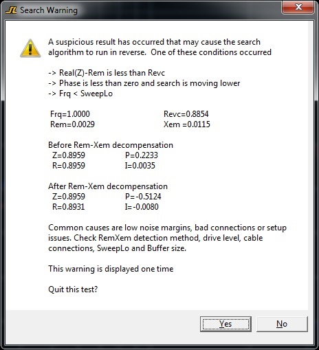

What could be better than testing real drivers! ;)
Actually I've tried to measure the artificial test load as you described and while it works perfectly in WT3 tester I always receive an error message in WT2 similar to the attached picture.
I've tried to change the Cap and resistance values, but it doesn't change anything. The coil is 6.6mH with an internal resistance of 0.45 Ohm.
I don't get this kind of errors in WT2 when I measure real drivers.

The reason to construct an emulator is that the T/S parameters of your real drivers are unknown. To evaluate test equipment requires a standard. The emulator is a DIY standard to test the test equipment.
The warning that you get from the WT2 indicates that the voice coil inductance of the emulator does not have the non-linearity of an actual speaker voice coil. You can change the model from a 4-part voice coil inductance to a simple Le model. For a real speaker, the 4-part voice coil inductance parameters create a very accurate model.
In your WT2 software you do this
Options -> Le Test Method
There are three choices
Classical 'Bare Tank'
Two Point Frq Dependent Le
Three Point Frq Dependent Le
Choose Classical 'Bare Tank' and click OK.
Now you can test the bare tank circuit that is the emulator. I suspect that the WT3 does not extract the 4-part frequency dependent Le model parameters but I don't know for sure. That would be why the WT3 does not throw an error when it tests a bare tank when it is expecting a speaker.
When you test a real speaker change the option back to frq dependent Le.
