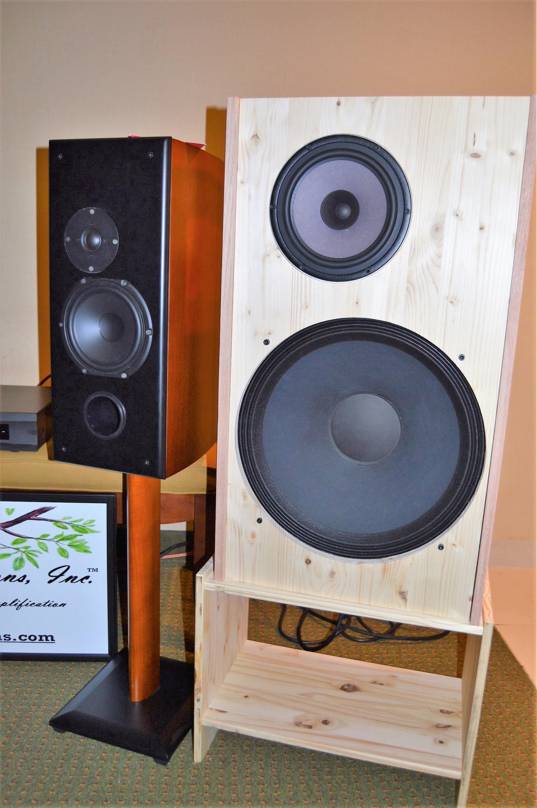

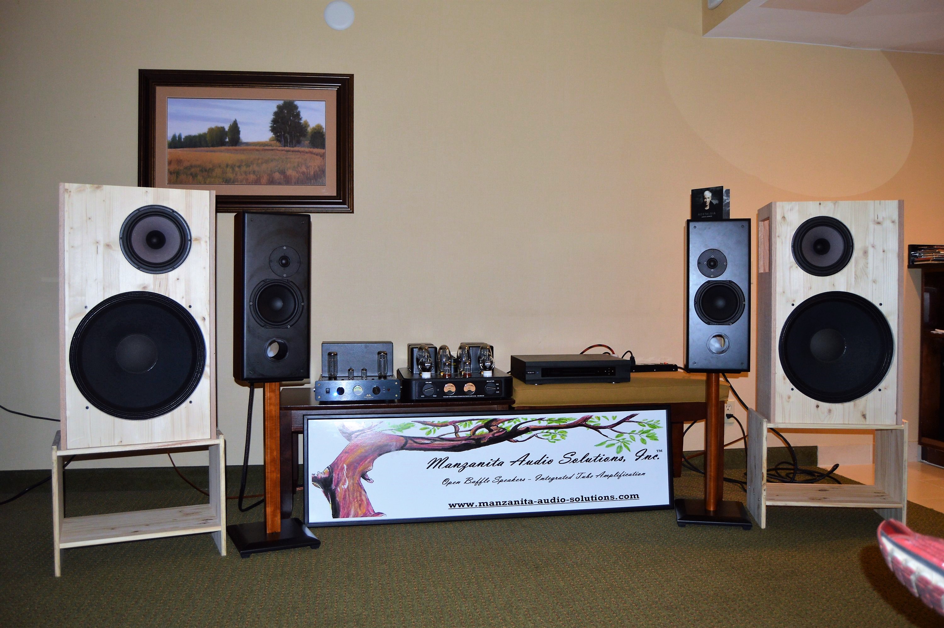

John had a couple of new speakers at the show. The little one was a ported box (!!) that did just about everything well. The other was an open baffle with a Seas on top with an 18" doing bass that sounded great and was capable of pretty amazing dynamics and very high listening levels.
The open baffles reminded me of his Ultra Plus speakers. It would be nice to give a more detailed comparison of the two models but it's been 4 or 5 years since I've heard the Ultra Plus model. They were also in different sized rooms and were driven by different amplfiers. These new one's handled his Kodo drum track with alarming dynamics using a small tube amp.
Nice stuff.
