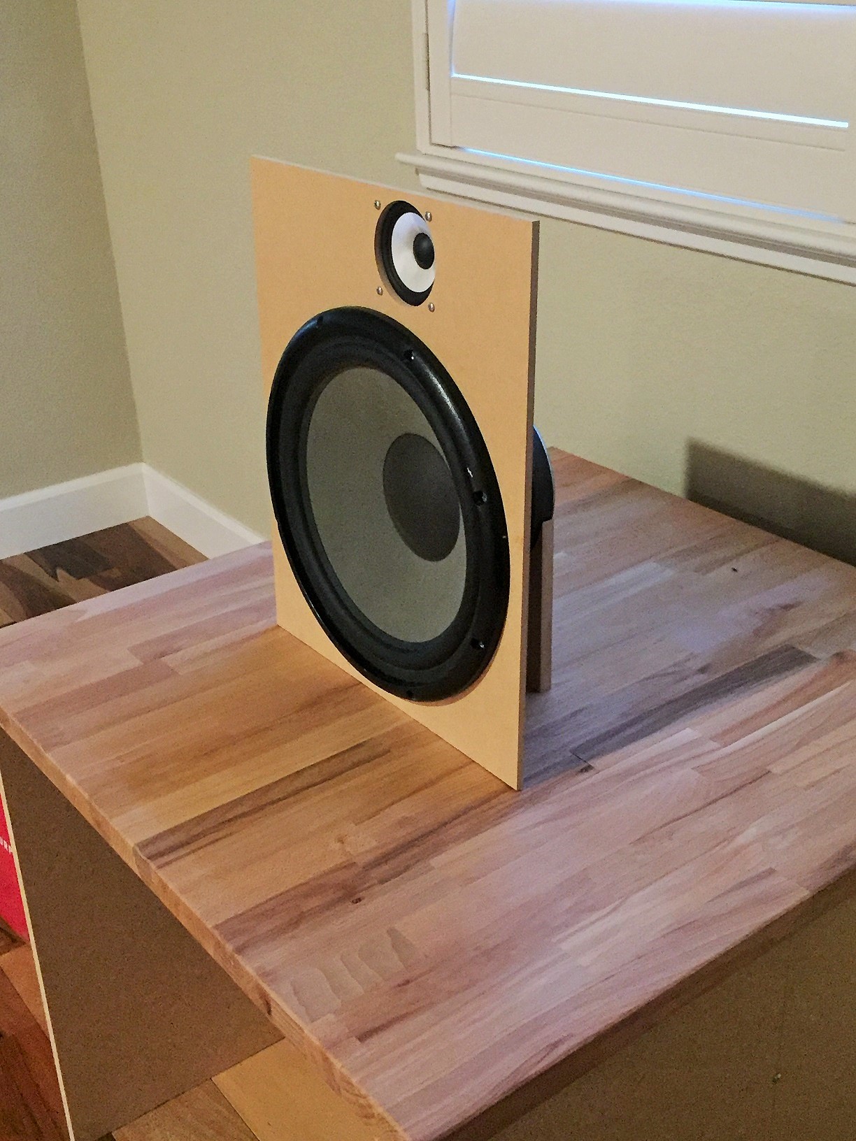

Since my travel plans abruptly changed this morning I was able to set up and perform some measurements on the active Charlita.
639320d1507513722-fast-fun-inexpensive-ob-project-img_6679-jpg

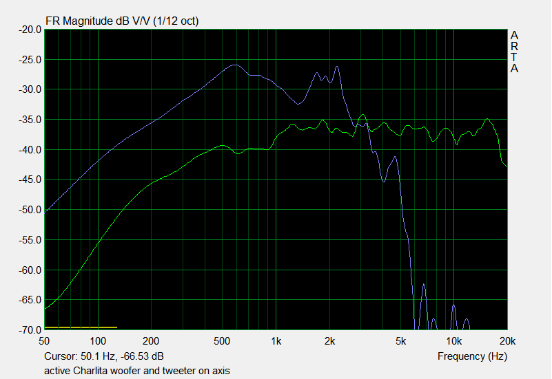

I took measurements on axis and at 10,20,30,40, and 50 degrees off axis using ARTA and with the same voltage input to each driver. The SPL levels are arbitrary as no level calibration was performed but the relative SPLs of tweeter and woofer are correct. At each position I measured the tweeter, woofer, and both tweeter and woofer together. This allows me to extract the differential pathlength at each position, from which I can extract the acoustic delay. The responses and the delay (the z-offset in some parlances) is then a model of the loudspeaker which I use in my Active Crossover Designer program.
The only other measurement I SHOULD have taken but just realized I did not was a woofer nearfield. My measurements were performed at about 1.2m and I only have 120Hz resolution. The nearfield would help me better guesstimate the ultimate woofer rolloff, but it's not really critical since I don't plan for the speaker to operate below 100-150Hz.
As a teaser I have attached a screenshot that overlays the on-axis frequency responses of the woofer (in blue) and tweeter (in green). Smoothing is 1/12th octave. My first attempt might be a crossover point around 600-700Hz, which is around the frequency of the woofer's dipole peak.

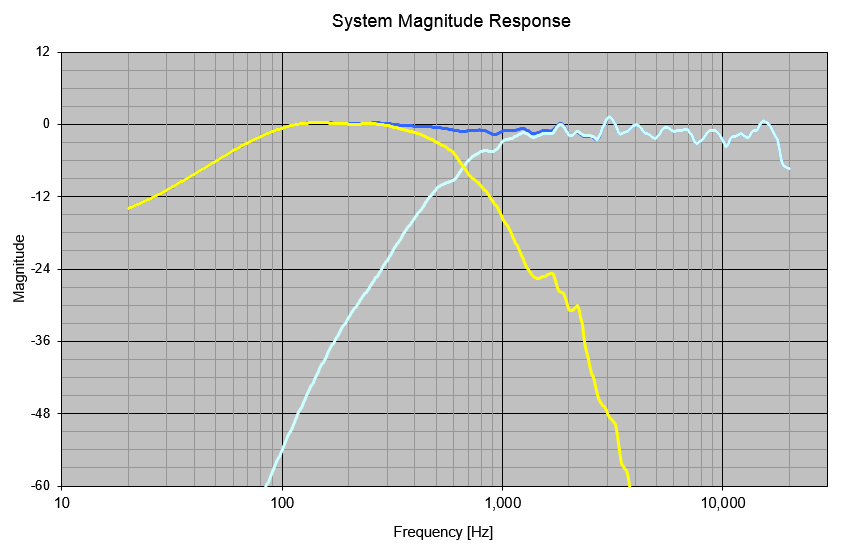

Since I had the data in hand, and some time, I came up with a first stab at a crossover. See attached response plot for drivers and system. The effective crossover point is at about 675Hz.
The crossover consists of:
WOOFER:
+10dB input gain
1st order low pass at 100Hz
2nd order LP: 730Hz, Q=0.55
EQ: -2.5dB@580Hz, Q=1.8
TWEETER:
input gain -0.5dB
second order HP: 700Hz, Q=0.6
EQ1: +3.5dB@800Hz, Q=1.8
EQ2: -1dB@1200Hz, Q=2
This can be implemented in software DSP using my LADSPA ACDf plugin.
I also collected off axis data, but that will take more time to process. This is a good first try using only the on-axis data set.

Hey Charlie, thanks for the pix, measurements and info on your baffle. I'm really surprised you've gotten as much low end as you have with that "next to nothing" baffle. It's mighty small.
Looks like you low pass is doing the trick, you picked a good points and slopes for it. :up:
The first order LP is doing the same thing as the big inductor in the passive crossover. It works in this particular system because the woofer has a higher voltage sensitivity than the tweeter, so there is some of that to sacrifice. Also, the dipole peak is at +6dB WRT the nominal level. All in all I think the circuit tops out at 10dB of boost to the woofer around 20Hz, but at 100Hz it's not yet reached 5dB. The woofer's resonance rolloff is kicking in around 100-150Hz and below that point it's a losing prospect to try and correct the drooping response so that more or less determines the system's low end rolloff behavior. This is why low Q woofer in an open baffle are a challenge - the start pulling the response down faster than the 6dB dipole rolloff sooner than a higher Q driver would for the same Fs.
I like using very small baffles in OB projects, or even using the drivers suspended in mid air (the no baffle open baffle approach). According to modeling and measurements that I have made on various systems, the more baffle that the acoustic radiation sees the more irregular the off-axis response pattern.
The woofer frame in the Charlita is almost as wide as the baffle and the frequencies are lower, so the baffle size is essentially insignificant (as seen by the acoustic radiation produced by the woofer). For the tweeter, I located it very near the edge and off-center. This helps to reduce the dipole peaks and dips significantly, however, with that placement the dipole peak will be low. For a tweeter you don't need any "low end" so this placement works well and keeps the response pattern even. You don't see much of the usual "dipole pattern" in the tweeter response because of the near-edge position, so it becomes very easy to with with in the crossover.
I threw in a couple of EQ bands that help to smooth the response. I need to check these against the off axis data to make sure that the peak is not shifting with angle. I will do that later, in a second pass at crossover development in ACD.
Anyway, that's how I turned this...

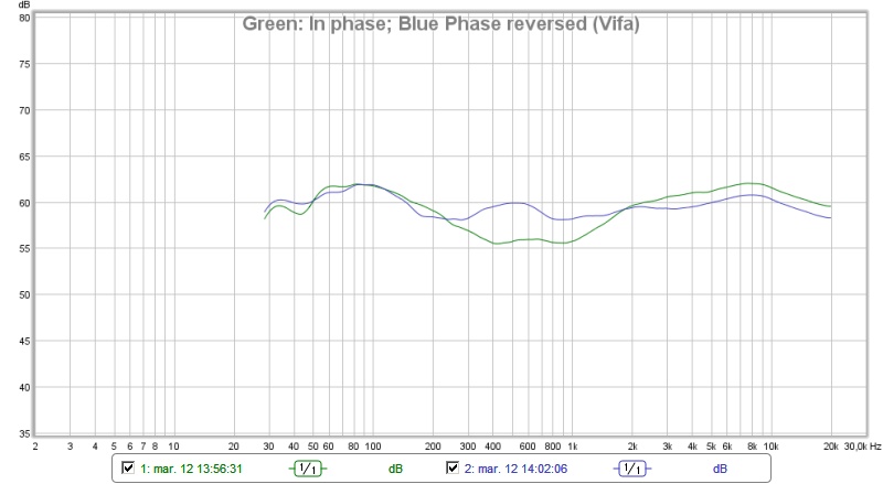

However, they didn't pass the long term test: I've worked with and listened to music and Hi-Hi for many, many years, and the test of time is the most reliable one for me: If I lose interest in listening to music with a particular set-up there's something wrong. Probably not with the equipment as such but with the equipment-human-combination (just as the stereo image is created by the ear-brain-combination). And having had the Orions as my main set up for I guess a couple of years or so the equipment-human-combination wasn't so sweet anymore. It is difficult to say precisely what happened, but I felt they were a bit "sluggish", a bit "heavy" unless I really cranked it up. So, what do to? As always, Linkwitz had some sort of an answer. He states somewhere on his website that the sonic signature of his Pluto speakers is about the same as the Orion bar the SPLs and the bass register, so I got myself a Pluto - and they've stayed there since. In my ears they are perfect in the sense that the music is almost ethereal - even more so than the Orions' - there is absolutely no focus on the speakers. The music is in the room and I completely forget about the speakers and the equipment. Of course, they can't give an anywhere near realistic rendition of say Mahler's 8th symphony. The Orions can't either - but they are much closer to the mark! But if I go a bit softly on the volume control they can play big-band music quite well, a genre Orion excels with. (Later I added some small sub-woofers to the Plutos. Here are some observations: http://hjkm.dk/Pluto/Pluto_w_sub.pdf ).
But as the saying goes: "In tranquillo mors, in fluctu vita" - death is in the still water, life in the waves - so being so pleased with the Plutos I decided to have a go at the LXmini - since Linkwitz claims that they are better than the Plutos. They are! - Not much, but noticeably so. - The most remarkable difference between the LXmini and the Pluto is that the former paints the room behind the musicians as completely rectangular - you can "hear" the corners of the room, if, that is, the material is up to the task. One very good example is Naxo's edition of Paganini's "Sonata for Grand Viola and Guitar" from the album "Music for Violin and Guitar II" (8.550759). I'm in the process of migrating to the LXmini in place of Pluto. But I feel that the miniDSP adds some sluggishness to them that the Plutos don't have, thus I plan to try out Nelson Pass' analogue filter. (htttp://linkwitzlab.com/LXmini/ASP.htm ). (It also seems that Linkwitz himself has abandoned digital filtering in favour of analogue processing for his LX521.)
But why not replace LXmini with Manzinita? I am considering it - and sonically I could easily live with the exchange. The advantage would be much less cable spaghetti, the disadvantage a larger footprint. Potentially it is also a problem that I can give the speakers much less space behind them than they get in the room in which they're playing now. This might be remedied by "taming" the rear radiation in the way it's done with Quad ESL57. Their radiation pattern is more cardioid than figure-of-eight which means that they can be placed closer to the back wall. Moreover, I'd have to shine up the Manzinitas. So far they are just a quick mdf mock-up - but they have played to my great satisfaction in my soundlab for years, - and impressed visitors to boot.
