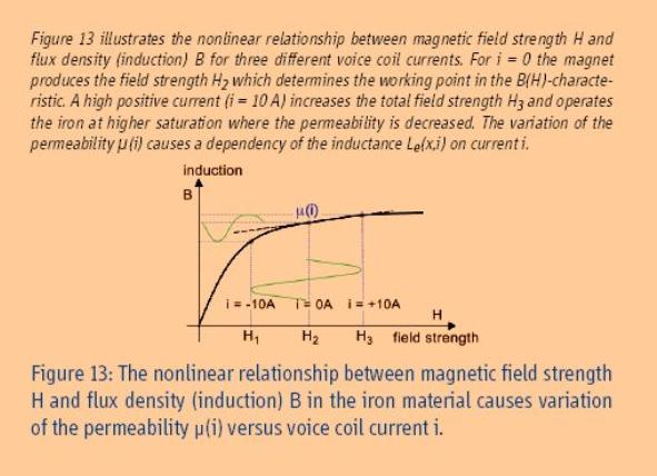

We can see that a typical operating point for the neodymium magnet is much higher along the B-axis than that of a ferrite magnet. Therefore, for a given change in magnetizing force produced by signal current in the voice coil, the resulting change in induced flux (deltaB/BNIB) will be fairly small. By contrast, the resulting change in induced flux for the ferrite magnet will be deltaB/BF. Since BF is less than BNIB, the total variation in induced flux will be greater with the ferrite magnet.
Thanks Bill, that was what I was looking for. A variation in H (sinusoidal applied magnetic force from the voice coil signal input) gives a variation in B (magnetic strength at the operating point). It looks like the B variation is the same in both cases but this makes it much greater in percentage terms for Ferrite.
2nd harmonic is created because the magnet circuit effective strength increases in one direction and decreases in the other i.e. one side of an applied sine wave gets magnified, the other diminished.

I know it might appear that I've been rabbit-chasing with this emphasis on steel's role, but I'm really not. (I do apologize, however, for not being clearer about tying the discussion back to its root in this thread.)
let me try to summarize briefly, and I invite correction from any of the host of magnetics experts out there who are more learned than I:
Steel is at the heart of the discussion in this thread because its variable permeability is the root of the Le(i) distortion mechanism. Klippel, for one, is pretty clear on that point (again, see the wording on the poster). In other words, when steel is subject to varying magnetic fields, its permeability modulates, and distortion results. Yes, the flux through the magnet itself modulates as well, but I believe (again, some guru correct me if I'm wrong) that its BH curve plays less of a role in the Le(i) distortion mechanism than that of the steel return circuit.
So the goal is to stabilize, as far as possible, the B field the magnet projects through its steel return circuit. Shorting rings are one good option (Now we're back on topic!). At frequencies where eddy currents are efficiently induced in shorting rings, they mirror and thus cancel a portion of the alternating VC field, shielding the B field conducted through the steel from modulation.
Another way to stabilize the B-field flux conducted through steel is to choose a "stiffer" magnetic material, such as AlNiCo or NdFeB vs. ferrite. Different approach, but same goal as shorting rings--to minimize the modulation of steel's permeability. (So our magnet discussion isn't so off-topic in a shorting-ring thread.)
Yet a third way to treat the same issue of flux stability through steel is to maximize B and minimize L(i) when you put together a target BL(i), as I mentioned a few posts ago.
A more radical way to treat the steel problem that few (except maybe ATC?) have explored is to minimize the role of steel in the loudspeaker motor.
So, in a nutshell, that's why I keep talking in terms of steel. Because whether you're talking about shorting rings, magnet types, motor strengths, etc, your real goal is to stabilize the flux flowing through steel, to keep it operating on a linear region of its BH curve to minimize Le(i) distortion.

David, all parts of the magnetic circuit are in series. Permanent magnet generates the flux, steel parts guide this flux and with the air gap they close the magnetic circuit.
Local modulation of the magnetic flux at any point of this circuit, affects the whole circuit.

Dave, I think perhaps we're arguing the same point from from two slightly different starting points. We are both referring to Le(i) distortion, right? We both agree that a historical ferrite-magnet motor initially lagged behind the performance of a similarly designed AlNiCo-magnet motor.
WHY seems to be where we split. If I hear you correctly, you are suggesting that the Le(i) distortion in the ferrite-mag motor arose primarily from from within the magnet itself as its operating point on its BL curve was perturbed.
For my part, I defer to Klippel (from the attachment to post 89): "The nonlinear relationship between magnetic field strength H and flux density (induction) B in the iron [read: steel return circuit] material causes variation of the permeability u(i) versus voice coil current i."
So, yes, the magnet's operating point was perturbed as its flux was modulated by the VC field, but it was in the varying permeability of the steel in the motor that birthed the Le(i) distortion.
This is independent of the established fact that some magnet types are measurably better than others, all else being equal.
