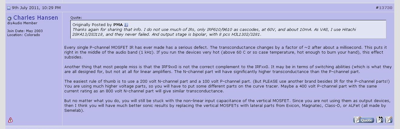

Thanks buzzforb. I agree, the 16N25C is an excellent replacement for the 19N20C. I haven't had time to do the research on Charles Hansen's suggestion of basically selecting a higher voltage complement to get the Transcunductance down to match the P part. I use a 150V part sometimes that is 20S! I think we should look for 400V N parts?
