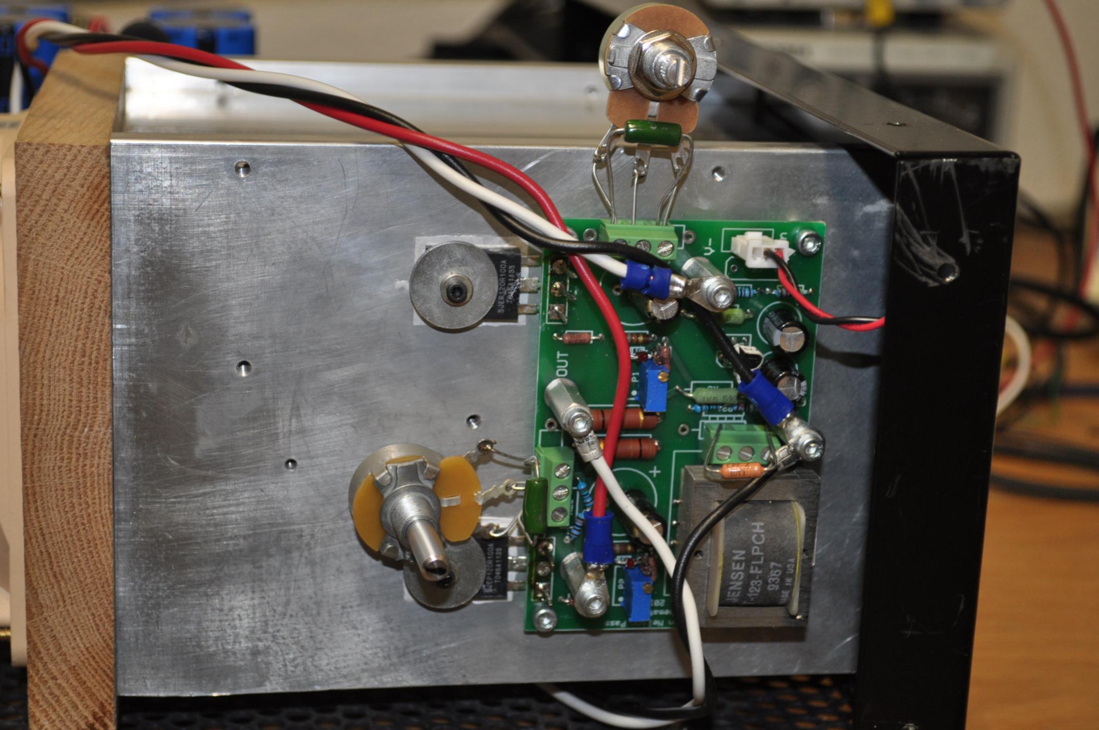

Buzz: You might consider this modification to the circuit. Add 20 ohm pots in parallel to the source resistors. The pot wiper is tied to the capacitors. This provides complete freedom to experiment with balance of top and bottom JFET modulation, and the pot adjustments do not affect the DC bias. Also, the source resistors retain their normal values and WATTAGE.
This is such a cool idea !!!! Zowieee ....

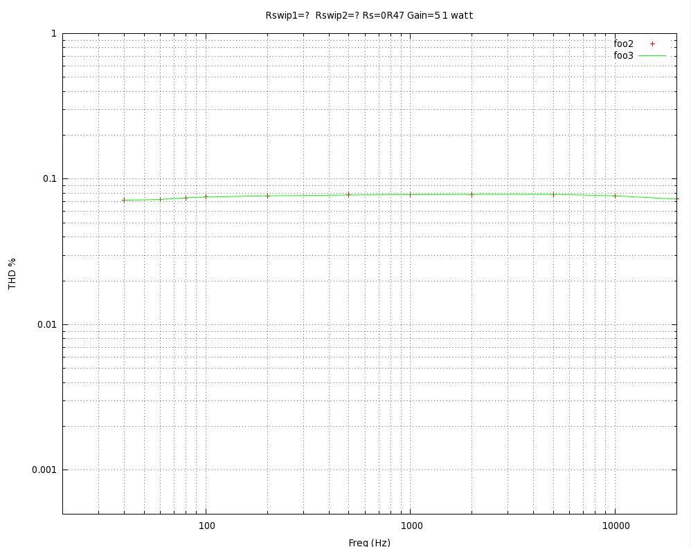

I have been tweaking the pots. With Rs=0R20 I found this very interesting pot combo. The pot wipers were quit low, perhaps 0.1 of the hi FET and 0.3 on the low FET. I do not have an accurate way to measure either the pots or the source resistors to say what the exact resistor values might be.
