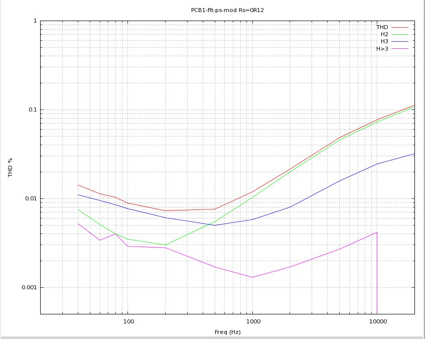

I made the in-circuit measurement of the R100 transconductances of PBC1 and got 6.3S for the upper FET and 7.5S for the lower FET. Since the source resistors have 5% tolerances, the calculation has corresponding uncertainty.

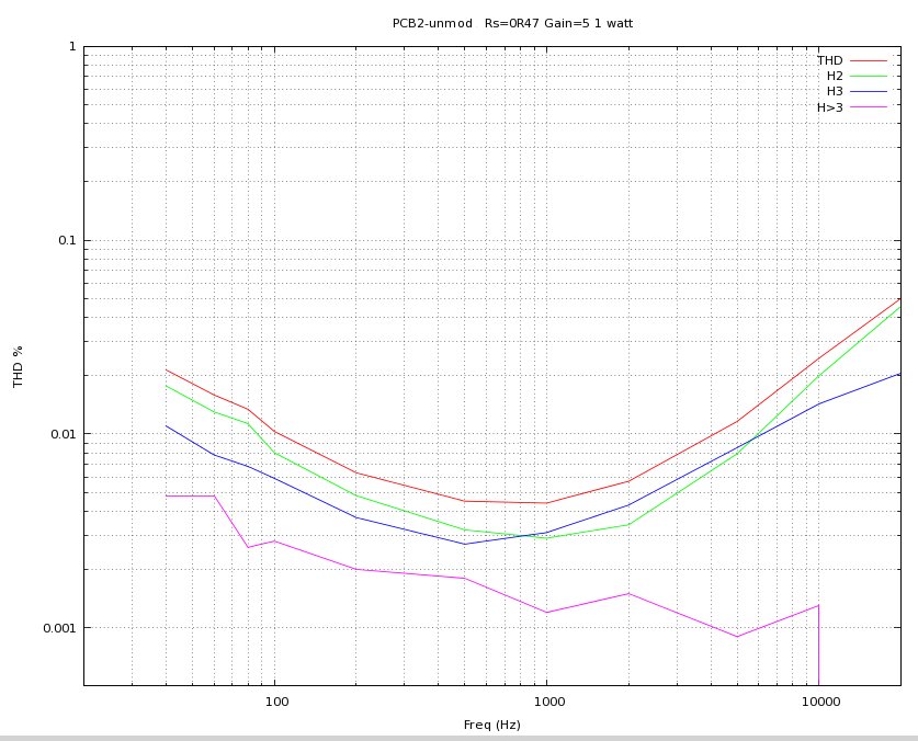

Here are plots of the two channels adjusted for the best nulling of the 2nd harmonic in the mid frequencies. The first plot is from PCB1 (with the poorer measurements). The second plot is from PCB2 (the better channel). I would expect to be able to do a better job of nulling the 2nd harmonics for PCB1.
