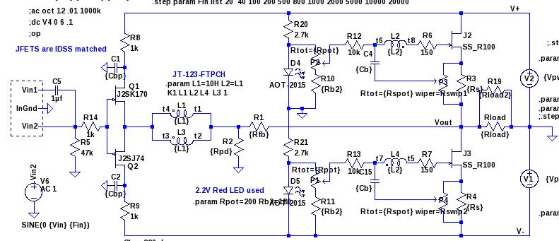

Buzz: You might consider this modification to the circuit. Add 20 ohm pots in parallel to the source resistors. The pot wiper is tied to the capacitors. This provides complete freedom to experiment with balance of top and bottom JFET modulation, and the pot adjustments do not affect the DC bias. Also, the source resistors retain their normal values and WATTAGE.
Below Rs is definitely much cleaner, but it doesn't have same magic as above. Above introduces a bit too much grit, but the overall presentation of space is much more enjoyable. I have some other bad ideas to test and will be back.

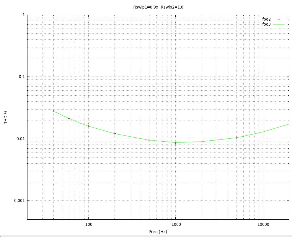

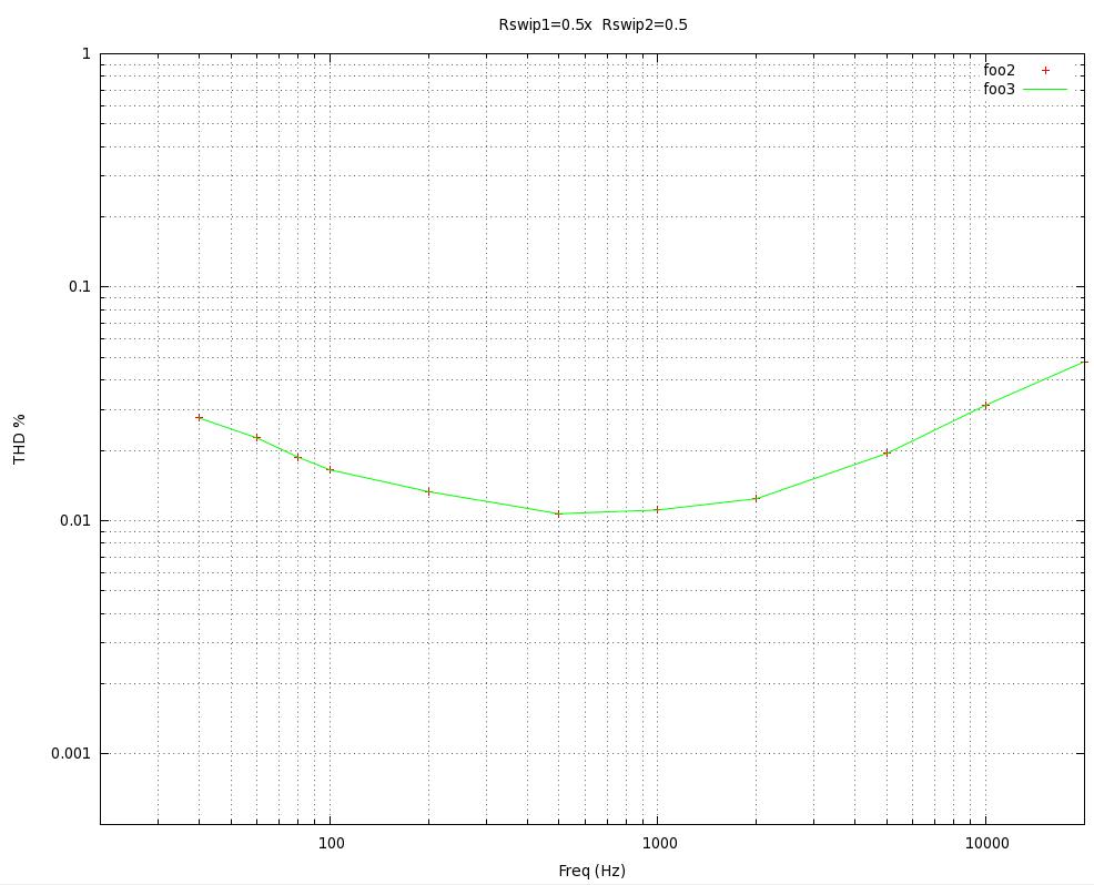

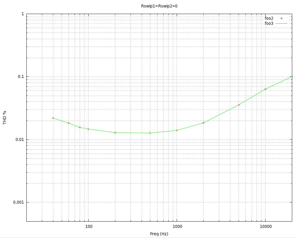

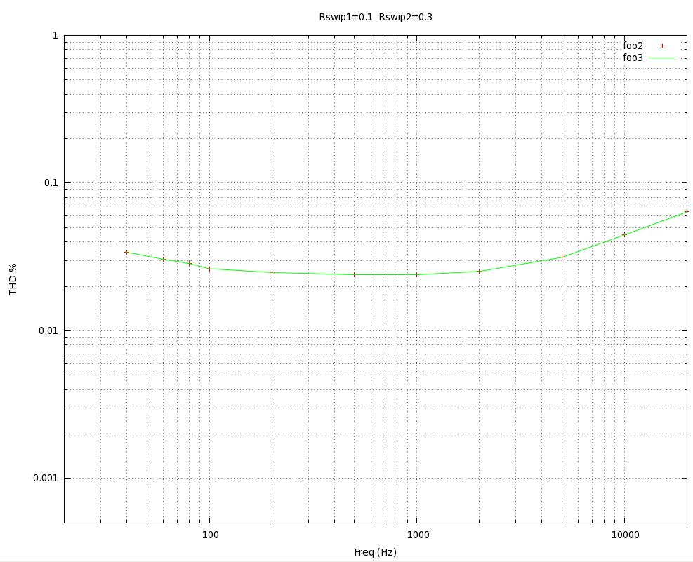

I just ran some measurements of one Teaser-6 channel using a variety of pot adjustments shown below.

Told me what? Do not forget that high values of Rswip1 and Rswip2 mean higher output impedance and lower damping factor. There is a tradeoff between lower THD and lower Zo. Also consider that small "tweaks" to the relative values of Rswip1 and Rswip2 are comparable to minor adjustments to Rs to correct for transconductance differences of the output FETs and reduce 2nd harmonic.

You cannot get the 2nd harmonic minimum with just the above/below combos unless you try many many combinations of Rs-above and Rs-below. The variable adjustment greatly simplifies things and does not require readjustment of the DC bias.

Perhaps my post with the THD vs Freq plots wasn't clear. These were NOT simulations, they were measurements of the actual PCB using the pots.
