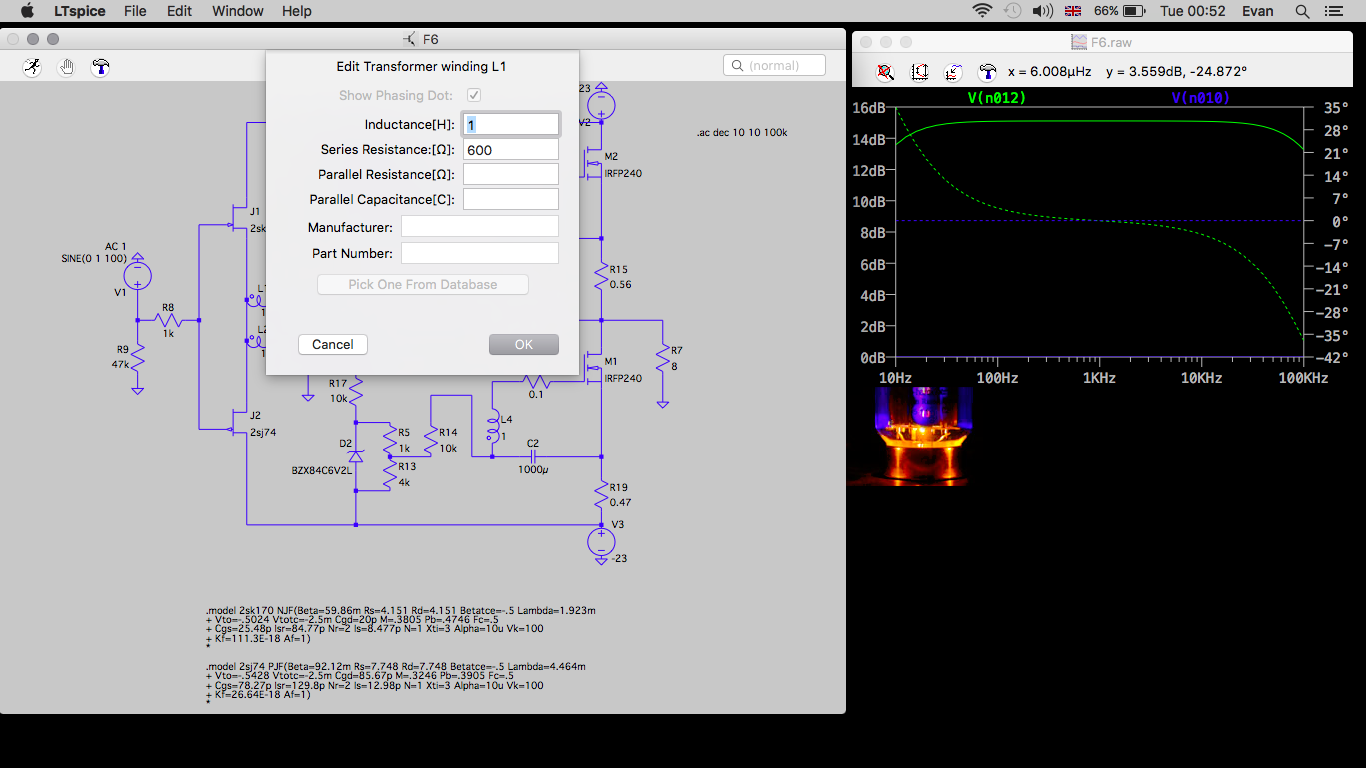

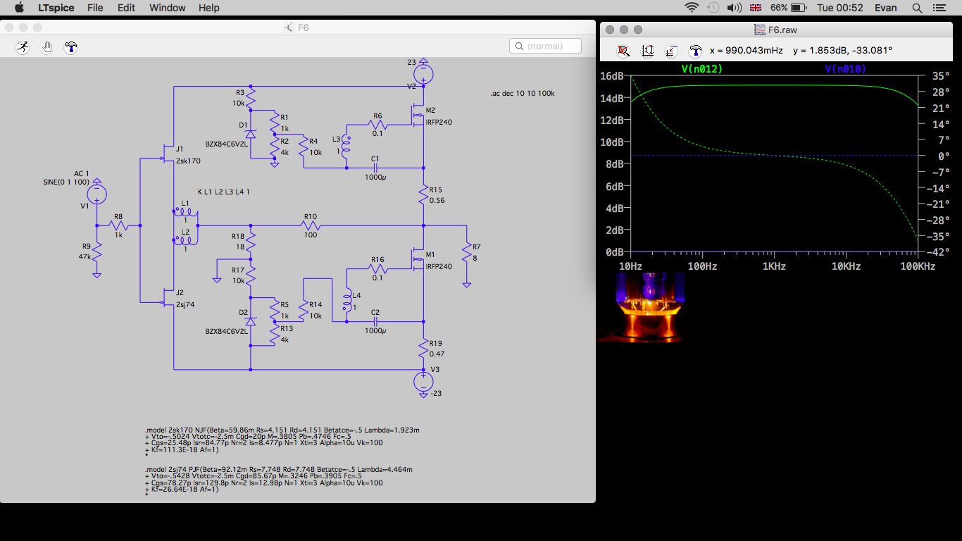

I have simulated with a transformer of 1H and 600Ω per winding and there's very little LF and HF roll-off. The F6 does have a jfet buffer in front of the transformer..

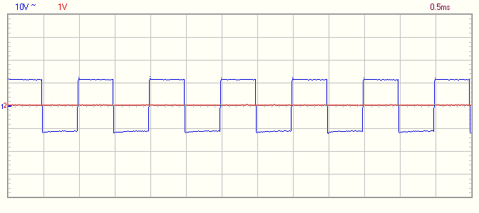

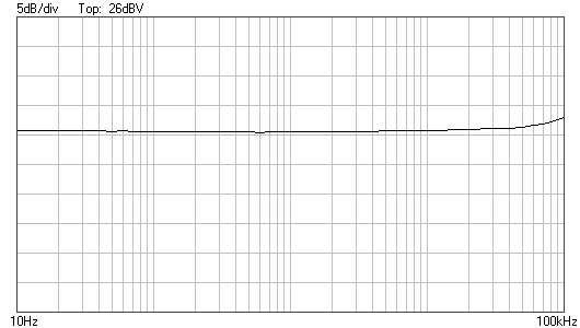

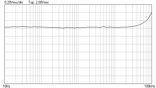

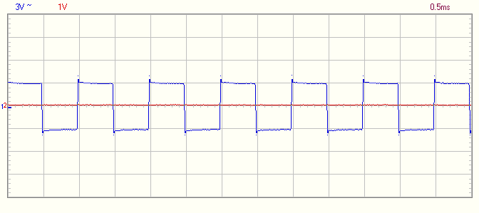

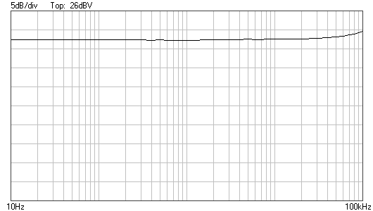

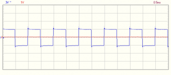

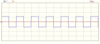

F6 with Lundahl 1527 and Cree C2M0280120D. 26.5V rails, LCLC supply, 1.2A bias. 8 Ohm load resistor:
Frequency sweep 10Hz to 100kHz sine wave 0.5Vrms
Frequency sweep 10Hz to 100kHz sine wave 2.0Vrms
Square wave 1kHz 0.5Vrms
Square wave 1kHz 2.0Vrms
Wonderful Kaputt this is exactly what I wanted to see!
I too am using the Cree's with similar supply but with the Jensen transformer and my response curve is identical to Nelsons, starts to dip after 20KHz

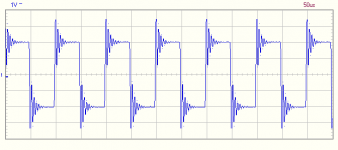

Can you do me a favour and run the square wave test at say 10KHz and 60KHz if the waveforms show significant improvement than Jensens then I will get some Lundahls.
Again thanks for taking the time and posting.

I think you have taken only a 1 probe measurement without taking into account the signal generator error at its output.
You need to use 2 probes. 1 at signal generator output and 1 at amplifier output.
Also suggesting measures at 4Vpp output to make it comparable with others (1W/8ohm)...
But, maybe I am wrong.

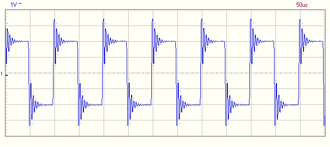

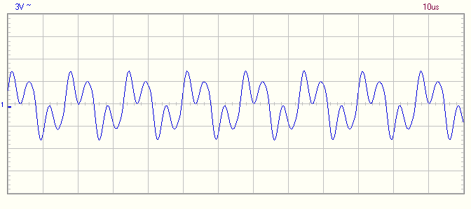

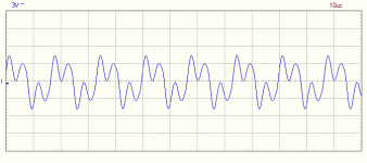

Thanks Kaputt I'm sure there will be other people jumping in here and commenting on the waveforms especially the 60KHz one. If you have not changed the scales of your scope on the 60KHz one then we can clearly see the frequency is definitely having an effect on the output and it does not correlate with the flat frequency response you have shown in the first diagram.
I changed the scales as I went for best visibility of the distortion at 60kHz. Level correlates to the frequency response plot.
As to the "sound" question asked earlier: so far I only had a chance to listen to the amp through horrible Scan Speak Illuminators but even with these it had some kind of "swing" but I wasn't instantly taken away. I'll get back to that after listening with different speakers.
Frequency response at 4Vpp output into 8 Ohm resistor.
Square wave response 10kHz and 60kHz.
The rising response at 100k is a little worrying.
Increase sweep to 1 MHz to see the full picture.
