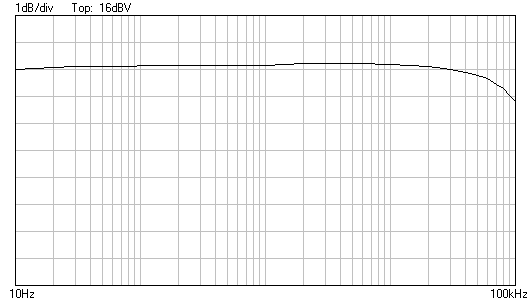

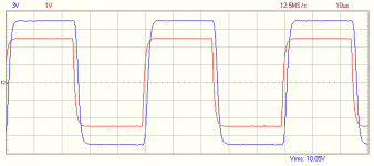

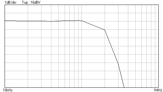

Frequency response at 4Vpp output into 8 Ohm resistor.
Square wave response 10kHz and 60kHz.

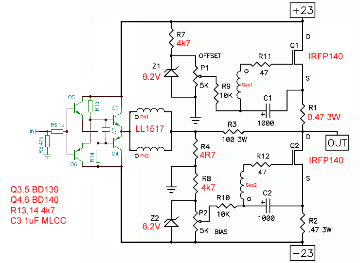

I "quickly" threw together a Lundahl F6 from what I had on hand.
Transformer: LL1517
Buffer: Diamond BD139/140
Output: IRFP140
Gain: 20x (100R/4.7R)
Bias: 660mA
Frequency response is similar to Kaputts findings.
It also has a similar transformer ringing in it.
1kHz/8R/1W THD is 0.07%, which is not too bad, I think. Taking into account the gain, the bias and that the Diamond still needs some fine tuning; I believe I can get it below 0.05% quite easily.
All in all, very perfectible concept...
...more to come...

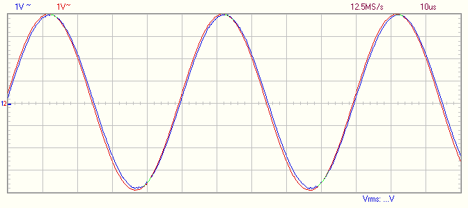

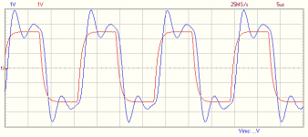

Probably a little less ringing with this setup.
60kHz SQR, red in, blue out.
The 20kHz sine is quite beautiful though...
Im not too sure if I need to be too worried about the ringing, but lets see if there is something that can be done about it...

Interesting ! Do you have a schematic for this ?
Well...
I have now! ;-)
Its a keeper if I can get the THD around 0.02% with minimal ringing at the same time. Looks like 200kHz... Shouldnt be a problem. I will probably snubberize it at the trafo secondaries.
Or, cut the HF from feedback. Or both.

With respect to transformer ringing, some Lundahl transformers give various schemes in order to filter it.
E.g. for the LL1540 a 22kΩ + 1nF network or 17.5kΩ resistors across the secondaries are recommended.
http://www.lundahl.se/wp-content/uploads/datasheets/1540.pdf
Papa uses a 10kΩ + 680pF network on the M2, which uses an Edcor 600/15K PCB transformer.
I believe the formula for calculating the cutoff freq. is f=1/(2*pi*R*C)

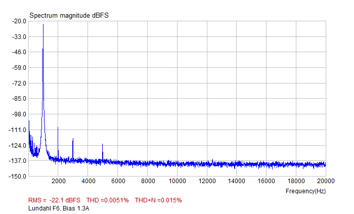

Its a keeper if I can get the THD around 0.02%...
Well...
That was easy.
The best I was able to squeeze from the Jensens was 0.009% at 2A bias or something.
This goes easily to 0.005% already at 1.3A (1kHz/1W/8R)!
Note: Gain 20x !!!
Definitely a keeper.

...with minimal ringing at the same time. Looks like 200kHz... Shouldnt be a problem...
Oh!
Gate resistors 390R.
Took care of the ringing. Made the freqres nice and flat.

I have results for the new gate stoppers.
Not too happy... I already fell in love with the 0.005% and because of the resistor change it is now 0.011% (still not bad, but...), and that mainly because of the increased 3rd harmonic only!
What is interesting is that the 5th did not change at all! It stays rock solid on -100dB???
This goes over my brain capacity.
So, any bright ideas anyone?
Or,
5th harmonic at -100dB? Who cares?
I will put 220R gate stoppers there next, and if no ringing, will stick with those.
Should at least lower the 3rd harmonic back to an "acceptable" level..

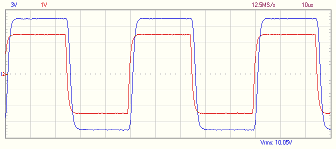

No. No snubber at the secondaries.You do not show on your schematic the RC network supposedly needed for frequency compensation as per Lundahl recommendations have you indeed done this?
Moving on to the the gate stoppers I'm not sure I fully understand their purpose but you have shown that by increasing the resistance from 47ohm as in the original to now 220 ohms you can tame the ringing of the square wave.
Yes.
The gate stoppers form the needed RC network together with the MOSFETs internal gate capacitance.
We can use that to our advantage.
An external snubber network would put additional stress to the input buffer. That of course would also not be a problem.
The ideal gate stoppers for IRFP140 output stage in this circuit seems to be 240 or 250R.
I dont have those, so I keep the 220R.
If different output stage MOSFETs, one needs something else here, as we all know...

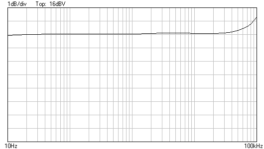

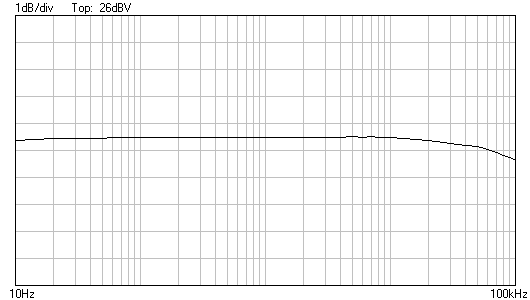

Some graphs with the new 220R gate stoppers,
20kHz square wave,
and full power frequency response.
"Full Power" means 17W. My PSU is only +/-20V.
