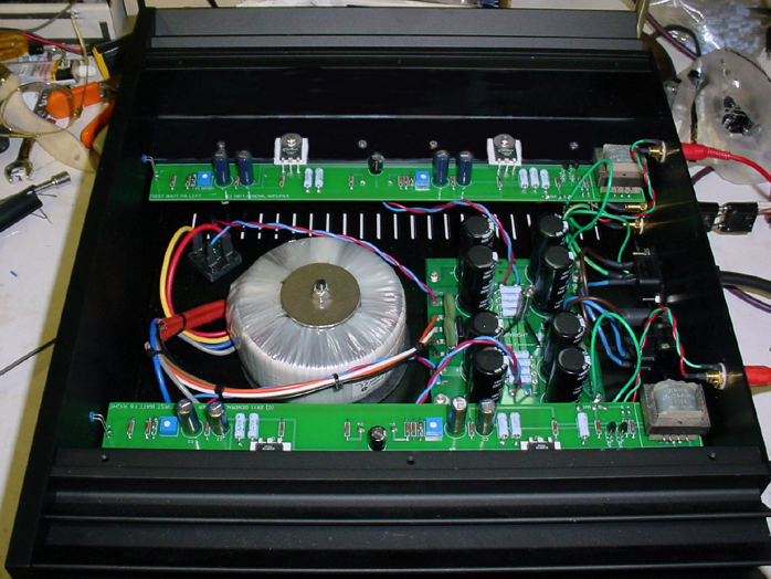

Pic above is of Semisouth version. My personal favorite used these fets with no degeneration on top and only a little(around .05-.1R) on the bottom. When I say degeneration, I am meaning the AC type(cap below resistor, including its effects). Lovely amp. Even went so far as to do a bridged/balanced version that was even more enjoyable. Now considering the bridged version with multiple outputs and Jfet drivers after the transformer(will allow dropping of caps).
I am curious as to what the second cap (one of two close together) does (where in the cct. it would be).I wonder if this was one of Nelson's early versions . There also seems to be a third cap at the center of the board.
The cap in the centre appears to be placed across the powersupply input.
The two caps together could be a parallel combo, but in my opinion one of them is most likely used across the zener/trimpot to get an absolutely noise free voltage source for Vgs adjustment.
