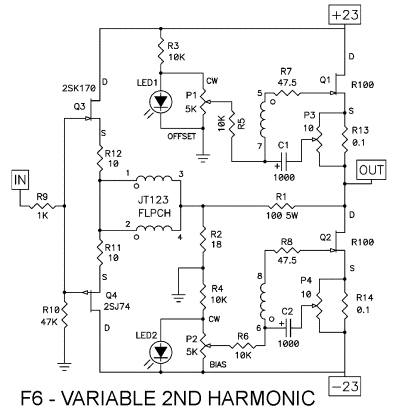

Pulled out the distortion analyzer and measured 2nd harmonic on stock configuration and I'm getting -81dB (1W into 8 Ohms)
Once I have had a chance to enjoy listening to the amp in stock configuration, I'll mod one channel by moving cap lead to other side of resistor and redo the measurement
The diyAudio F6 PCB was made to the schematic provided by Nelson when asked for one, specifically, this -
Note that the capacitor is attached directly to the source of the Mosfets.
Yes, it does differ from the "Output Degeneration" schematic from the presentation at BAF '13 -
Hi Nelson, is there a reason why you provided a different schematic ("F6 MOSFET DIY SCHEMATIC") to 6L6 which differs from that in your original F6 article ("F6 - OUTPUT DEGENERATION")? Was this done intentionally? Which circuit should we be building? I personally have built the F6 from the store boards and am wondering if I should carry out the mod. Thanks.
One is an example of output degeneration, and the other is an example with
no degeneration from an AC point of view. In both cases, there is
degeneration at DC for bias stability vs temperature and such.
There is a third schematic with pots in parallel with the Source resistors with
the wipers attached to the capacitors so that the amount of AC degeneration
on top and bottom is variable. That one is my favorite.

Thank you Nelson. If I understand correctly (I am new at this) is that the no degeneration version has predominantly 3rd harmonic distortion, whereas the output degeneration version introduces 2nd harmonic. Adjustable via the output resistors. I think I will try this out and see how it sounds. Thanks again!

Pots would be nice but you need a distortion analyzer of some sort to get the benefit. Quick and dirty (and it works from my mod experience) is to cut traces and jumper and use 0.47 and 0.56 ohm resistors.

I've attached the circuit with variable 2nd harmonic. However, it has SemiSouth outputs. I assume it can be adapted to use IR parts

You can also achieve 2nd harmonic through selecting devices with different levels of transconductance without modding, but I found my devices are very similar in transconductance (not different enough).Thank you Nelson. If I understand correctly (I am new at this) is that the no degeneration version has predominantly 3rd harmonic distortion, whereas the output degeneration version introduces 2nd harmonic. Adjustable via the output resistors. I think I will try this out and see how it sounds. Thanks again!

Last night I modded my stock DIYaudio "no degeneration" PCB to the "output degeneration" version. I realised that since I am not using input degeneration, only output degeneration, my circuit is now a kind of hybrid of the two circuits posted above. Seems counter-intuitive, although I guess this is what DIY is all about....

This is Nelson's comment on the two variations of the schematic. "One is an example of output degeneration, and the other is an example with
degeneration at DC for bias stability vs temperature and such."
So it looks like the DIY boards benefit from DC degeneration (with the 2 different value resistors) but not AC degeneration. If you sim the DIY schematic the harmonics don't change if you have different or equal source resistors, this model has more 3rd harmonic than 2nd harmonic.. I can't speak to what is happening DC wise.If you move the cap lead to the bottom of the source resistors (as the degeneration schematic) then different value source resistors make a difference, making the 2nd harmonic more predominant than the 3rd, this is the AC degeneration happening.For my ears I could hear a difference (better for me) with the AC degeneration,2nd harmonic dominant model.

1) To change harmonic content using different source resistors values, the cap lead needs to connect to other side of resistor like in F6 article.
So why did Nelson add 0.56 Ohm and 0.47 Ohm resistors if they do nothing to change harmonic profile.
That had me dumb struck for a while. My best guess on this is, Nelson selected IRFP240 devices with different values of Transconductance to get the 2nd harmonic he wanted. The higher transconductance part he placed on the positive power rail and the lower transconductance part he put on the negative rail.
To compensate for the higher thermal drift of the higher transconductance part he added 0.56 Ohm resistor. That's my best guess on that.
Probably the easiest way to hear the effect of changing 2nd harmonic content on the fly would be to solder cap lead to wiper of potentiometer and adjust potentiometer till your ear is happy.
You would only need to do it on one of the devices it's not necessary to do both devices. Or just reroute cap lead to other side of resistor. Or you can do what Nelson did and carefully select parts with differing values in transconductance.

There are benefits in doing it the way Nelson has done it, but it requires selecting parts of different transconductance.

No, I simply made the cap location modification to an existing circuit whose
Source resistors reflected the desire for some 2nd harmonic by different
degeneration top vs bottom.

However, without a picture, I'm not certain I understand.
Are you saying your pcb had the option of installing the cap in two different positions.
In the F6 article the circuit presented there, clearly has that effect.
With the existing pcb the cap wiring is connected differently.
Using 0.56 and 0.47 I did not get the expected amount of 2nd harmonic as measured on distortion analyzer. The same thing occurs in simulation.
In simulation, the circuit the pcb is based on, does not respond to changes in source resistance.
My distortion meter also gives much lower 2nd harmonic distortion with this circuit.
I will try just physically tapping another source resistor in parrallel (change source resistance on the fly) to see if 2nd harmonic distortion changes on my meter.
