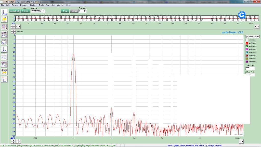

I have connected an 8 ohm resistive load to the amp and takes the signal throught a 100K pot to my laptop,I am running audio tester the spectrumanayzator and running an 1khz signal through the amp wich I se on the audiotester but I get no watsoever reaction when turning the pots on the ampmodule.
Is this normal? :confused:
But I don´t know why theres both a blue and red curve when I only have one channel from tha amp connected?Can I turn it off somewhere?

If it's biased, then something else is wrong... your odd-order harmonics are stronger than the even-order, and they are all huge. The only harmonic spikes you should see are 2 and 3.
You are giving the amp a clean 1000Hz sinewave? Don't use squarewaves.
Perhaps it's just a measurement error... does it sound good?

Put your DMM n AC, change for a moment from 1kHz to 200Hz and measure the voltage over the 8R at the output.
Disconnect for security connection to Laptop input......
Do have the 2.83V at 8R for 1Watt or more..?.or less....
Maybe you have to increase or decrease the the input voltage ....
If you have the 2.83V go back to 1kHz and measure again, when the DMM AC shows nearly the same value..... good, if not keep the reduced value in mind and use it in future for the
measurements with 1kHz.
I measure always first the 2.83V and the I look if my pot reduces the value to let us say secure 100-200mV for the laptop...
Here is one that I got when turning one off and checking the levels.
But I guess its that first one harmonics thats to large?
Yes its connected to speaker ground.
If I'm not mistaken it should instead look like this:
Only some 2nd and 3rd harmonics visible and the rest down below the noise floor.
