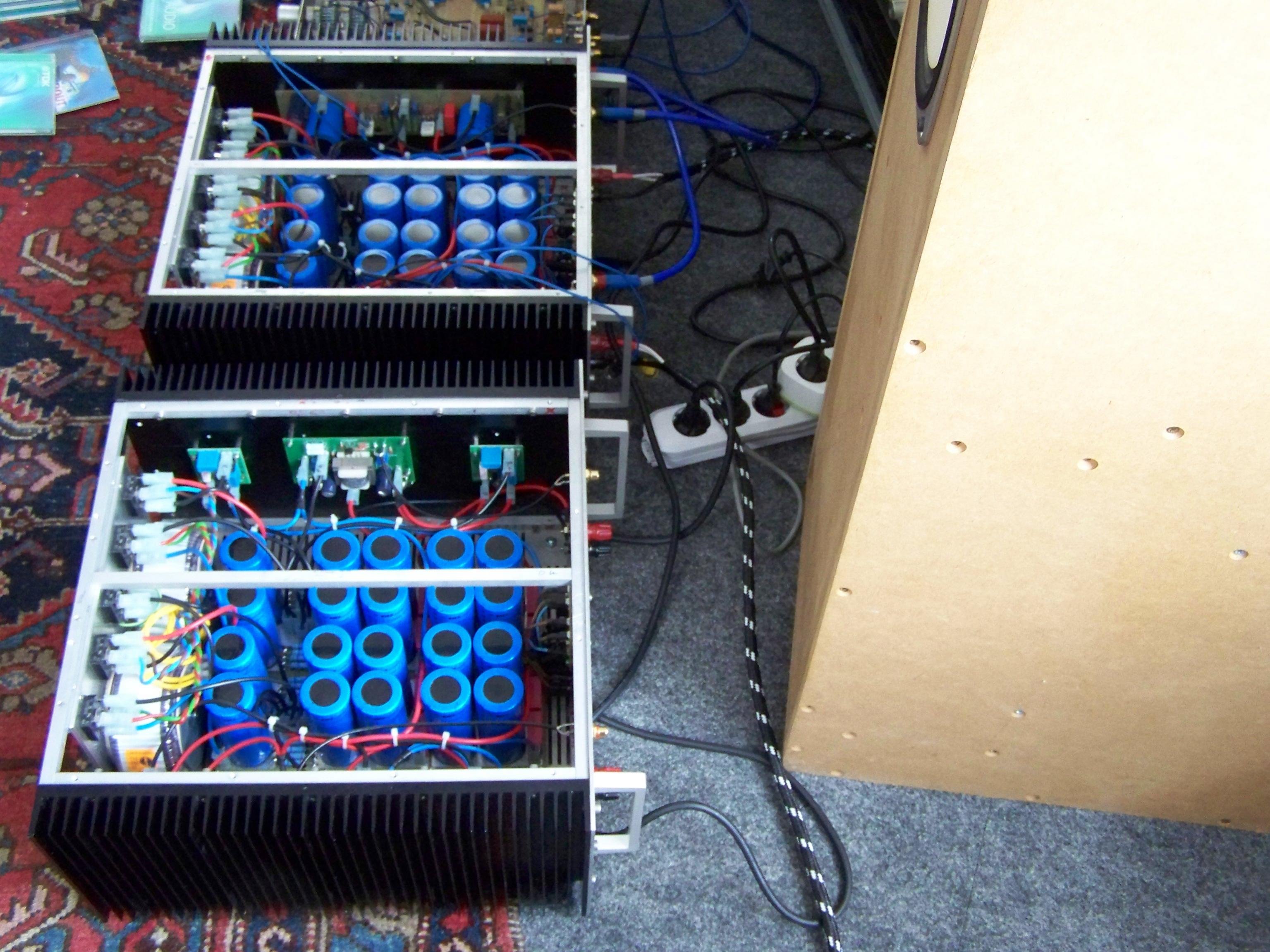

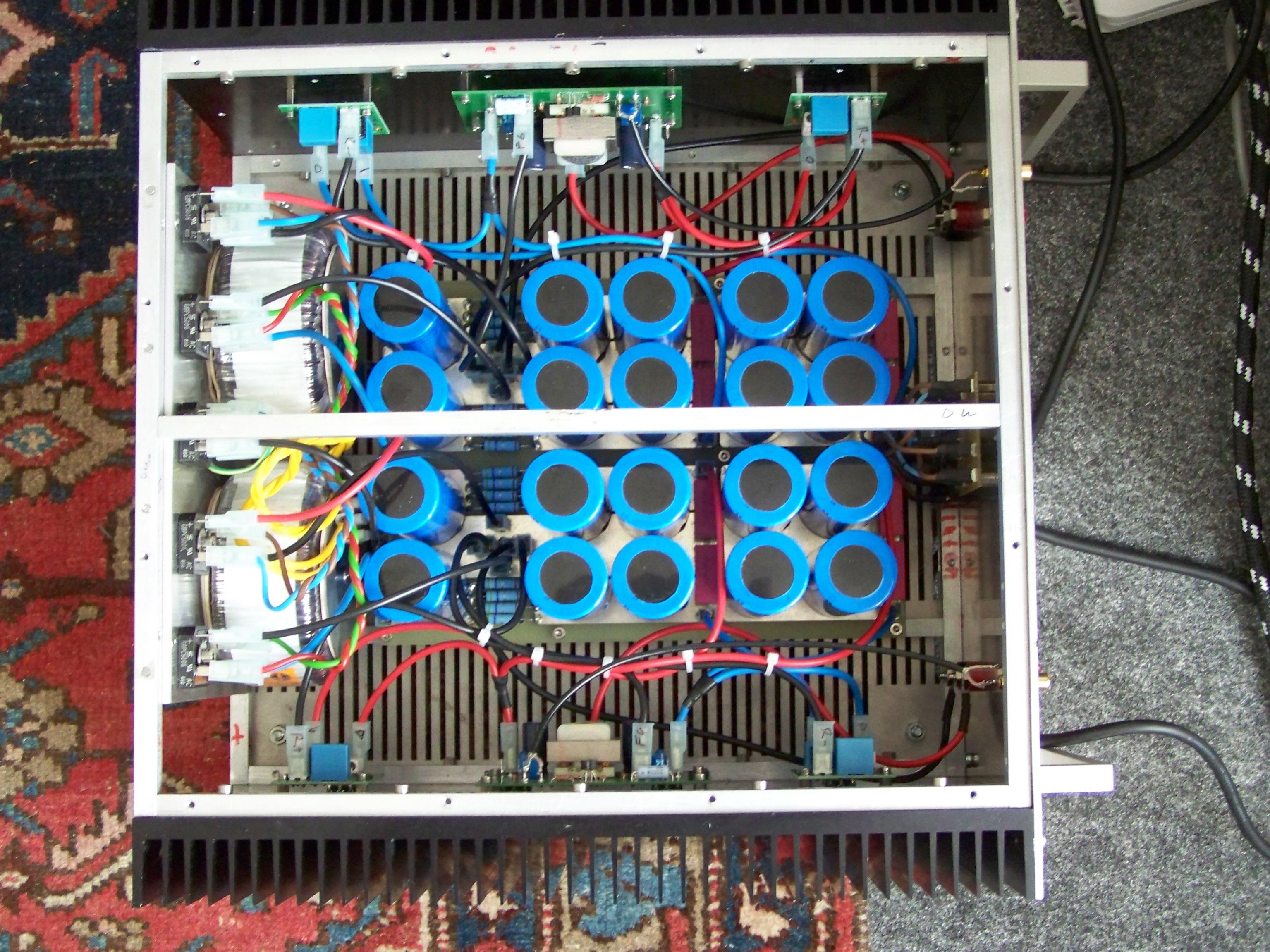

F6 Amplifier

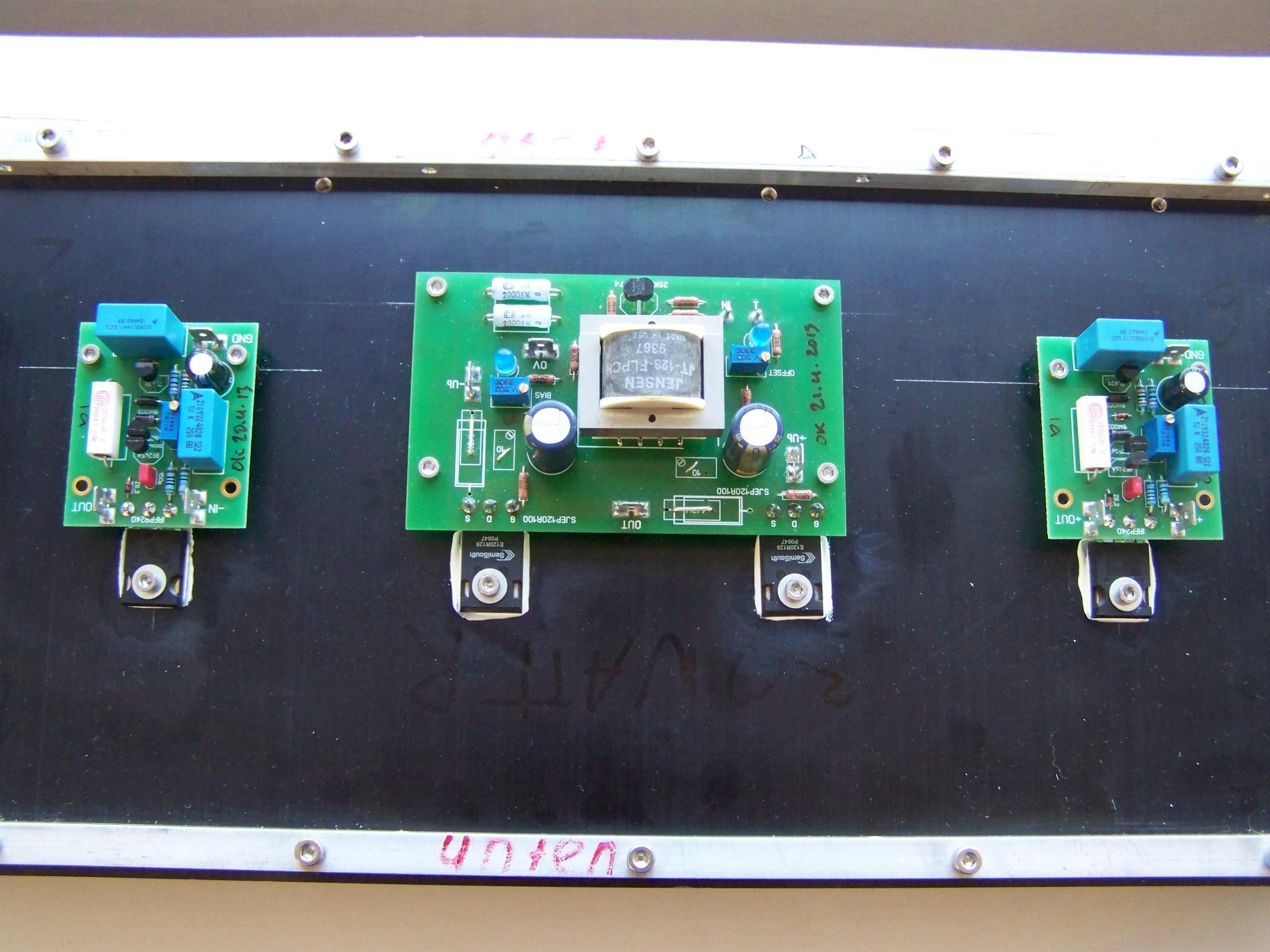

Just another F6 (and F5 in the background). Both have regulated power supplies.

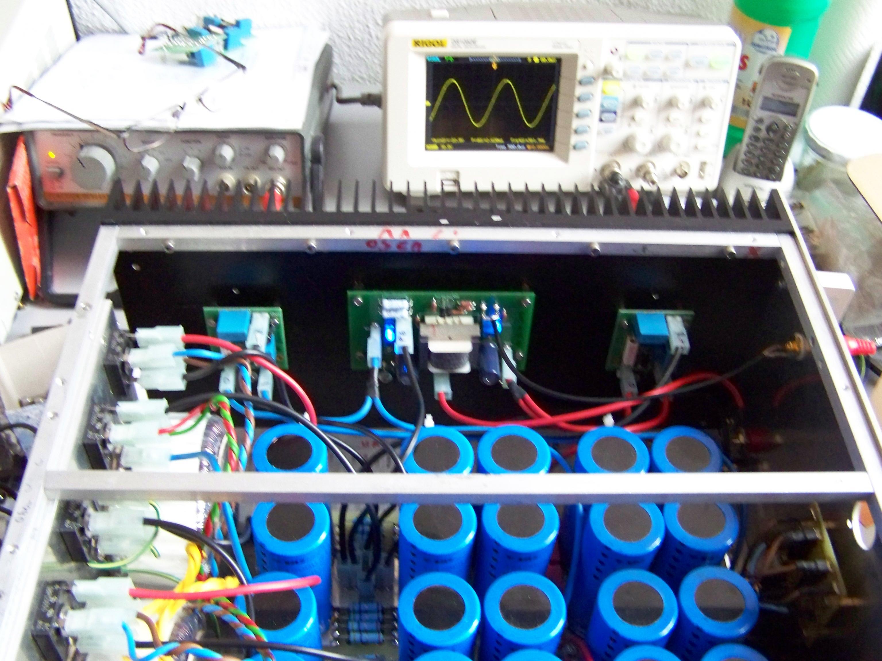

I am at the moment adjusting the bias on my build,so far so good!
I am setting it at 1,55A cause that is max what the potentiometer will let me to...But I think that is enough heat anyway almost to hot to touch.
I was thinking if I am going to trim the second hand harmonic with the soundcard in my laptop,will I have to connect a potentiometer inbetween
so that I can lower the signal?

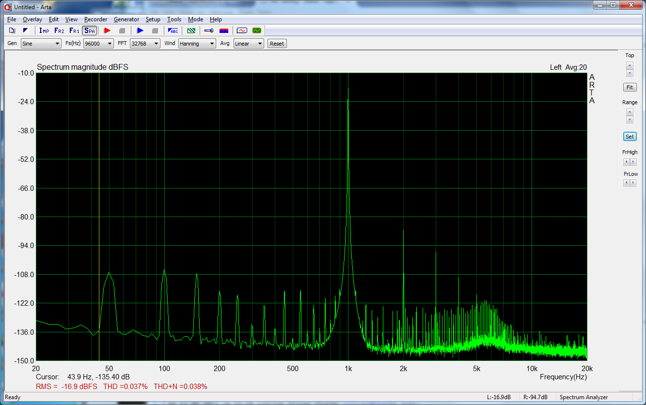

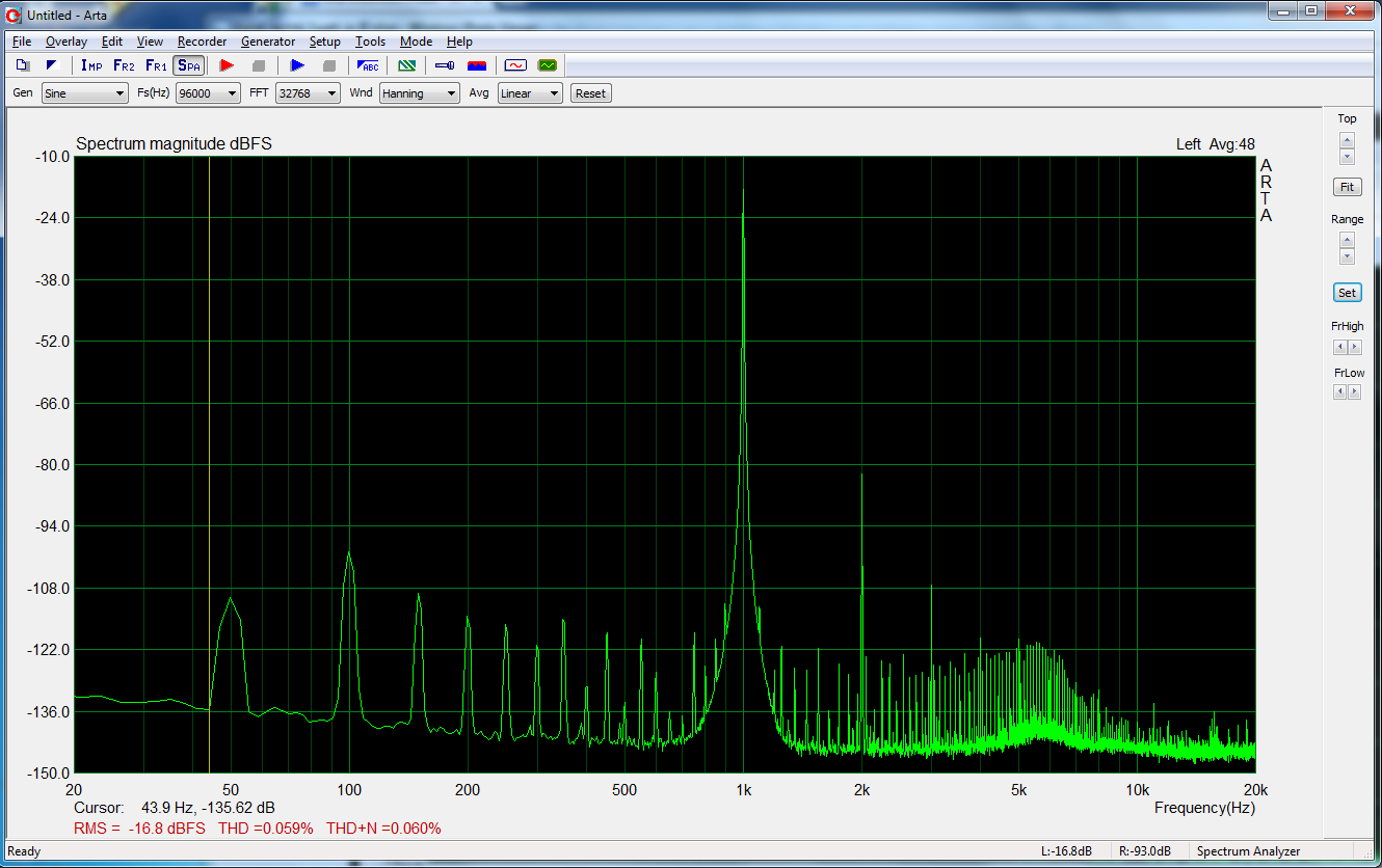

I would like to report some results of my F6 sound perception and it's dependency on matching quality of Semisouth transistors.
I build an F6 based on boards borrowed to me by Generg (Thanks !) -
I inserted SS R125, which I bought matched to around 1.3 Vgs at 1.5 Amp Id.
The F6 with this transistors sounded very very quiet (no noise), but also less detailed and kind of very boring. I thought that it is very dominant on 2nd harmonic, which was very noticeable.
I thought of course that this could not be the amp that was praised on 6moons and by others.....
First two images attached are THD measurements taken at 1 Watts (2.83 Volts @ 8 Ohm, 1 khz). Althought the transistors were bought 'matched' both channels left/right are very different. Also THD is extreme high, e.g. 0,059% on right channel !!l
Matched Semisouth LEFT Channel THD:
Matched Semisouth RIGHT CHannel THD:
Sound was kind of disappointing with above transistors, although bought matched.

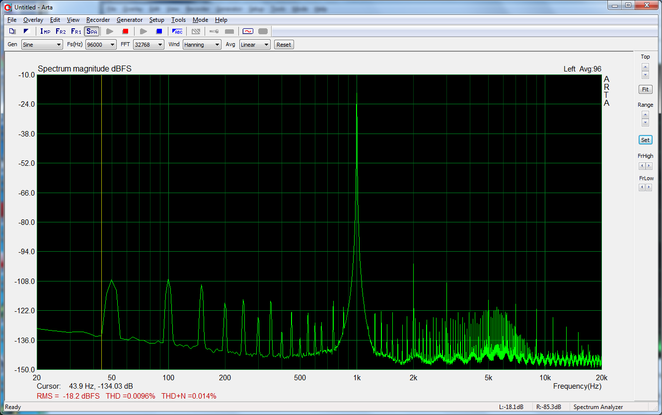

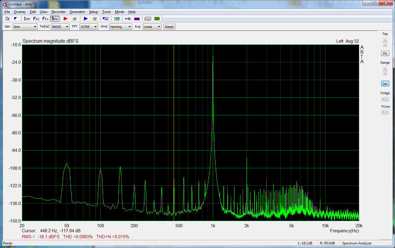

I did not have high hope on improvements, but tried curve-tracer matched Semisouth, also obtained from this forum.
WHAT A SURPRISE !
Suddenly the F6 had much more detail, well defined spatial definition of instruments and singers (ability to locate them on the virtual stage), and what was most impressing some kind of 'magic' to it, that draws your attention to the music. Instruments and singers were right in front of me. Last but not least I stopped analyzing, sat down and started to listen through my music collection.....
Later I did also an analysis on THD of this curve-tracer matched Semisouth, and was suprised to find: That both channels - left and right - had almost same - VERY LOW ! - THD figures and also very close 2nd /3rd harmonic relationship.
The sound - to my ears - was magical - reminding me on that magical sound I liked so much from the original J2 amp.
THD measurements of curve-tracer matched semisouth:
Left channel:
Right channel:
In Summary - I now know that also transistor matching quality has an impact on wether an amp sounds boring and less detailed or wether it sounds detailed and magical !
