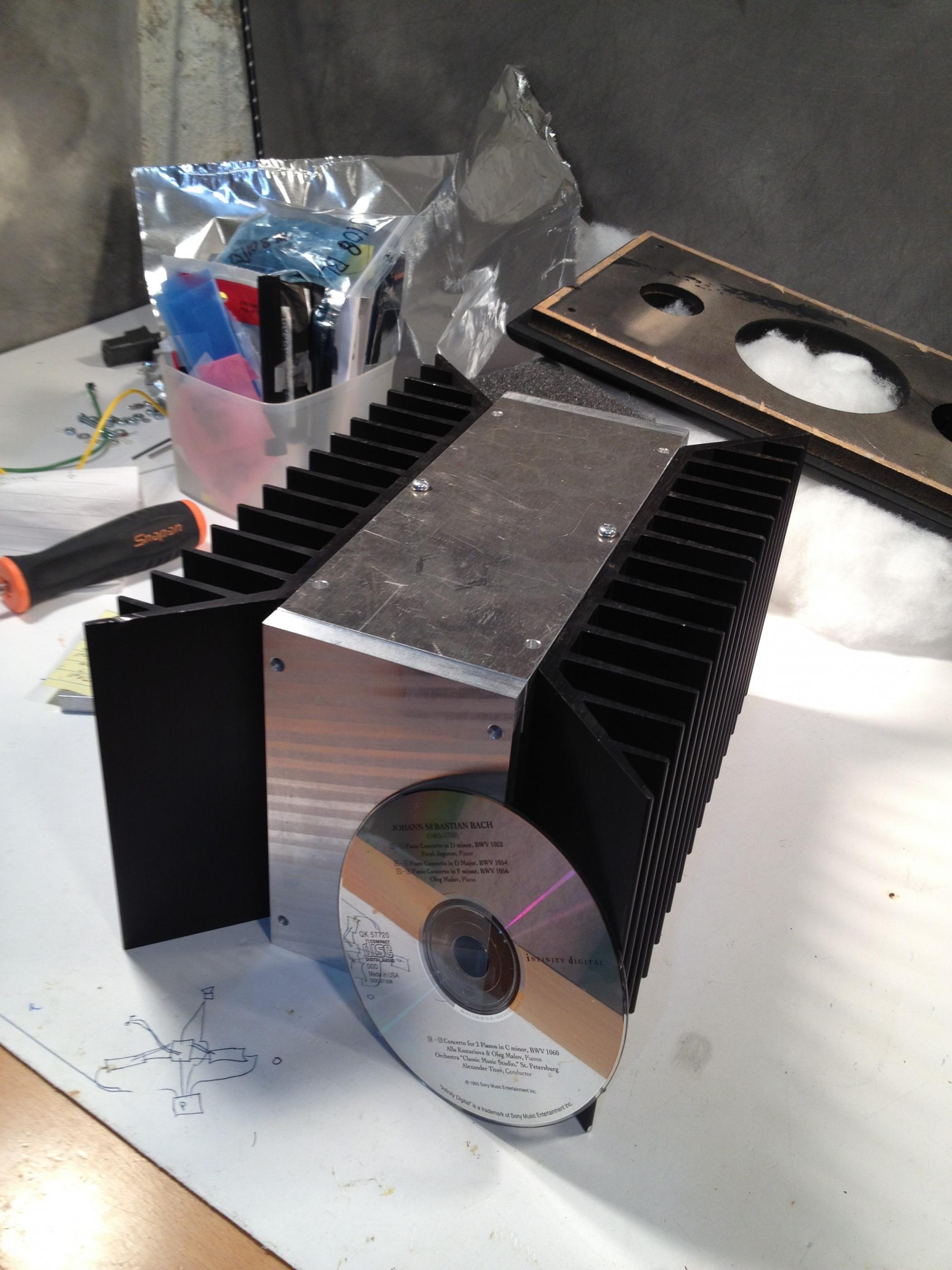

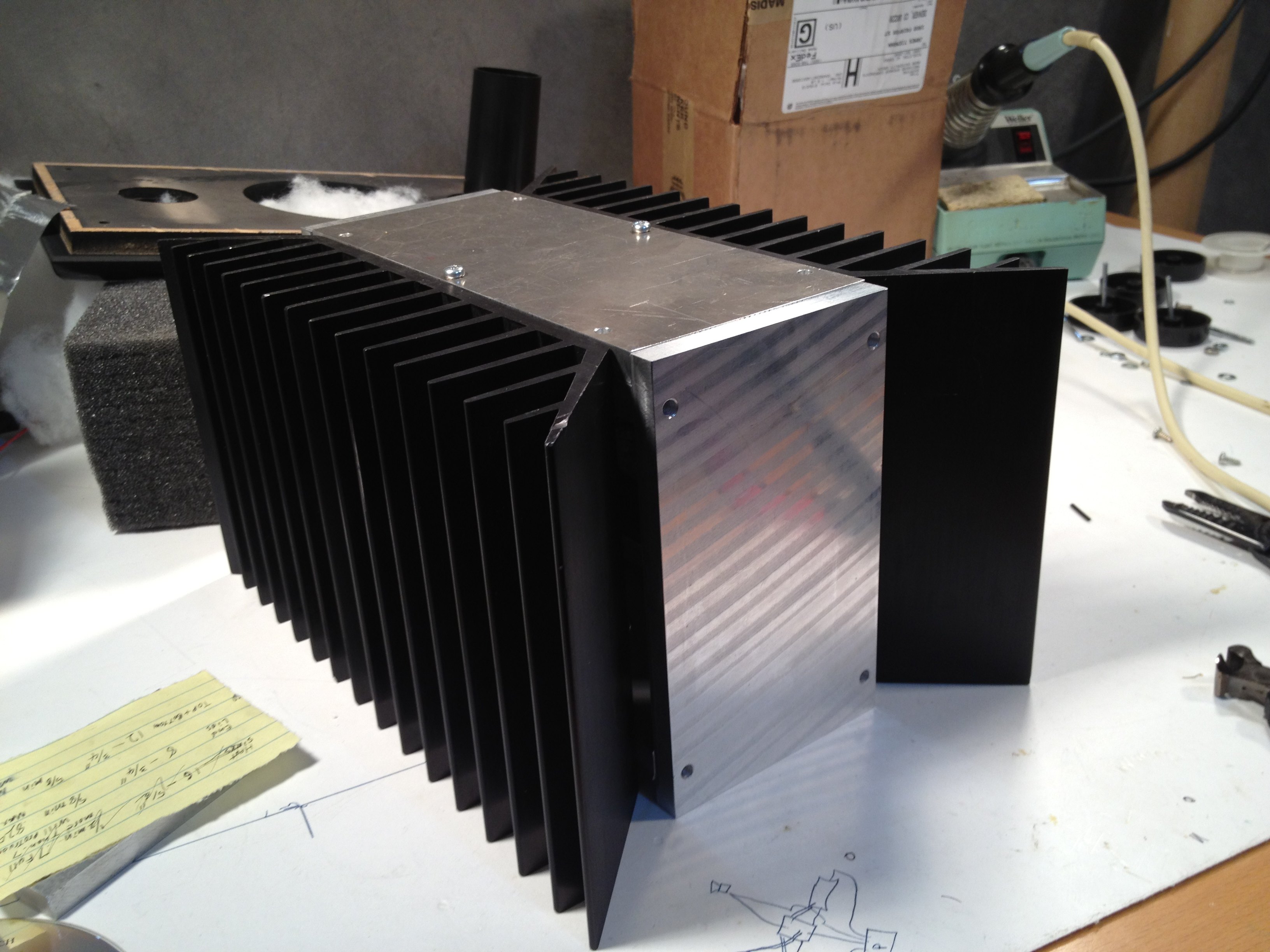

I finally got my F6 chassis from the machinist...
I'm not sure what finish I will have for the bare metal bits, I can polish it to very shiny, bead blast it and go for a clear anodize, or anodize black. The hardware will be black oxide.
attachment.php
attachment.php
Yes, the PSU will be separate. I haven't done that yet. It will likely be a small chassis from the store or something from Par-Metal.
