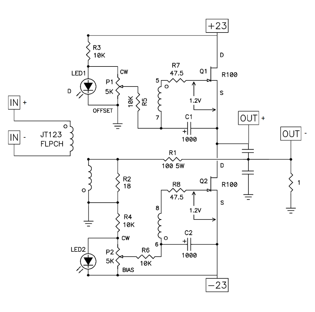

If you are looking to have a current source (high output impedance) amplifier,
then it would work. If I were doing that, I would say you can eliminate R2
and run the primaries in series from input to ground.
:cool:
Cool, Ideally I want a current source amp so that would work even better =)
Would it still have about the same high frequency rolloff as a vanilla F6 or would it be limited as if you remove the feedback in a vanilla F6?

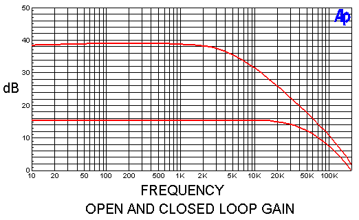

Here it is in GIF
Here it is in GIF
Yes, I remember that curve from further back in the thread. It was the main reason why I didn't pursue a current source F6 further then. If I'm not mistaken the reason for it is the transformer, which is what made me have som wishful thinking that it would be possible to easily bypass the transformer since then the feedback could be removed without penalizing the roll off.
Is there any easy ways to extend the bandwidth without adding feedback? I guess you could hook up some resistors and caps to lower the gain before the transformer to something more uniform. In that case then my guesstimate would be a passive line level 50 khz first order highpass shorted by a large resistor would do it.

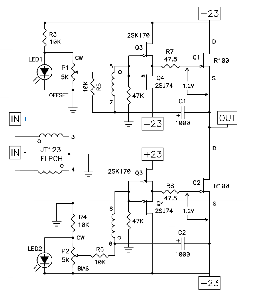

And disconnect the gate also?
And to further my quest for knowledge I will ask more questions =)
As you saw I just copied the buffer frontend and put it on each side but apparently life isn't that easy =) If the P-fets were removed would there be any issues with DC?
And another design that would be cool to try to build (if it would work that is ;) ) I've seen people use this design to create simple current source amps with chipamps and opamps and they discussed that it might be unstable but the F6 doesn't have that much gain so it might be less of an issue... so I might as well ask your opinion.
Thanks for all the help btw, I see fun amp building in the future...

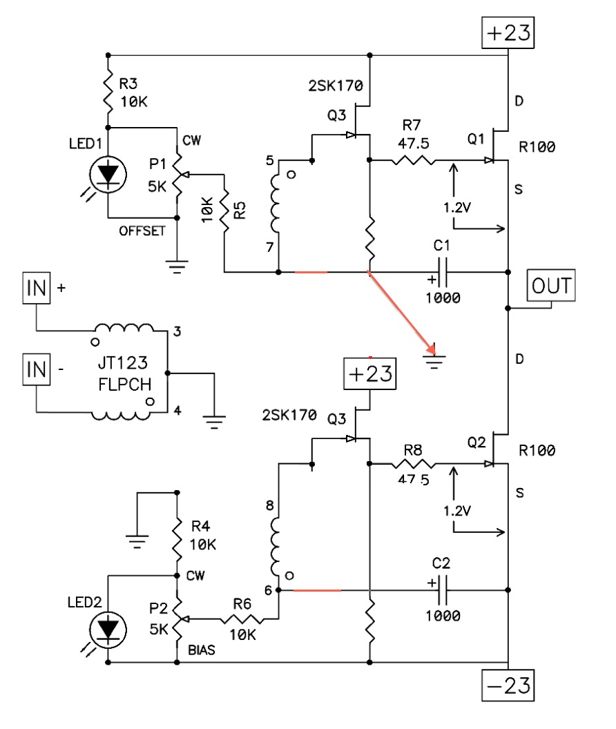

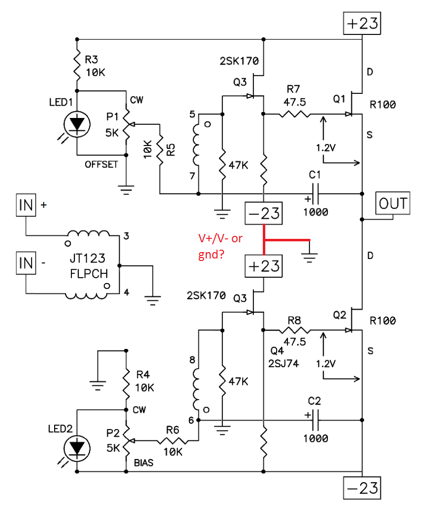

You are running in several direction. Wish you would settle down.
You have me interested in the buffer version.
Rush
