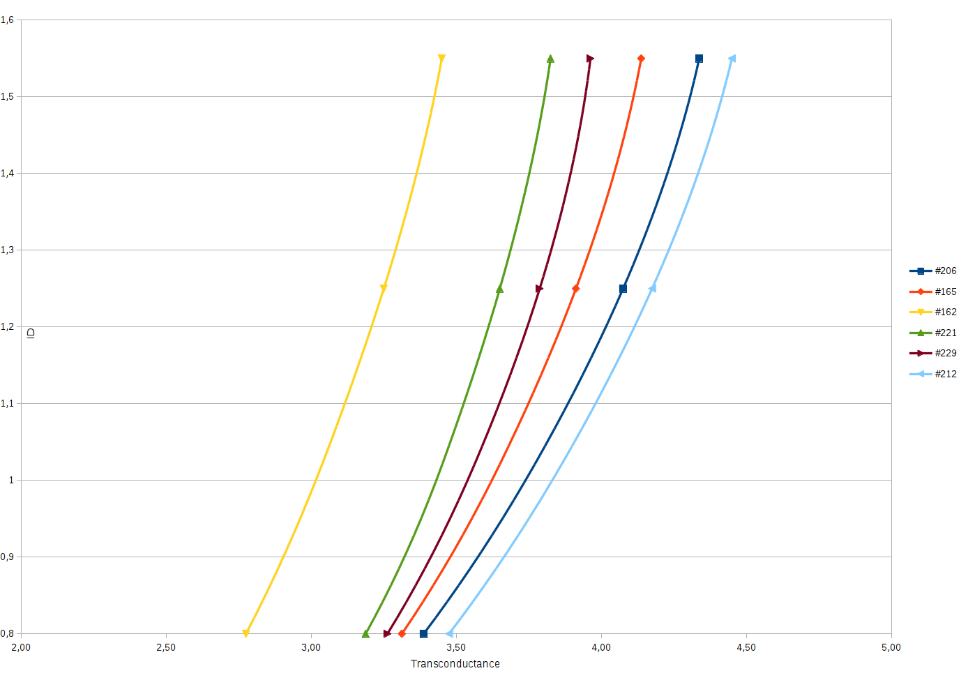

I think the curves look odd because of the measurement conditions.
As I have mounted the JFets on a heatsink, and not as EUVL suggested on a massive aluminium block (~3kg, ideally with OID controlled heating), the upper part of the curves are more "to the right": Here the heatsink is hot (but touchable, 50°C), so the JFets are needing more V_GS for the same Drain current. This is why in the reagion from roughly 1.4A till 2.0A the curves are flatter, moreto the right. Here the transconductance is lower as when the heatsinks and therefore the JFets would been at room temperature.
While I took the other datapoints, the heatsinks cooled down, even if just from max 55°C to 35°C, the curves there represent a higher transconductance. The JFets are cooler, so they need lesser V_GS for the same I_D.
As a conclusion, I would guess, that the curves should have all the same shape (more or less), but that the "distance" in V_GS shows their different behaviour.
For example, the shape of the curves of #229 and #206 are odd, but I have measurements where they look identical. But I used this datapoints, because the conditions for measurement have been the most equal.
Visual comparison
Here is a comparison.

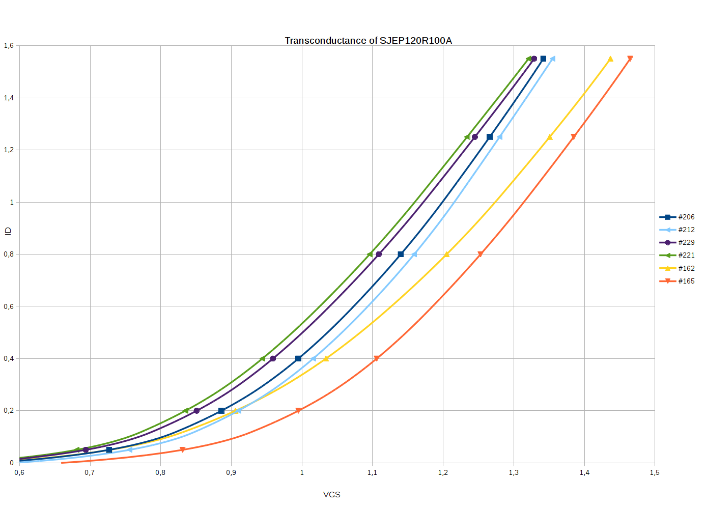

This is a follow-up post from #96.
As I measured my Power JFets 4 times but got a variation too big for my taste and also to use the measurements as basis for a conclusion, I scratched my head a long time wondering how I can do this better.
And, re-inventing the wheel, I stumbled once again over Nelson's article on how to match mosfets (the one with the testing rig).
As I don't own a signal generator as input device for the 0,1V 1kHz sinus, I used my soundcard for this. With audacity (opensource, very good) I created a 1kHz sinus wave, 10 mins, and saved this into a 24bit flac.
The rest is more or less a free interpretation of Nelson's circuit. Thank god I had a 8ohm 300watt resistor, this came in handy! :D
So, attached you find 2 pictures, the first showing the transconductance in the usual way (ID over VGS), the second one the transconductance calculated with the formula in Nelson's article, over ID. Here you can see very nicely the variating shape of the transconductance, if current is variated.
Ah, and the measurements were taken with V_DS=22V, all the same room temperature (it has been very cold here in Sao Paulo, just 16°C outsides).
So, I decided to choose #229 and #221, and for the other channel #212 and #206. They have a similar curve shape and also are behaving more or less equal, if you compare the matches.
If I'm taken the "wrong" sets, please correct me, I'm here to learn and pleased for a different opinion. If I did everything as you would have also done, then I'm happy to hear this also!
