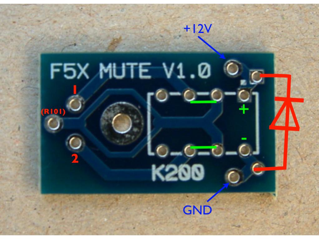

correct configuration of the mute board
Of course Dave and Patrick are wright so here is the correct (and tested) configuration of the mute board. I misread the relay data sheet and got the coil polarity wrong (topside view for through-hole versions and bottom view for surface mount versions)
I also succeeded in getting the polarity of the diode wrong...... Nothing serious happens: a tiny bit of smoke and a short
That is why you should not follow my example

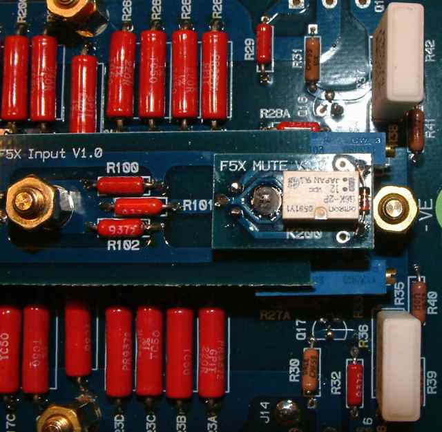

Hi Nic, would you post a picture of your mute board?
Just poor lightening in my photo. They are the "ordinary" GB PRP's. I think the leads (non-magnetic) are tinned copper.Nic, your 220R resistors have copper connecting leads? The color in the photos looks like copper.
Just joking......
These are fakes that I picked up on the way
Perfect for practicing
Back to business: from what I can see/measure the inner set of holes on the PCB will make the best fit (or bending will have to exceed 90˚)
Nic

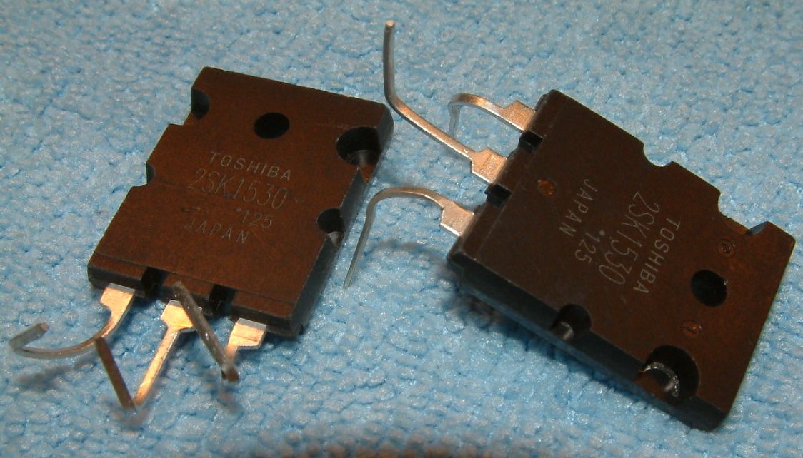

hello. where do you get sj201/sk1530?
i've found some at salon. but i don't know if they may be fakes.
