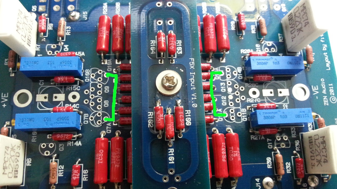

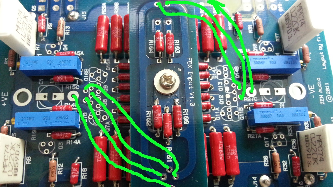

Connections
I have a few questions :
1) The BOM for the 'Mute' board states that there is one BAW 76 diode. Where do I solder this on? Please refer image 'Mute'.
2) For the input board connection to the main board, I will need to solder the joints as indicated in image 'input connection'. Are these connections correct?
3) As for the jumpers between Q7A and Q10A and Q11A and 14A, again please refer to the image 'jumper', is this correct?
4) What are the uses of these holes on the boards? Please refer to image 'holes'. I have soldered the source resistor without elevating them and so I was thinking of drilling a parallel holes beside these. Then I will connect a wire under the board from these holes to the source resistors so I would take measurement from there. if not, what other possible way to measure these resistors?

1) BAW76 goes to the RHS of the relay as in your photo. The cathode should face the positive side of the relay (i.e. diode normally off).
2) Yes, except that there are only 6 connections between the two boards. The one next to R10 is not connected to the main board.
3) Not correct. Please refer to Dave's instructions and schematics again. You can also see from your "holes" photo which 2 holes per Q7B and Q10B and Q11B and 14B have solder.
4) They are spare holes which have no use for you. You need to lift the power resistors off the PCB (at least 2~3mm), else your PCB will not last very long.
Hope this helps,
Patrick

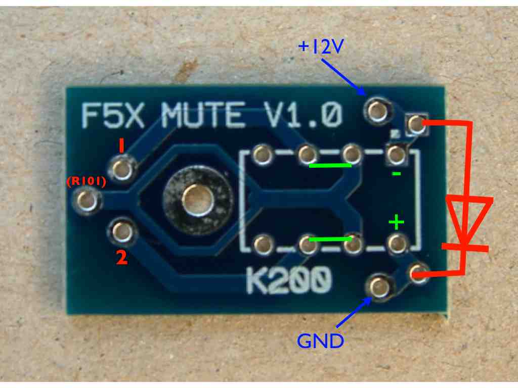

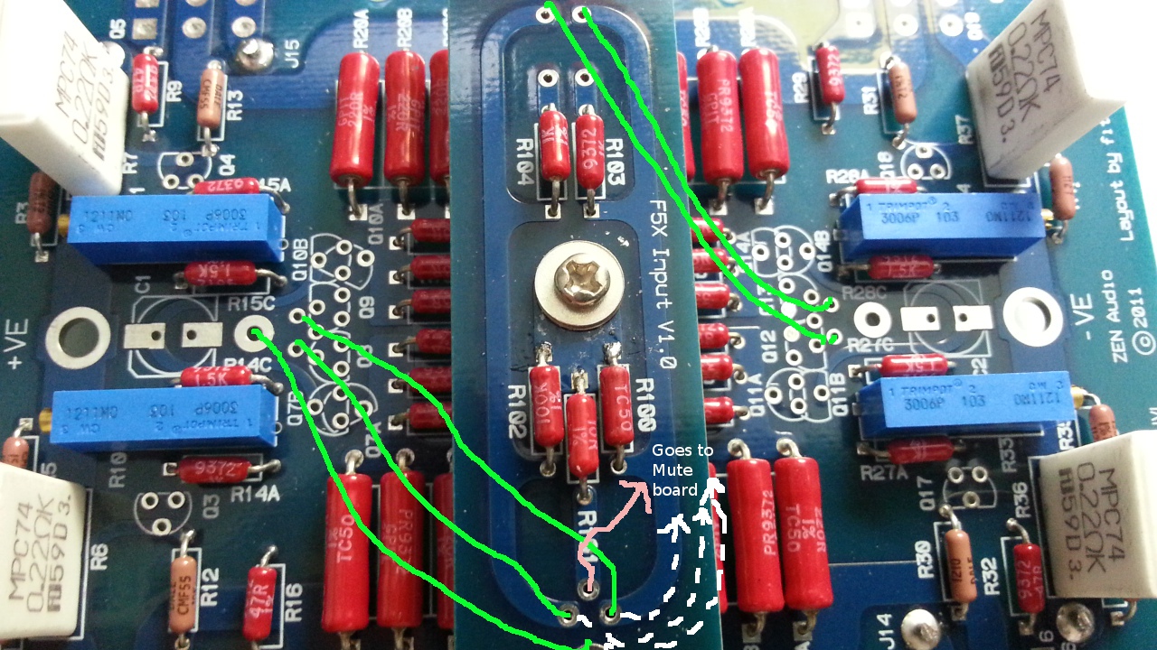

1)Which side is the RHS? Is image 'Mute 1' or 'Mute 2'?
2)Please refer to image 'connection to Mute'. Is this connection correct? Do the other holes connect to the Mute board as well as indicated by the dotted lines?

1) None of the above. The diode is soldered electrically in parallel with the relay coil with the cathode to the positive side of the relay coil.
Please kindly read the datasheet of the relay to find out which pins are for the coil, and which is positive.
2) The connection to the Mute board is correct. 4 connections altogether. I do not have these boards, as they are Dave's layout. So he should confirm.
There is also one green line missing going from the input board to the RHS of your picture.
So 6 connections altogether between main & input board.
Dave please cross check.
Patrick
Joined 2009
Mute PCB
My (limited) understanding:
Connections to input PCB in red.
Relay data sheet indications in green.
Connections to control board in blue.
When the relay is unpowered (green lines) the amp inputs (1, 2) are grounded via a 10R resistor (R101) on the input PCB.
