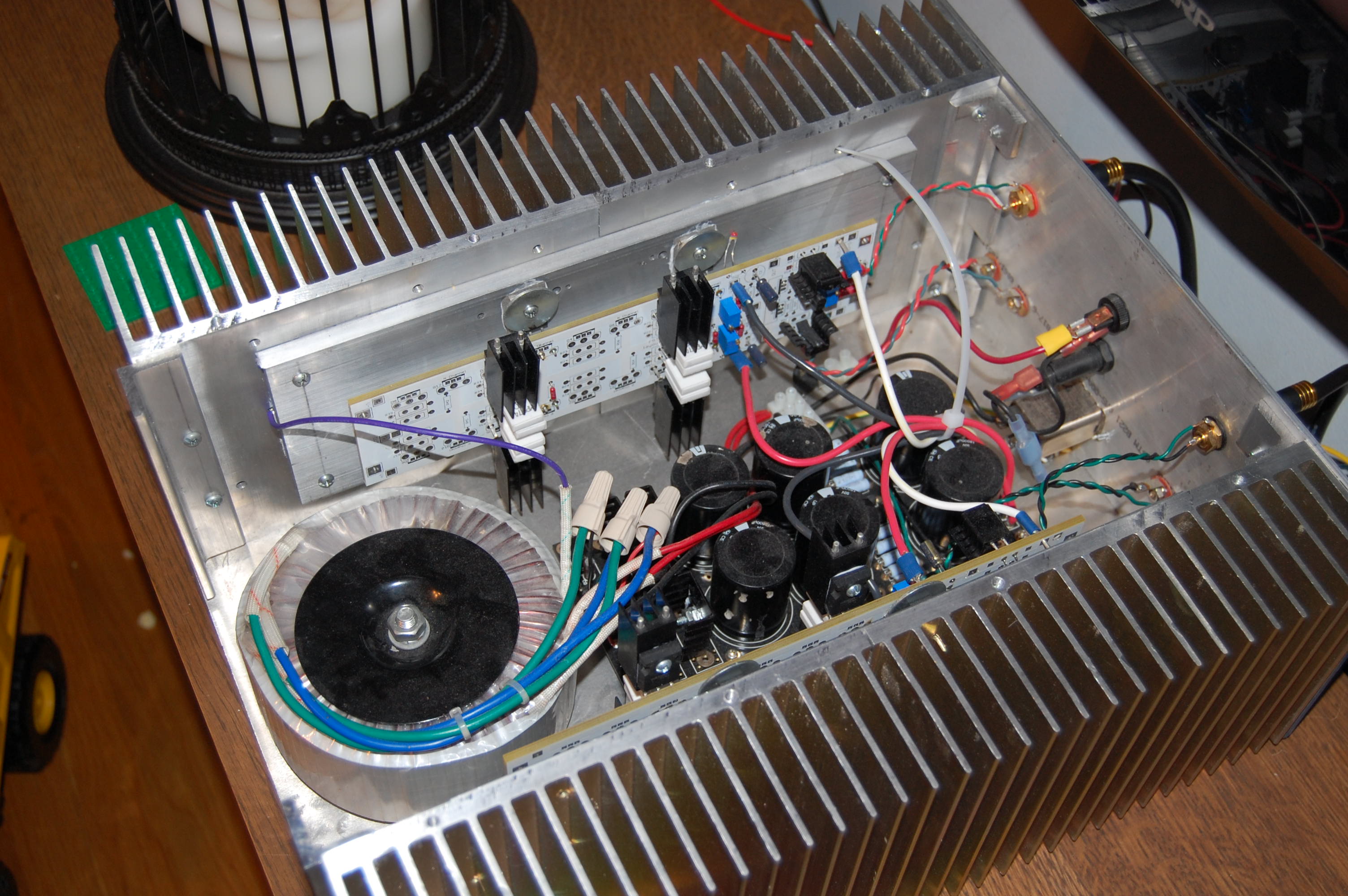

Maybe it's a question for the build thread but modushop is offering a 5U case with a depth of 500mm (that is, 100mm more than the standard one). Would that be suitable for a F5T V3 or is it still recommended with a pair of mono blocks? I'm mostly concerned that the heat sinks won't be large enough.
It's a lot of heat. I would be hesitant to recommend it for anything other than monoblocks. Wih stereo version, you have 8 fets on a single sink. You could back off the current some, setting bias at 300mV across Rs and maybe be OK. I really need to finish my V3 using TeaBags board to come up with some numbers. Lets see what I can do this weekend and I will let yo know.
Perfect, thanks!
backefel,
Here is a pic of my current V2. It is on side by side Heastink USA 10.08 profile that is 6" tall and 16" deep. The fins are longer, but not anodized black. I would have no problem putting the V3 on this setup, but it would be pushing it a bit, especially considering it is not enclosed. With a well vented bottom and top, i think it would be ok. Put it all on a granite shelf with a 120mm fan mounted in the center and you are set. Truthfully, mounting fets directly to sinks would help somewhat, as the spreader causes efficiency loss. Just a bit of reference.
