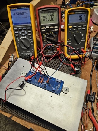

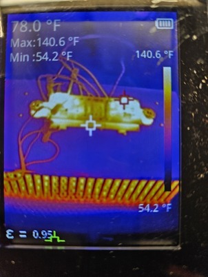

Well, Power up and initial biasing went according to plan and is now sitting at just over an amp. I'll bump it up in steps to ~1.4A and see what the temps look like. I picked up a thermal camera last year to help locate faults and failing connections in marine DC systems and it came to mind during power up. The hottest point on board appears to be the 0R47 source resistors (red crosshairs) which easily pass the touch test. Time to hook up a test speaker and populate the second channel (y)

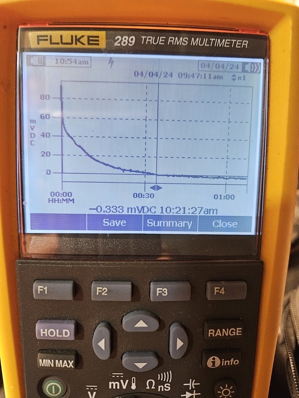

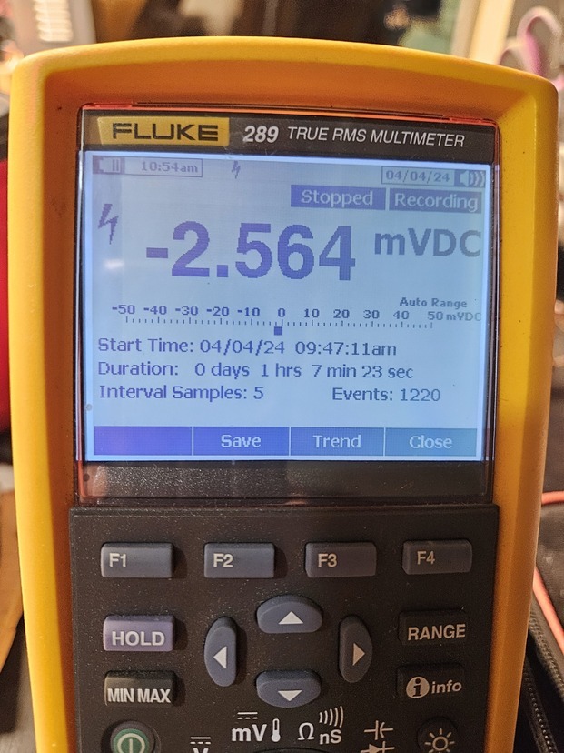

Channel #2 setup yesterday went well. Mounted to a 6" section of heatsinks USA 10.080" profile with the std 24V supply and bias set
at ~1.3A.
I logged the offset voltage for just over an hour from a cold start and it looks good. I'll power up both channels today to dial them in and start thinking about a case. The hobby budget took a big hit yesterday (our adopted rescue Saint needs significant dental work) and that forces a decision at this point. The higher WAF and ease of a bought case or something put together in the shop that's likely to be a little rough around the edges but allows the purchase of an inexpensive scope? Try not to laugh when I post up pics of a toaster oven with heatsinks ... cheers

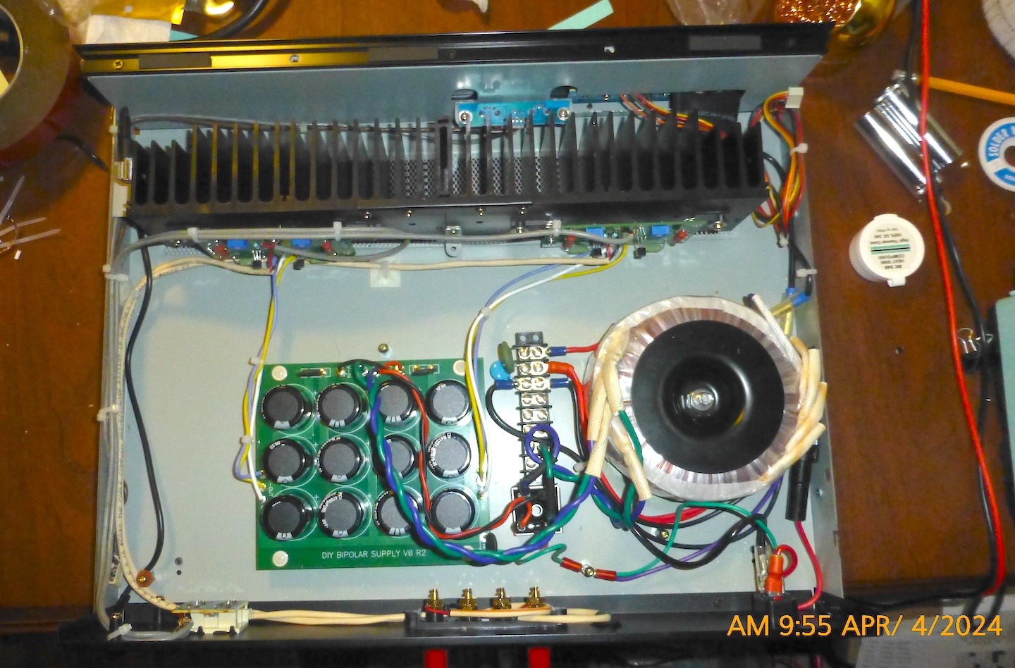

While I had it open again, I took some of the suggestions made by @Ben Mah (post #1055) to move some items around to minimize potential noise from the AC circuitry (see photo below):
— rotated the transformer 90° CCW
— moved the bridge rectifier to the other side of terminal strip (further from amp PCBs)
— moved the PS PCB a bit further from the amp PCBs
I also attached a temperature sensor to the end of the heatsink (left in the photo below). This is part of a thermal trigger for the fans. This way, I don’t have to remember to turn the fans on or off, as I have them powered external to the F5m chassis.
