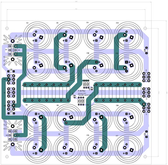

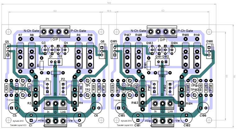

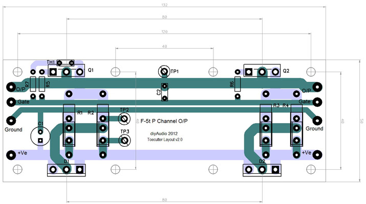

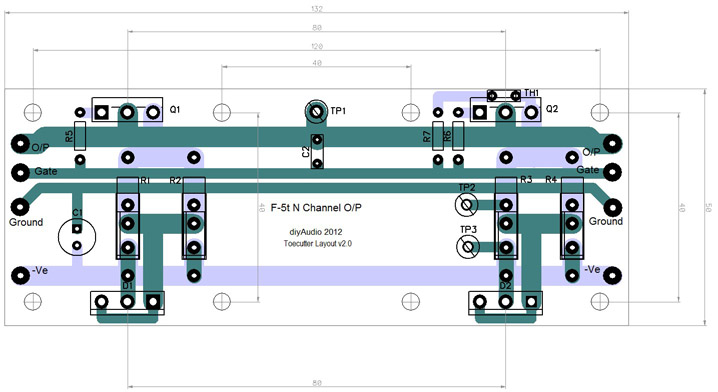

Ok, I'll post the proposed final designs here because at some point corrections were made. Melon Head, would be very grateful if you'd look them over, then we can send them off to the PCB fab.

First off, I was just referring to the template for the hole positions on the heatsing
This is exactly the way I like it. I have not checked the fine details but generally speaking, I like separating the front end pcb from the output, that way if people say "I want more mosfets at the output" you don't have to redesign a whole new pcb, you just design bigger output boards.
Ideally the front end should contain everything so that someone can go absolutely nuts with it.
First impression is very good.
I will check it against circuit diagram.

We don't even have to design bigger output boards. Two output boards will bolt onto each heatsink on our big chassis and you can just daisy chain two boards together on each side to make a monster monoblock. If you want an n and p on each side for 2 channel that will bolt in place too.
The medium chassis only accommodates one board per side. Because it doesn't make sense to make a two channel F-5t in the medium chassis.
But again, you can put a "p" on one side and and "n" on the other to make a monoblock F-5t
Yes, I noticed that. Very well thought out.
I also like that you have put N and P channel on separate boards.
It would be nice if you were to also do this for BA2 output. Or you could make these output boards compatible for both F5T and BA2, and just populate the relevant components. It would also reduce manufacturing costs.
I don't see where you connect the speaker wire. You supposed to double up the O/P connectors on the input boards?:confused:
Rush
Forget my previous post, while you could do that, I don't think that is ideal.
Probably should have 3 output holes on the front end board:
One for N Channel, One for P Channel, and the 3rd for speaker output.
I really hate to say this, but I don't like the output so close to the input jfets.
This is one thing I remember Nelson saying should be avoided.
I am not sure how close is too close though
A couple of minor suggestions, the output boards, how about moving C1 to the center of the PCB and making as large as possible for maximum decoupling, then beef up the ground track.
A nice touch but probably un-necessary would be if EUVL made some of those natty little heatsinks to thermally couple the JFET's.
I am in the process of building F5 turbo v2. What is the transformer spec I should look for ?
I figured out to be 30VAC -0- -30VAC instead of the 1st version 18V-0-18Vac . I used the calculation from Mr Pass old thread in power supply , which is +/- ( RAIL 8+4 ) /1.4 for rail = + - 32 VDC.
