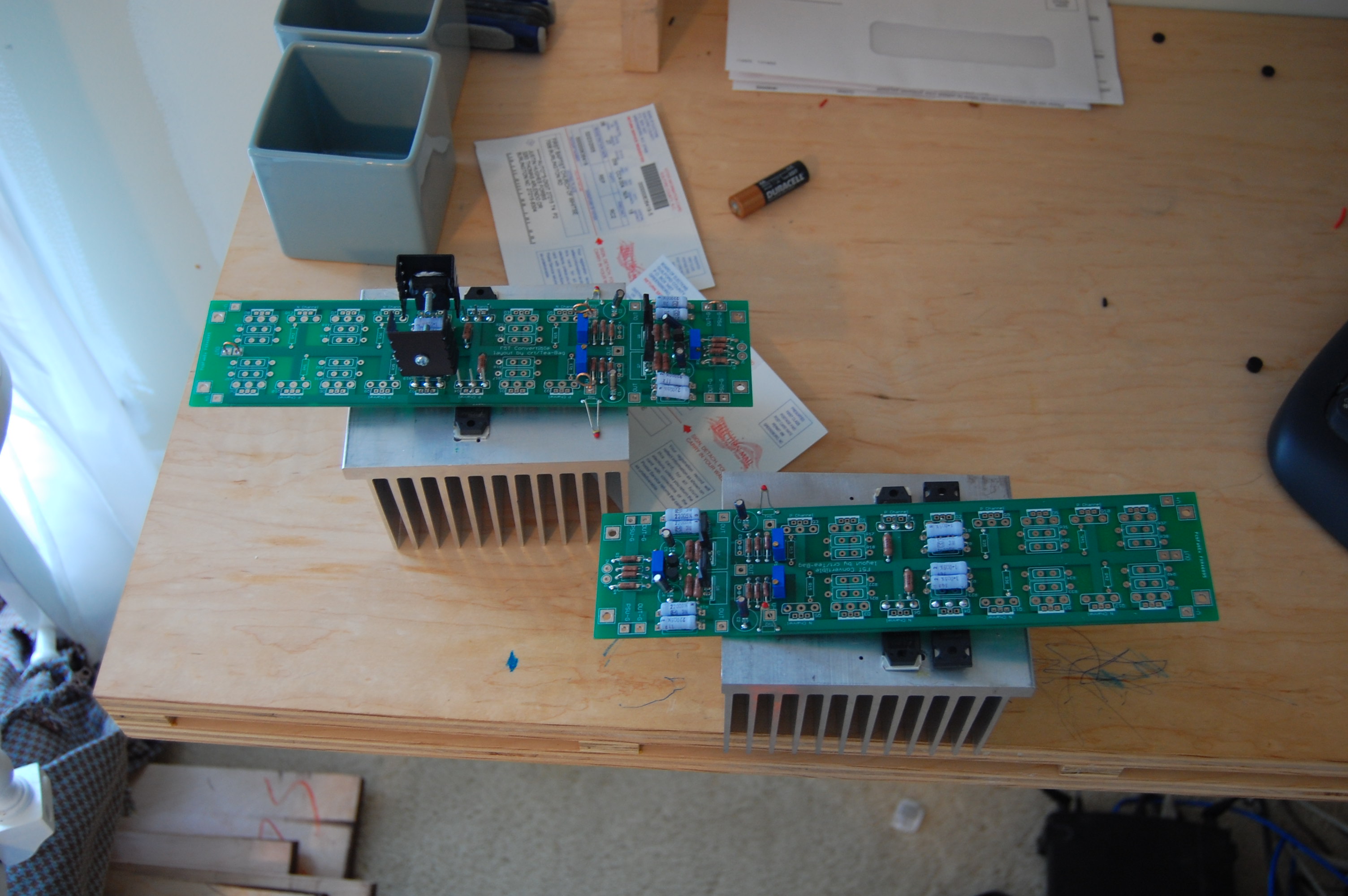

I hope to spend more time getting mini V3 version with mini-Diode heatsinks, and the V2 version with direct attached diodes to heatsinks in comparison. Going to use some low hz sine wave loops from old test disk to see what results. That's the plan anyway. The wife suddenly wants to change all that.

Here is how I am going to test them. I amusing small sinks intentionally, so that i can make sure the heat is high. One will have diodes mounted to sink, the other freestanding. I will drive parallel 4 ohm speakers to give it a nice tough load. If it gets too hot, I'll put them on larger sinks.
