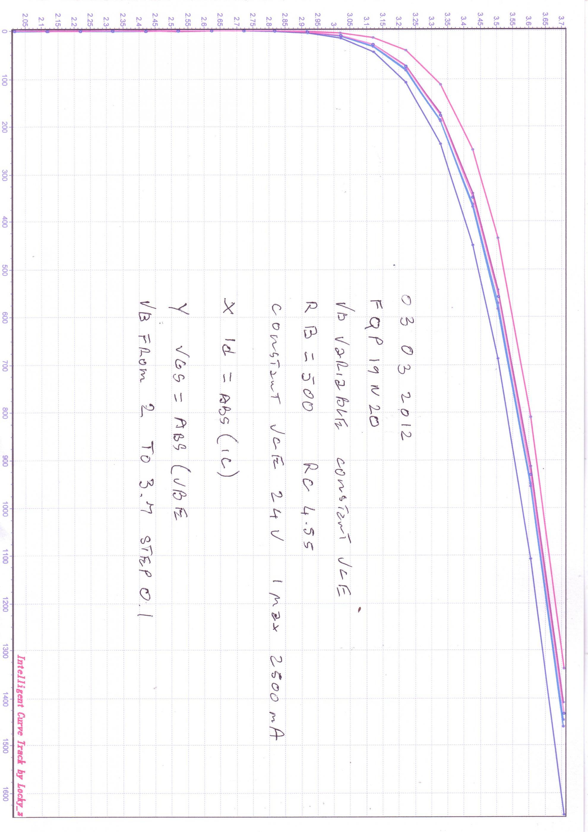

Same curves for the TO220 FQP19N20
The FQA12P20 need about 5.5 V

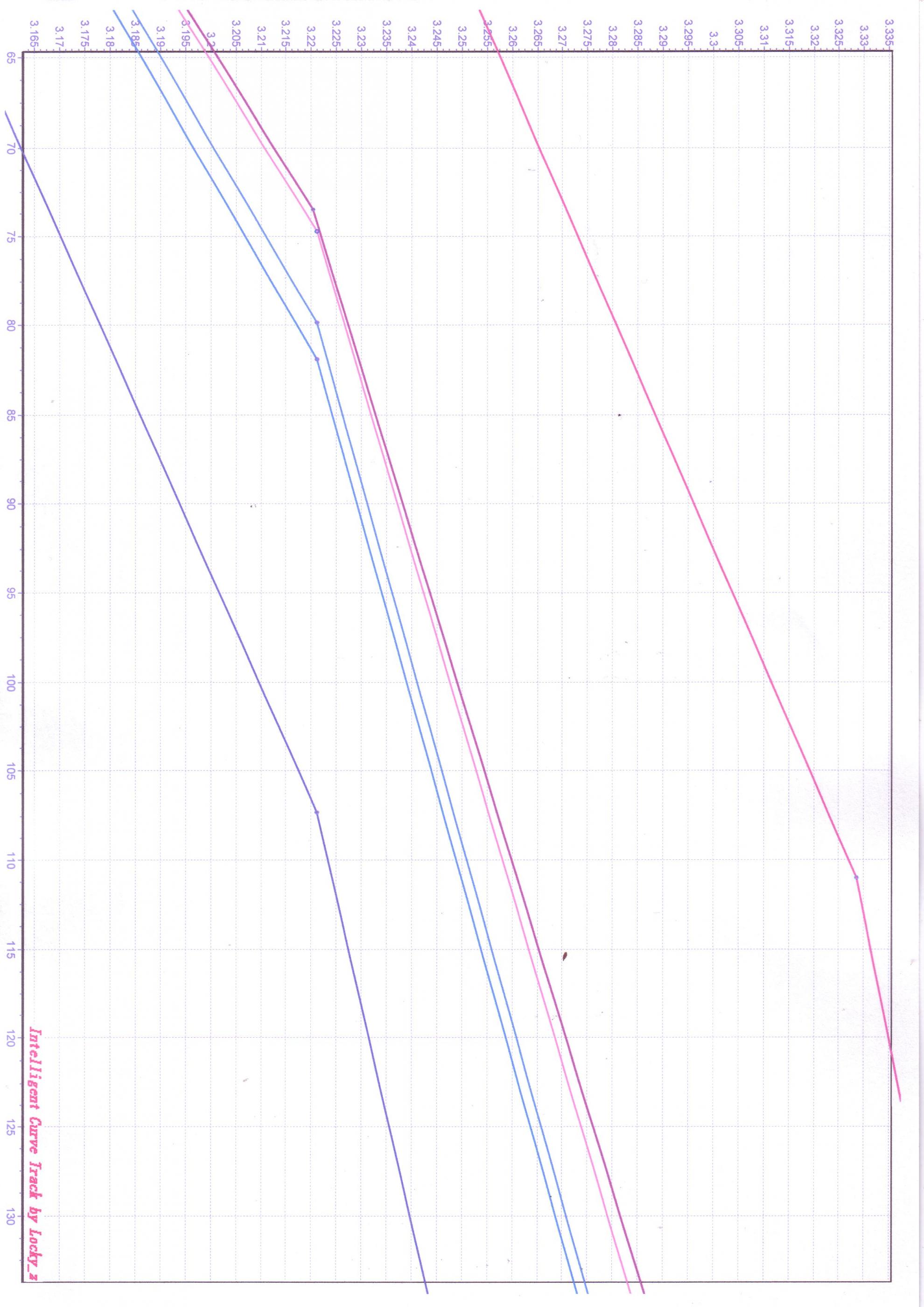

In the zoomed in 2 controll top and botom and a couple of pairs
I use to match them at 24 V 2A and constant themperature 50C
Tea Bag Could I have same please?
