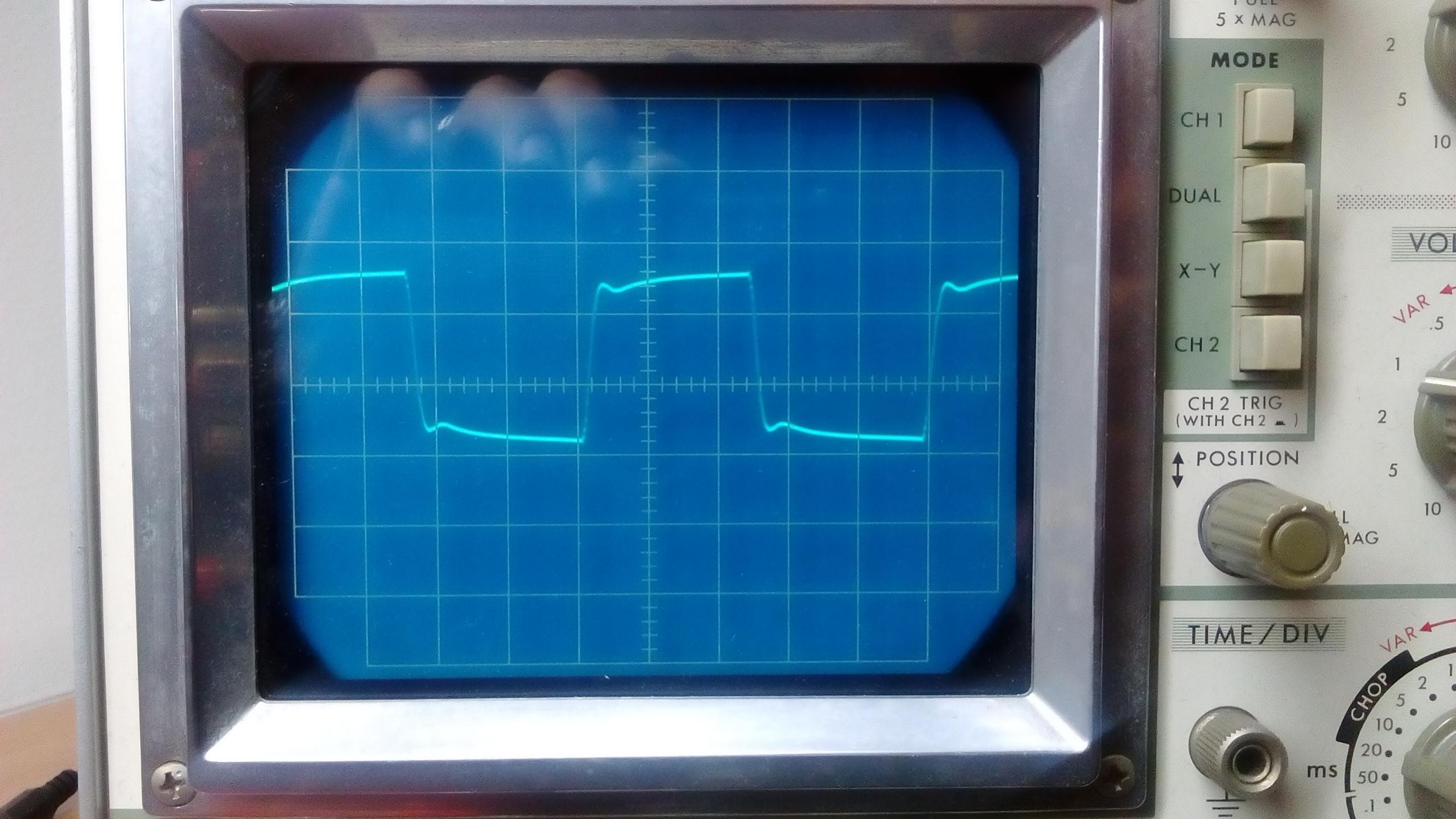

For the second time my f5 v2 turbo burned!
I have noticed you that this happened because I connected at the input a tube preamp of my friend that unfortunately at turned off and on pulled out 144Vdc.
My F5 burned after a few seconds!
I must tell you that I thought that inserting in parallel to R2 47,5K two zener diodes connected in anti-series would have kept away of risk my amp but this did not happen unfortunately.
Now I must also tell you that by controlling which components are burned, I found that only the Power MOSFETs are burned.
It 'strange to find that both the protection diodes in the input ad also the FET 2SK170 / 2sj74 are safe, I expected to find them burned.
I would think that as an additional protection I would insert a capacitor input immediately after R1 1K as done by Nelson Pass Aleph series.
What do you think about that?
I know that in some way could deteriorate signal ...
But since I am now also sostiuendo the IRFP9240 / IRFP240 with the most beautiful and expensive ECW20N20Z / ECW20P20Z, I would not want to risk burning them in again.
Do you have any advice on the input capacitor to be taken?

Hi Alex thanks for your reply!
I have to update you,today i have just replaced old mosfet with ECW20N20Z / ECW20P20Z,and the amp nont work correctly
It distorts and often intervenes speaker protection, what bad luck!
Yet somepeople had guaranteed that with exception of different physical dimensions and the inversion of pin Drain and Source, it would have played!
Is possible can do something?
Also if you should use a 10uF why not use a polyester 400V type?
Could you tell me where insert it exactly in circuit?
Before or after R1 1k input resistor?

You think so that is a solution to be adopted in the version V2 or you can avoid if the test of the square wave is ok?
Thanks in advance

check every mosfet Iq , measuring voltage across (each!) source resistor
safety cap - I said - use whatever you think is good for your ears , value not critical (but no less than I said)
if square test is OK and you can't see any oscillation in MHz range , no need for lag caps
however - check all needed (current through input JFets also ) then write back
after 170V-ish adventure , I would replace input JFets ; as all semis , JFets can easily became fatally depressive , remembering stress from the past ..... :bawling:
Just replaced again with irf mosfet type and now work fine.
What do you think about 100khz square wave test?
Do i need to add feedback caps or no?
