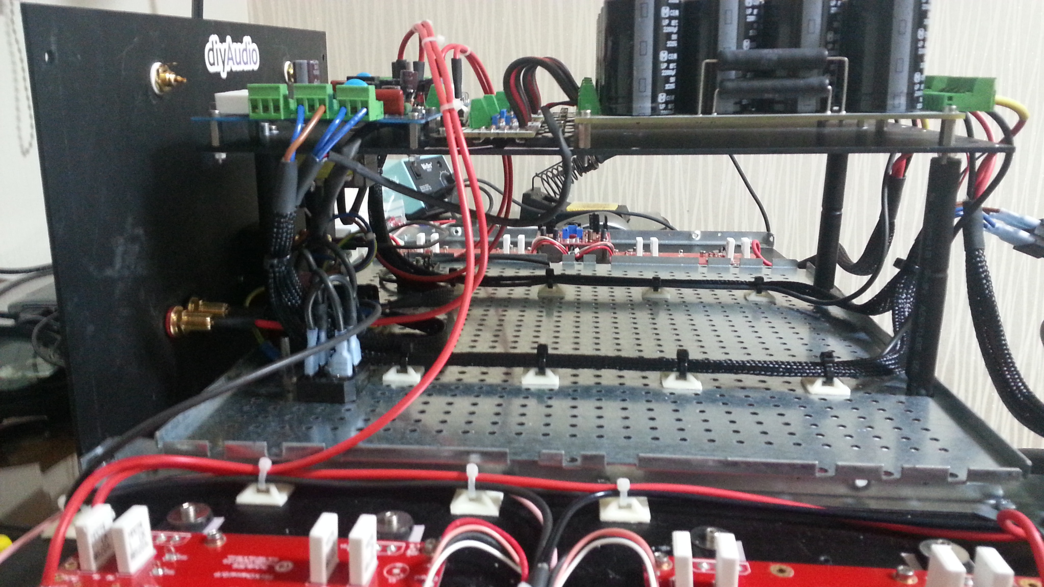

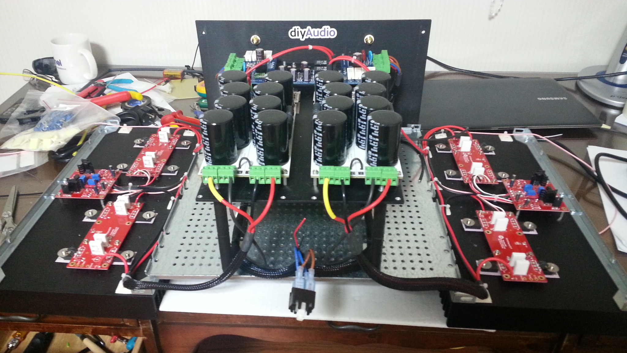

F5T V2.... almost ready
I am almost ready to power on my F5T.
Missing very few thinks... the hole in the front panel (22 mm... not easy), 1 CL60 that I can't find here and the 2 trafos (buuuuzz... ).
Now I am really nervous thinking to the first power on and the bias... I will sure back to some help!
Many thanks everyone that partecipate to this amazing project.... to Buzz for the GB, TeaBag, Patrick and 6L6 for the supports given me time to time. And offcourse NP
Ciao
Enrico

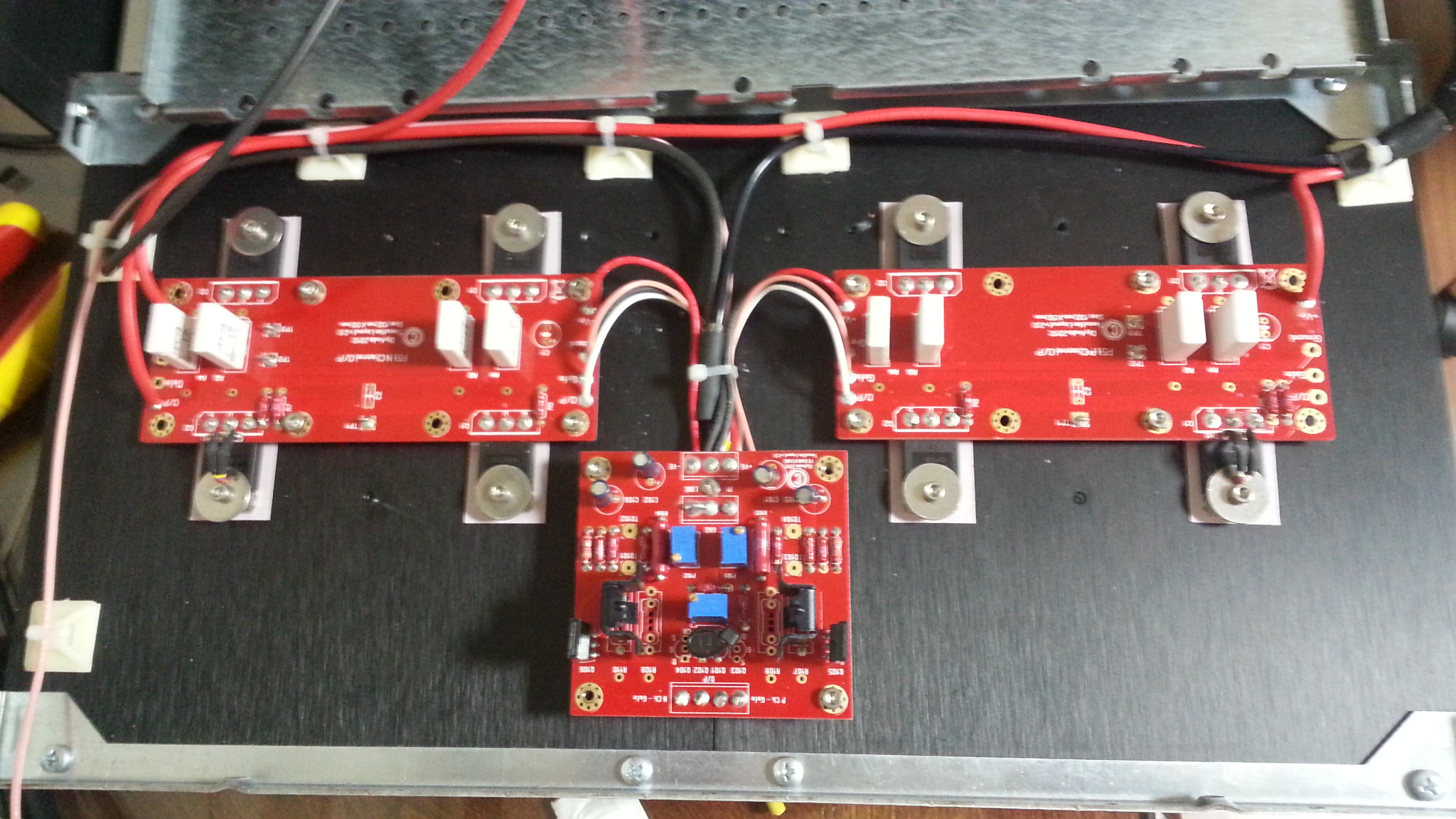

Little update
As I say I already test the 2 PSU that give me 15.6 V. So.... I can' t wait and today I give power to the amplifier and look like so far everything is working well.
I have only 2 meters that I use for test the bias regolation. The pots are working and nothing is smoking. I can reach 600 mV before the PSU seat down. The heatshink get a little warm.
What I notice is that increasing the pots of one side increase also the other side and I suppose that is normal.
Having only 2 meters I check time to time the offset that is quite high... maximum that I read is 438 mV. With the third meter and the correct PSU I will bias properly
I know that is not the correct test to do but now I know that is working and I am more quiet.
Enrico
That's normal.
If you have two meters like me, I used one meter for the offset and one to measure the voltage over one of the source resistors.
Then turn up the bias with one pot, offset increases, and turn offset to zero with the other pot... and so on... slowly, slowly, slowly
